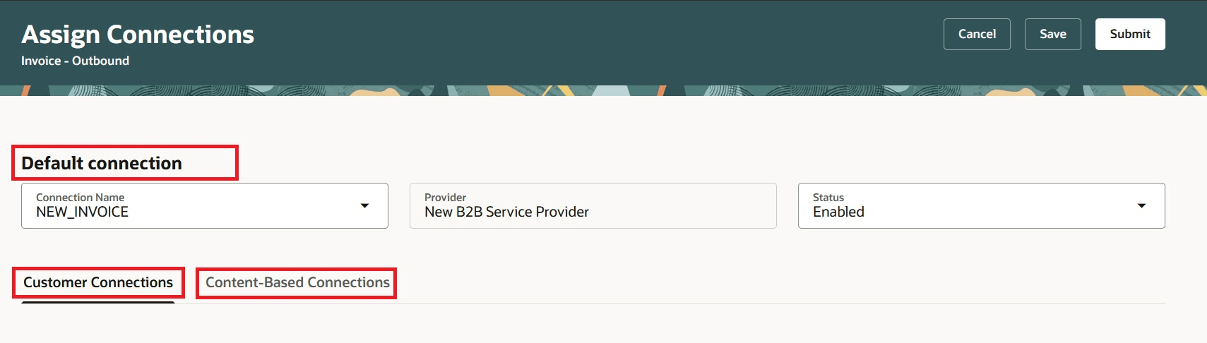

Assign B2B Connections
- Select B2B Documents from the Task Panel.
 - Click on the outbound document you want to assign a connection to, set the document to Enabled, then select Assign Connections.
Assign Connections
- On the Assign Connections page, you can assign a default connection, and a customer or supplier connection (whichever is applicable to the selected document) or a content-based connection (if available).
 - Click Submit.
 - Repeat this process for all your outbound documents.
 - You need to define active connections for each of your inbound documents, but you don’t need to assign connections to your inbound documents.
