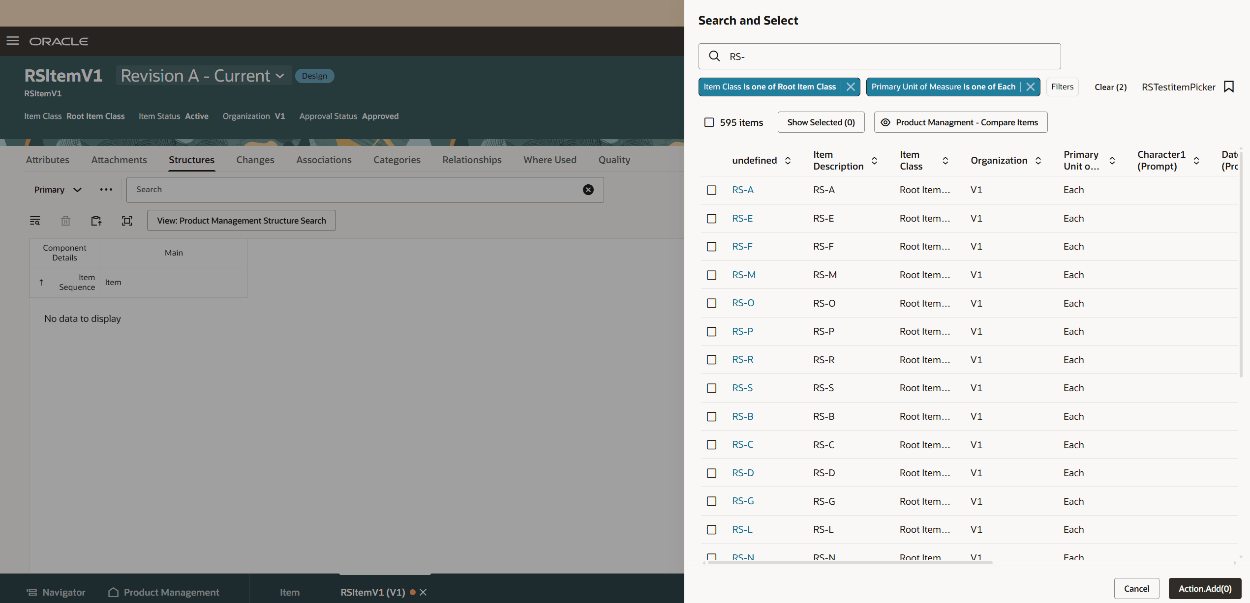

When you select the component in the item picker, you can:
  • Refine your search using filter chips
  • Multi-select the item components to add
  • Search and select the components to add to a structure and also perform a search for another component. You can also select a saved search.
    • The count in the Add button shows you the number of components that you're adding. Click the Show Selected button to see the selected components or select the saved search.
Search and Select Components to Add

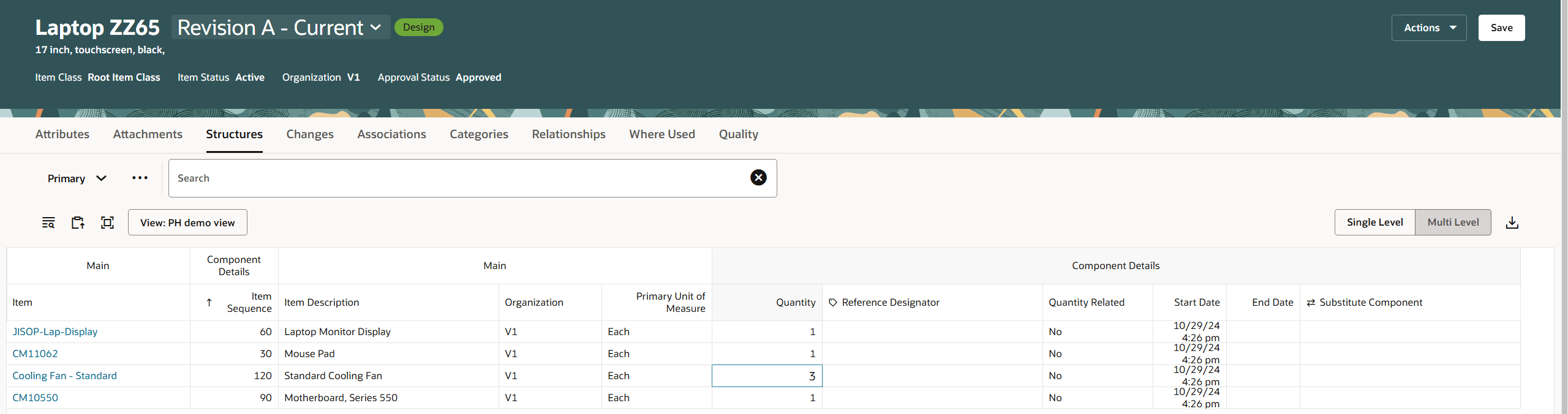

Once you add the components, double-click the cell to modify the component level attributes and the component descriptive flexfields.
Edit Component Level Attributes

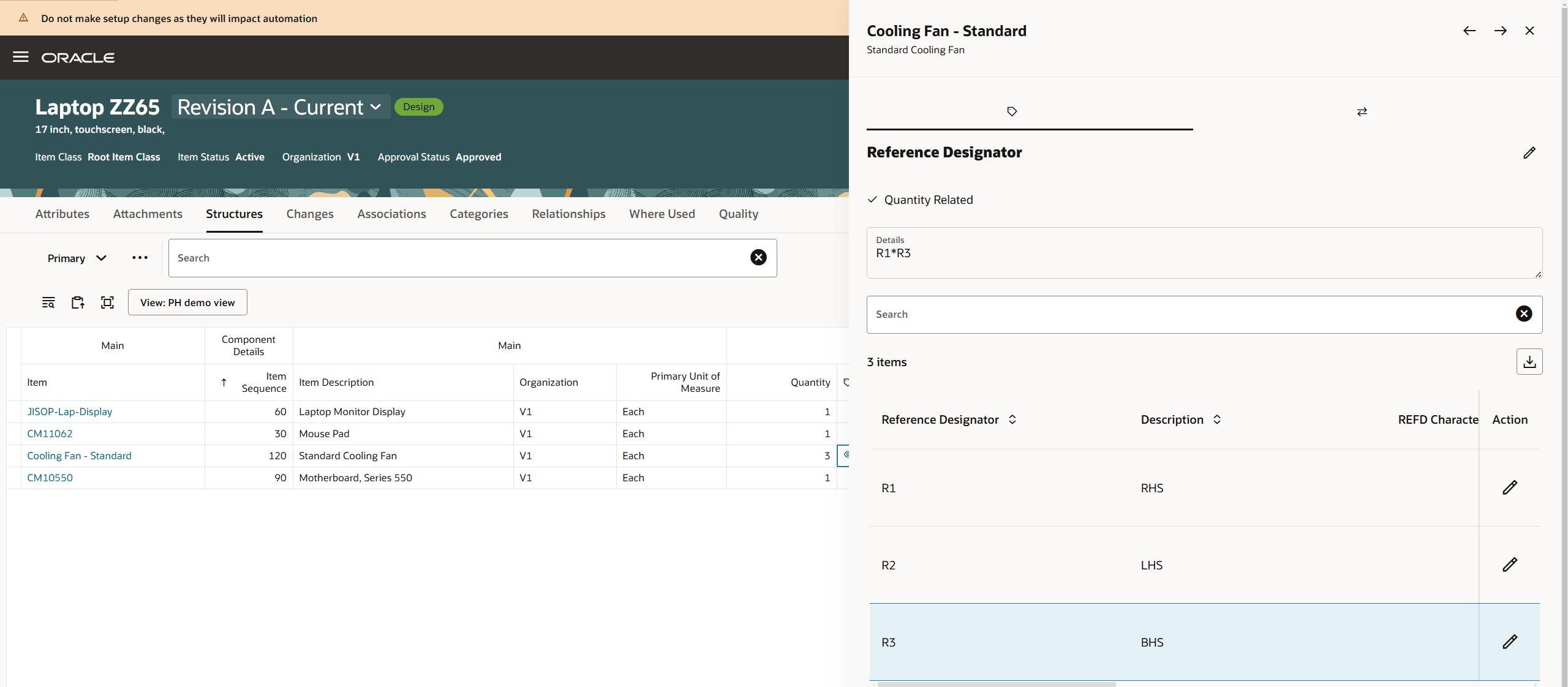

You can also add or modify reference designators and substitute components of a component.
To add reference designators, double-click the empty reference designator cell, which will open the side panel drawer. You can add a range, if the range indicator is configured in Manage Item Structure Type Details task, and comma separated values. The behavior of the Quantity Related and Align Quantity checkboxes is the same as it was in the classic user interface.
  • Quantity Related: validates the component quantity against the reference designator values
  • Align Quantity: automatically calculates the quantity based on the number of reference designators and displays it in the quantity column for the component
After you add the reference designators, you must click Apply so that they appear in the table. Modify the description  by selecting the pencil icon in each row.
Create and Edit Reference Designators for a Component
You can navigate to the next component using the navigator icons in the side panel and click the pencil icon to enable the edit mode.
To modify an existing reference designator, double-click the cell to navigate to the side panel and the pencil icon to switch to edit mode.

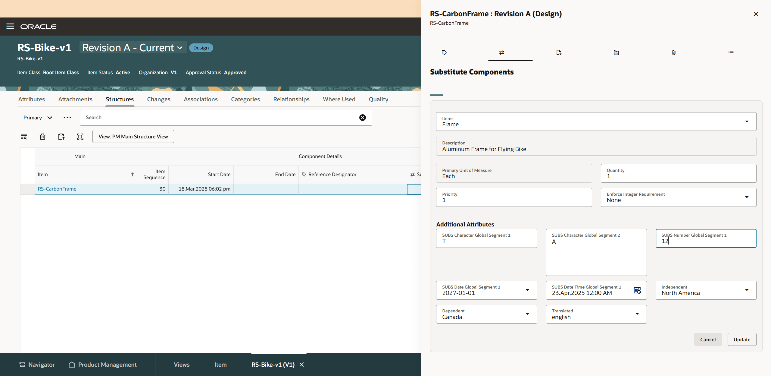

To add substitute components and descriptive flexfields, double-click the component cell which will open the side panel. To modify and delete components, click the pencil icon next to the substitute component.
Add Substitute Component to a Structure Component

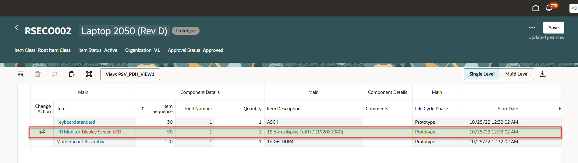

You can use the Replace action to replace one component with another.
Structure Component is Replaced

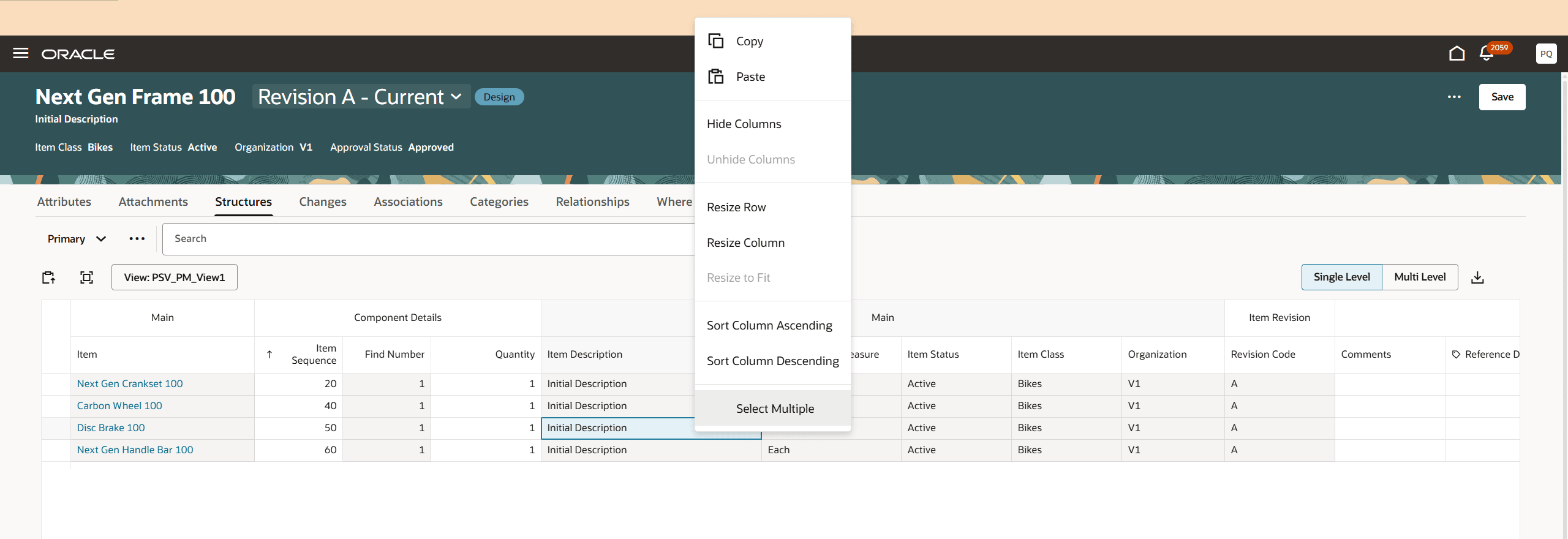

You can now right-click the component row to use the copy and paste attributes or use the keyboard shortcuts CTRL+C and CTRL+V for the same. You can only copy and paste the attributes that are inline edit and can’t copy and paste attributes edited in the side panel. If you copy consecutive cells that are read-only, only the editable cells will have their values pasted.
Copy and Paste Values for Inline Edit

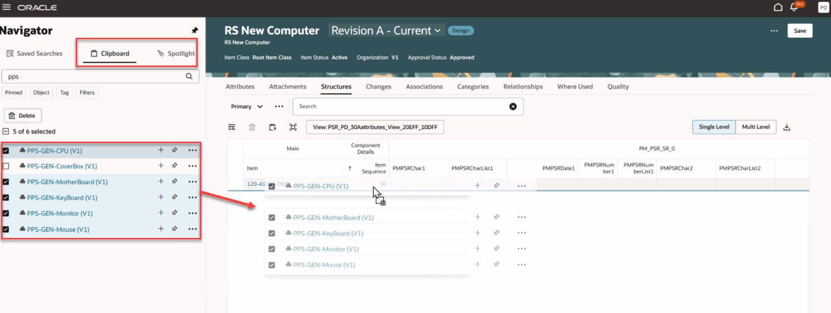

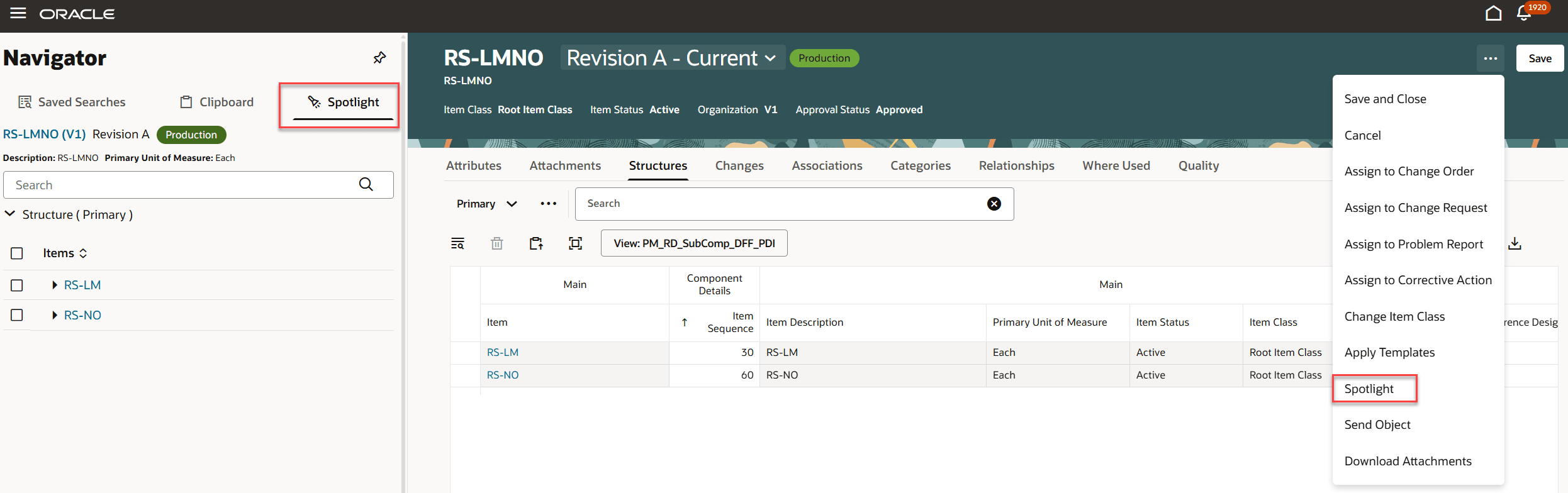

You can add individual components or sub-assemblies to the Spotlight displayed in the Navigator for that transaction. After adding the components, you can drag and drop them from the spotlight to another structure.
Add Component Items to Spotlight
The drag and drop feature is also supported from the clipboard. Select the items by selecting the checkboxes and drag them to the structure tab.
Drag and Drop from the Clipboard
