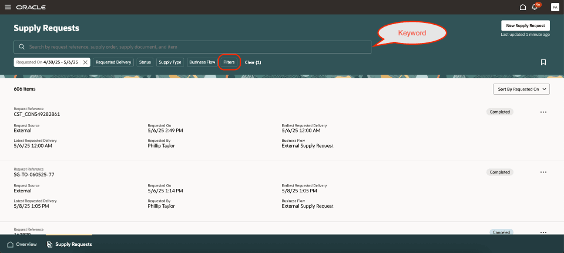

  1. Go to your home page, then click Supply Chain Execution > Show More > Supply Requests.
  2. Search for your request on the Supply Requests page:
Supply Requests

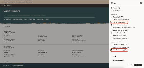

  1. Use filters to focus the search results:
  • Plan to Produce. Filter the supply requests that you received from Supply Planning.
  • Flow Manufacturing. Filter supply requests that have a flow schedule.
Supply Requests Filters

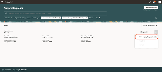

  1. In the search results, notice that the Request Source attribute contains Supply Planned Orders and the Business Flow attribute contains Plan to Produce, then click View Supply Request Details:

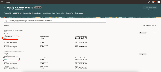

  1. Examine the details, then click 1014 under Flow Schedule:

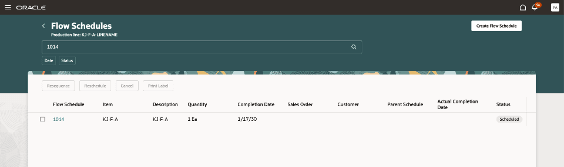

Flow Schedules
  1. Examine details about the flow schedule that Manufacturing created:
Flow Schedule Details
