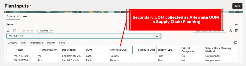

Collect Secondary UOM for an Item as an Alternate UOM
To collect the secondary UOM of an item for use as an alternate UOM in Oracle Supply Chain Planning:
  1. Create an item in Oracle Product Hub and set the Tracking Unit of Measure as Primary and Secondary.
  2. Specify a secondary UOM for the item.
  3. Create item-specific UOM conversions between primary and secondary UOM if the secondary UOM belongs to a different UOM class.
  4. Run Collect Planning Data for Items and Units of Measure.
The secondary UOM of the item will then be collected as an alternate UOM in Oracle Supply Chain Planning.

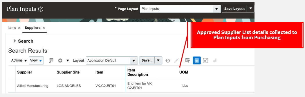

Collect Purchasing UOM and Its Unit Price for an Item, Supplier, and Supplier-Site Combination
To collect a purchasing UOM and its unit price for an item, supplier, and supplier-site combination from Purchasing to Oracle Supply Chain Planning:
  1. Create a blanket purchase agreement for the item, supplier, and supplier site with the purchasing UOM and its unit price in Purchasing.
    • If the purchasing UOM or unit price isn’t available, buy planned orders will be recommended with the item’s alternate UOM, and they’ll be released to Purchasing with the primary UOM.
  2. Create a global approved supplier list for the item, supplier, and supplier site with the same purchasing UOM as the blanket purchase agreement.
  3. Associate the blanket purchase agreement with the approved supplier list and ensure that the blanket purchase agreement is valid on the collection run date.
  4. Launch Collect Planning Data for the approved supplier list.
Approved Supplier List Details in Plan Inputs

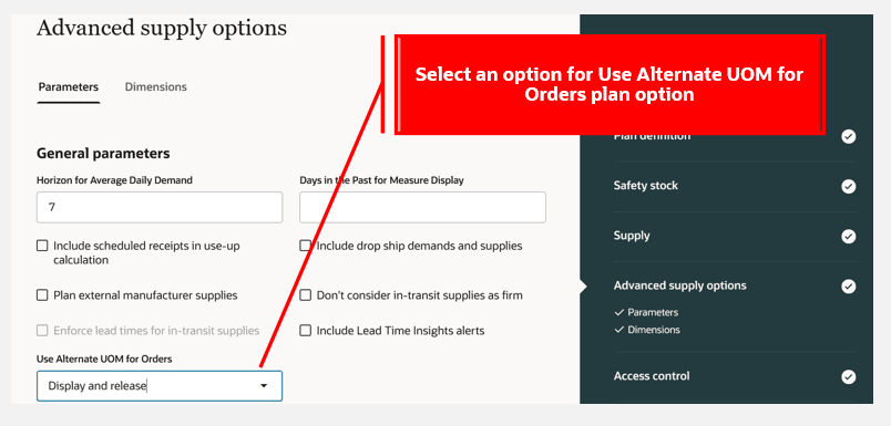

New Plan Option: Use Alternate UOM for Orders
Plan Options has been enhanced to enable a plan to display and release item quantities in an alternate UOM.
Navigate to the Advanced supply options section in Plan Options and select either of the following from the Use Alternate UOM for Orders field:
  • Display and release – Compute and display item quantities in the alternate UOM and release buy planned orders to Purchasing in the purchasing UOM.
  • Display only – Compute and display item quantities in the alternate UOM.
Use Alternate UOM for Orders Plan Option
  • The default value is Null for this plan option.
  • This plan option is enabled for supply plans, demand and supply plans, and replenishment plans.
  • This plan option is enabled for selection for Oracle Cloud SCM source system plans.

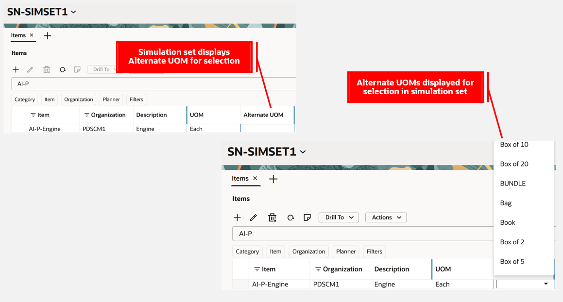

Alternate UOM in Simulation Set
Simulation Set has also been enhanced to specify an alternate UOM for items.
  • Alternate UOM for items can be specified if, and only if, the item is not collected with its secondary UOM from Oracle Product Hub.
  • Collected UOMs that are the same class as the primary UOM of the item can be selected as the item’s alternate UOM in a simulation set. For example, if the item’s primary UOM is Eaches, then Cases or Dozen of the same quantity class can be selected as the item’s alternate UOM.
  • Collected UOMs that are of a different UOM class as compared to the primary UOM class of the item can also be selected. However, only UOMs that have item-specific interclass UOM conversions are displayed for selection as an alternate UOM of the item.

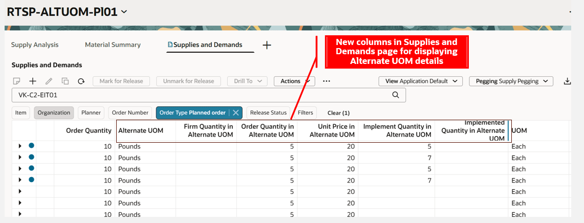

New UOM Attributes in Supplies and Demands
With this update, the Supplies and Demands page has been enhanced with the following additional UOM-related columns:
  • Alternate UOM - Secondary UOM of the item for supplies and demands or the purchasing UOM of the item, supplier, and supplier site for a buy planned order
  • Firm Quantity in Alternate UOM - Firm quantity of the order represented in alternate UOM by converting firm quantity using unit of measure conversions
  • Order Quantity in Alternate UOM - Quantity of the order represented in alternate UOM by converting order quantity using unit of measure conversions
  • Unit Price in Alternate UOM - Unit price of the purchasing UOM from the approved supplier list used by the plan for a buy planned order
  • Implement Quantity in Alternate UOM - Implement quantity of the order represented in alternate UOM by converting implement quantity using unit of measure conversions
  • Implemented Quantity in Alternate UOM - Implemented quantity of the order represented in alternate UOM by converting implemented quantity using unit of measure conversions
Alternate UOM Details Displayed in Supplies and Demands
Columns displaying alternate UOM related details aren’t editable on the Supplies and Demands page.

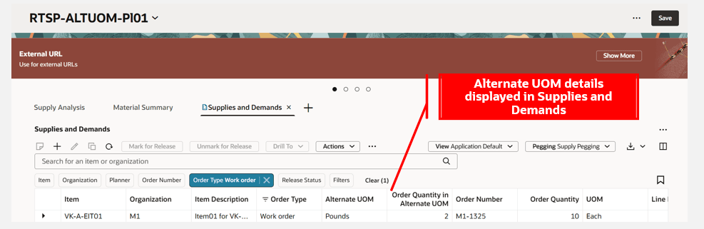

The following image shows an example of the new columns in a supply plan, displaying order quantities computed in the alternate UOM.
Order Quantities Computed and Displayed with Alternate UOM in Supplies and Demands
