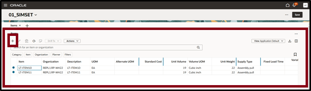

Add Items to Simulation Set
You can add or copy items to a simulation set by clicking the Add icon on the toolbar section of the Items table.
Items Table in Simulation Set

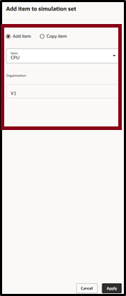

Adding an Item
  1. Click the Add icon on the toolbar. A drawer opens.
  2. In the drawer, select Add Item.
  3. Select the item and organization.
NOTE: You can’t add an item with that same name in a particular organization. You must either change the item name, select a different organization, or select a different item to copy.
Adding an Item
         Adding an Item

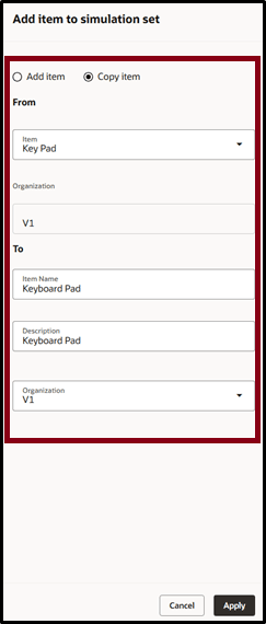

Copying an Item
You can copy the attributes of an existing item to a new item in a simulation set.
  1. On the drawer, select Copy Item.
  2.  Select the item to copy.
  3. Enter a new item name and description.
      Copying an Item
        Copying an Item

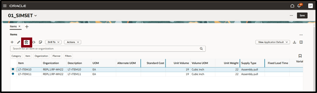

Delete Item
You can delete items in a simulation set by using the delete icon on the toolbar. Select one or more items to delete from a simulation set and click the delete icon.
Deleting Items
Deleting Items
