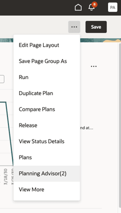

The Planning Advisor for Exceptions and Notes is available using a pre-built AI Agent template available in AI Agent Studio, listed in the SCM product family of templates. You can use it as is or make a copy of the template and refine the prompts as needed. The predefined Planning Advisor for Exceptions and Notes can be integrated directly into a plan’s primary action menu, using the existing Planning Advisor menu.
Planning Advisor Action in the Plan’s Menu

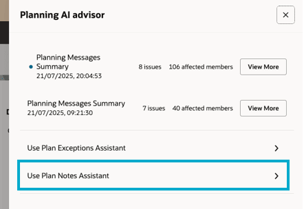

Click the Planning Advisor option. The Planning AI Advisor drawer opens. When the Notes Advisor is enabled using the Edit Page in Visual Builder Studio option (see Steps to Enable), you can see the Use Plan Notes Assistant in the Planning AI Advisor drawer.
The Use Plan Notes Assistant

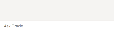

Select the Use Plan Notes Assistant option to open the AI chat experience. You can ask information for notes for a specific item or organization.
Empty Chat Input Box
Type your questions in the input box and the AI agent will provide a response related to the current plan.

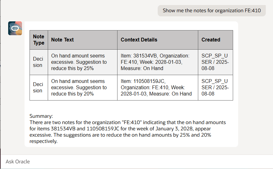

For example, you can ask for notes for a specific organization such as Show me the notes for organization FE:410.
Plan Notes Query Result

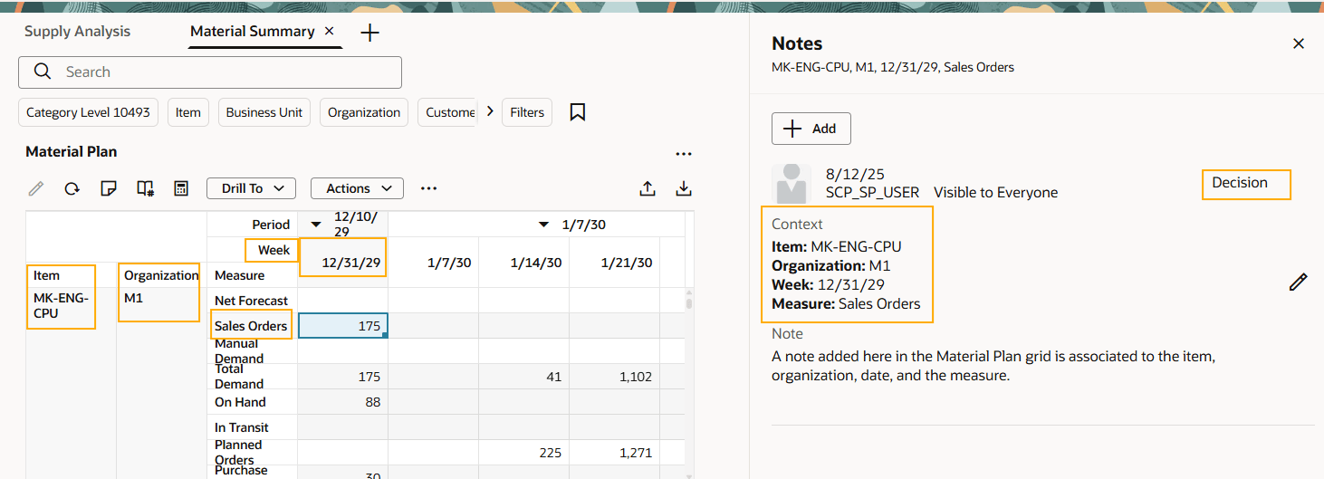

Notes associated to an item or an organization are available to the Notes Agent based on where they are created and the related context. For instance, adding a note to a specific cell in the Material Plan grid associates that note to the organization, item, week, and measure.
Material Plan Grid Showing a Note and its Multiple Attribute Context (Item, Organization, Week, and Measure)

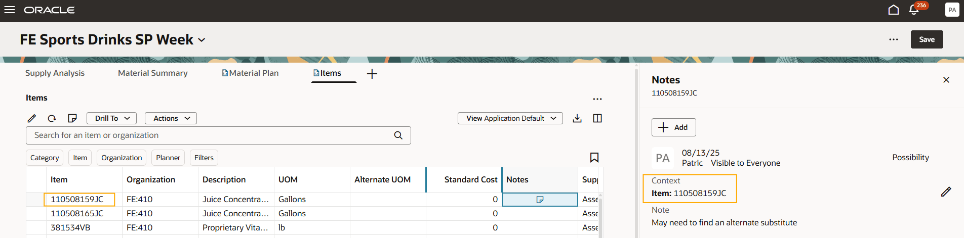

Adding a note to the item in the Items table associates the note solely to the item.
Items Table Showing a Note and its Single Item Context

The Notes assistant will return a list of the matching notes and provide a summary of the note content.

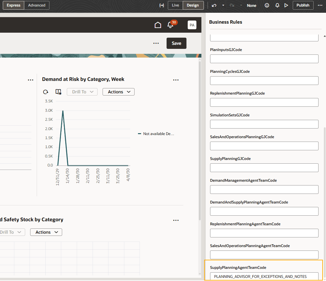

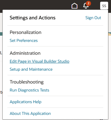

Enabling it requires assigning the AI Agent Team Code value to the placeholder constant(s) in the Page Properties section available when using the Edit Page in Visual Builder Studio found in your user menu at the top right of the page.
Edit Page in Visual Builder Studio in the User Menu
  1. Click the Edit Page in Visual Builder Studio. This will open a new tab and load Oracle Visual Builder Studio, displaying the Business Rules panel.
  2. Locate the corresponding plan type constant ending in AgentTeamCode, for example, SupplyPlanningTeamCode and set the value to PLANNING_ADVISOR_FOR_EXCEPTIONS_AND_NOTES.
    Using Visual Builder Studio to Configure the Agent
  3. Click Publish to publish the changes.
The Use Plan Notes Assistant option is now available from the Supply Plan menu’s Planning Advisor option.
