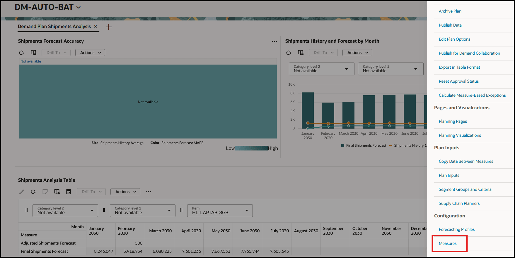

In the Redwood work area named Supply Chain Planning, in your plan, click More Actions > View More to open the Actions drawer.
Actions Drawer for Plan

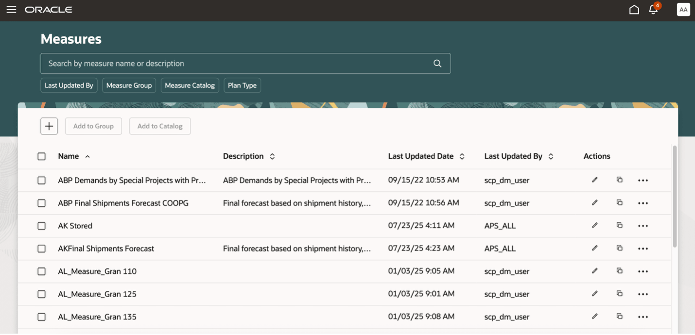

In Configuration, click Measures. The Measures page will open on a new tab.
Measures Page
Measures Page

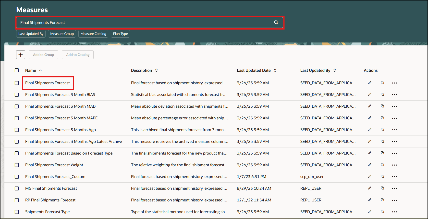

On the Measures page, you can view, create, duplicate, and edit measures.

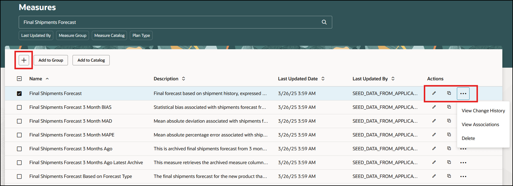

In the search bar, you can search for measures by their names or descriptions. For example, you can search for measures containing "Final Shipments Forecast" in their names or descriptions.
Search Bar on Measures Page

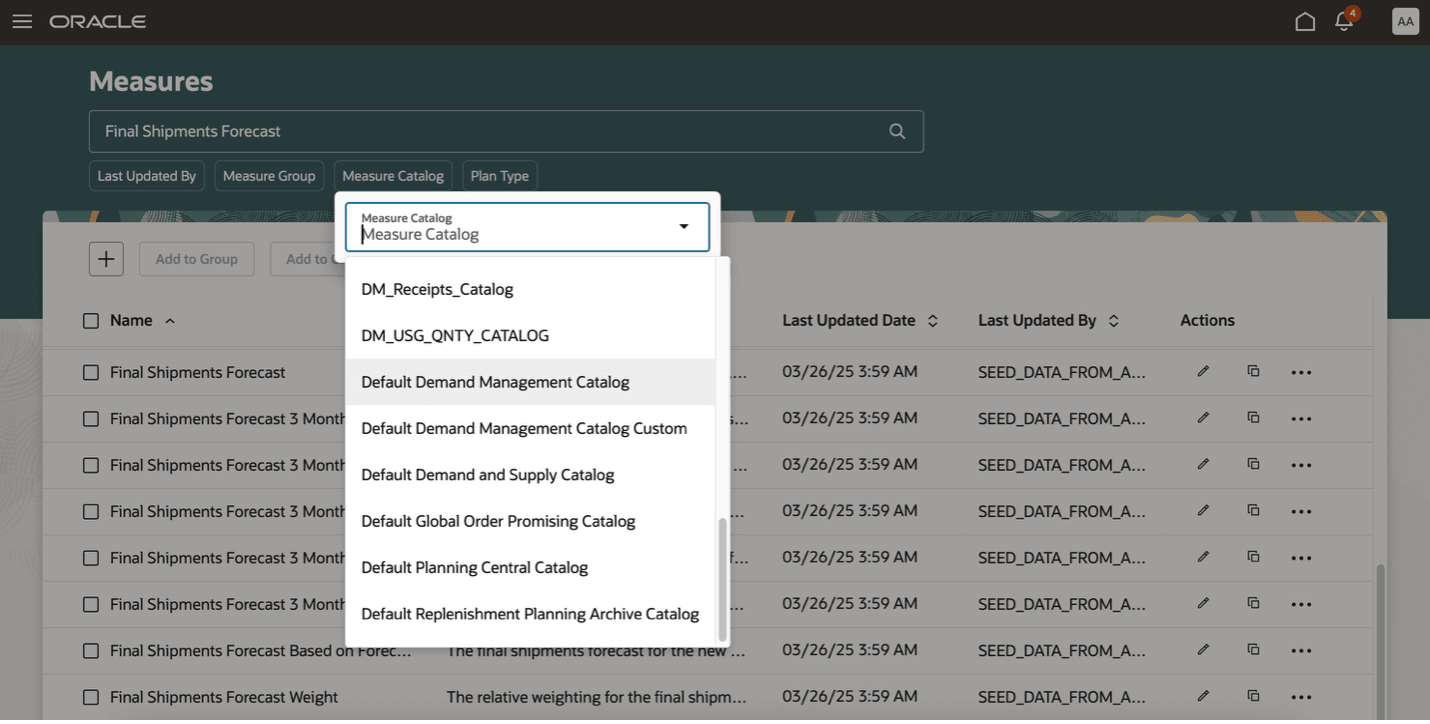

You can also use the suggested filters named Last Updated By, Measure Group, Measure Catalog, and Plan Type. For example, you can search for measures in the Default Demand Management Catalog.
Suggested Filters on Measures Page
You can click the Add icon to create a measure, Edit icon to edit a measure, and Duplicate icon to duplicate a measure. When you click the Actions icon, you can use actions for viewing the change history and associations or deleting a measure.

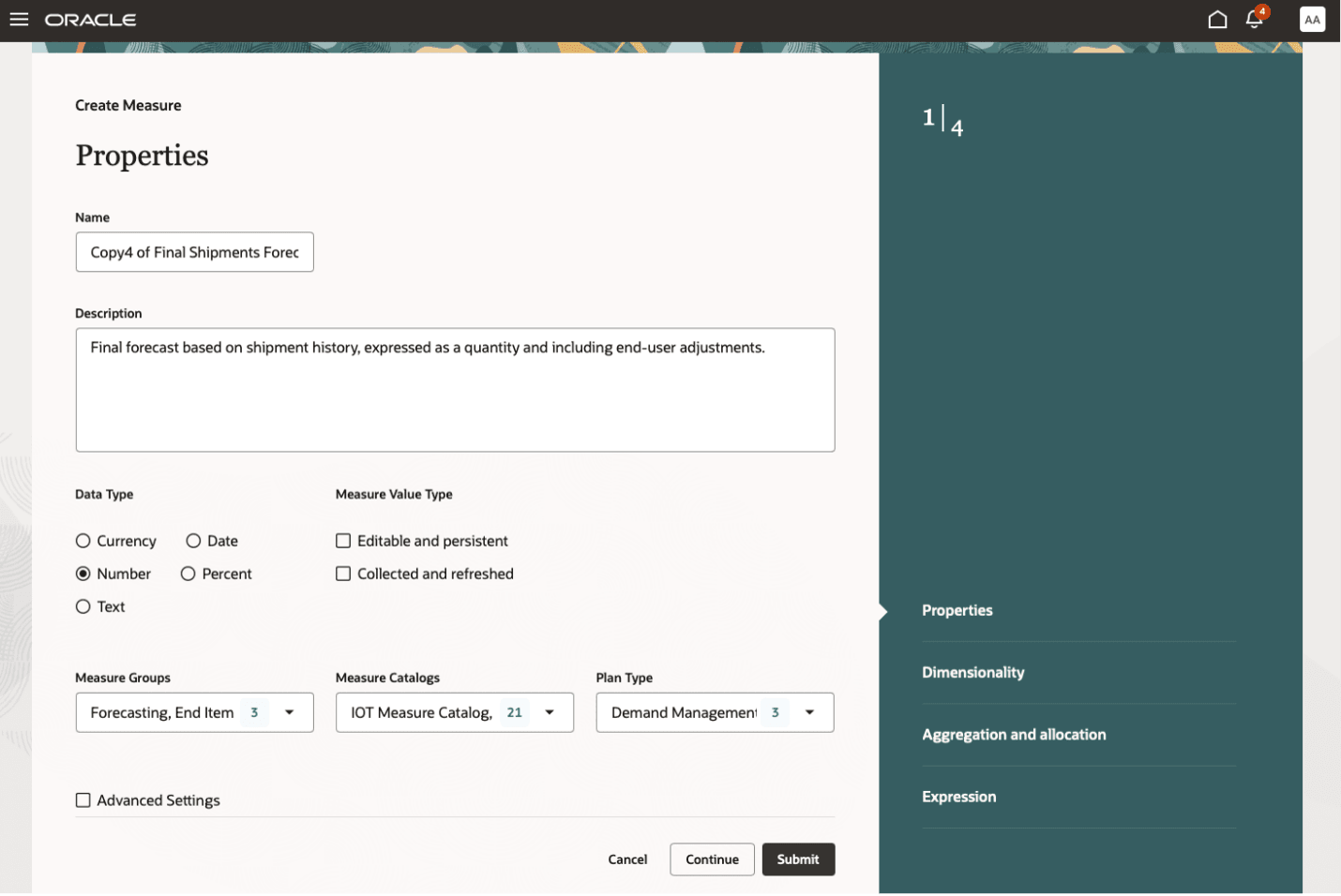

  • Properties: Specify basic information about the measure, including the applicable measure groups, measure catalogs, and plan types.

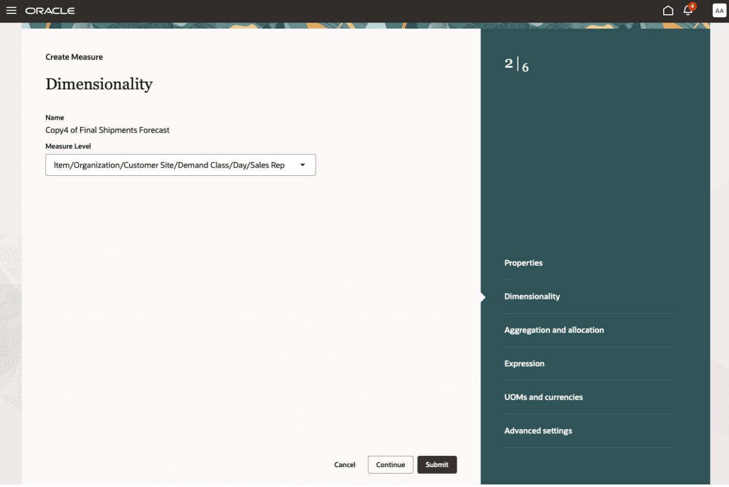

  • Dimensionality: Specify the dimensions and stored levels for the measure. Note that you can only select a predefined granularity in the Measure Level field.

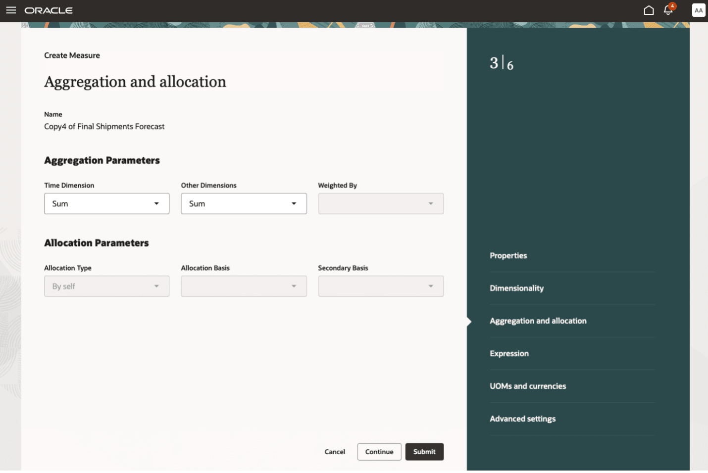

  • Aggregation and allocation: Specify how measure values are aggregated and allocated.

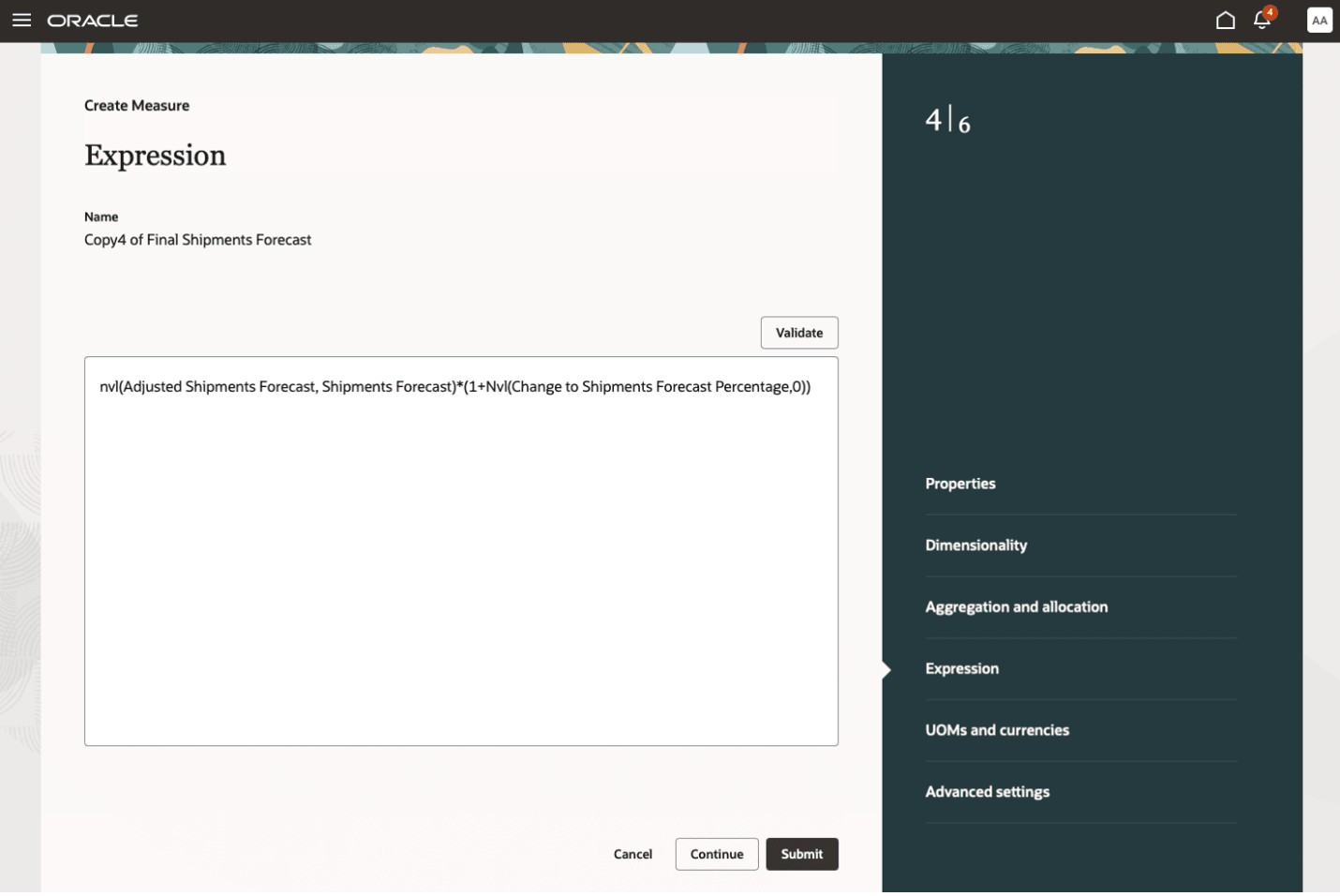

  • Expression: For measures that are calculated, specify the expression.
When you select the Advanced Settings checkbox in the Properties step, these additional steps are available:

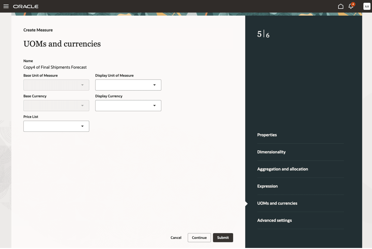

  • UOMs and currencies: Select units of measure (UOMs) and currencies for conversion.

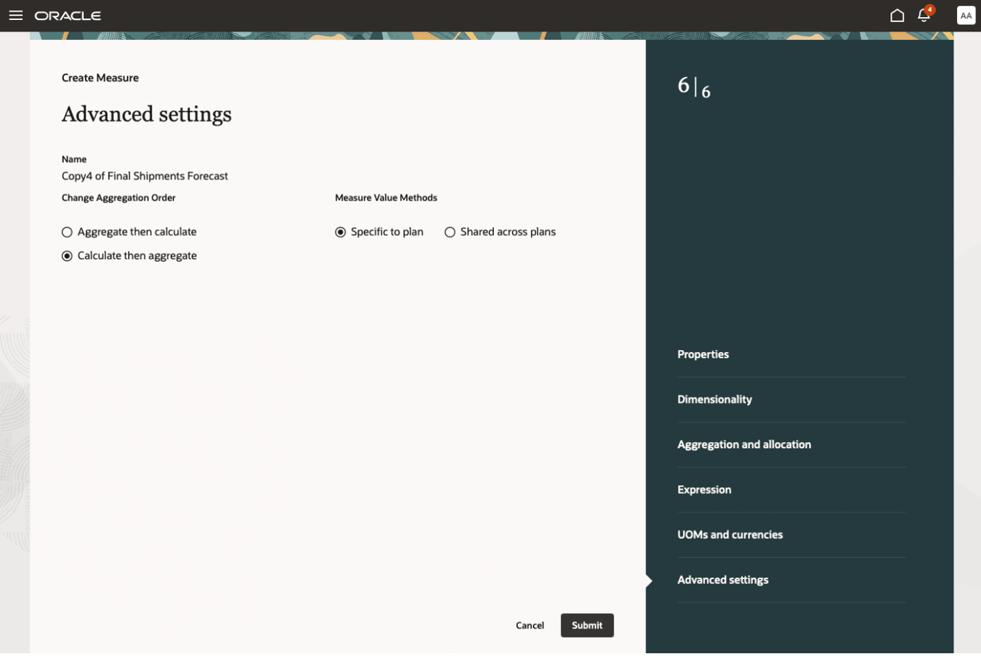

  • Advanced settings: Specify the aggregation order and whether the measure is plan-specific or shared.
Properties Step in Guided Process for Measures
Dimensionality Step in Guided Process for Measures
Aggregation and Allocation Step in Guided Process for Measures
Expression Step in Guided Process for Measures
UOMs and Currencies Step in Guided Process for Measures
Advanced Settings Step in Guided Process for Measures
