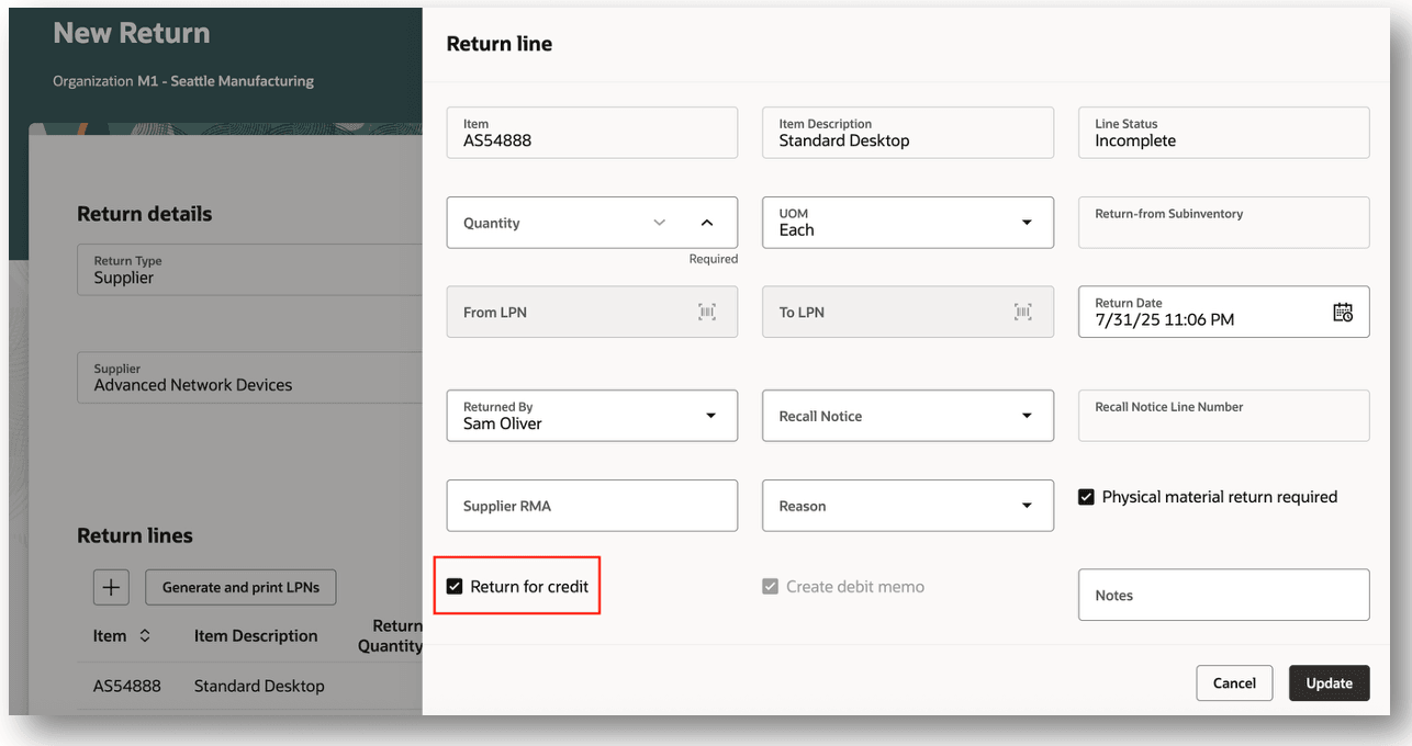

One of your ideas has been delivered from your suggestion.Use Supplier Return for Credit Only with Additional Flows
In certain situations, when you return goods to your supplier, you don't expect them to send you a replacement for the returned goods. Instead, you expect the supplier to send you a credit for the value of goods to be replaced. Therefore, you don't want the original purchase order reopened to ensure that goods can't be received against that purchase order in the future.

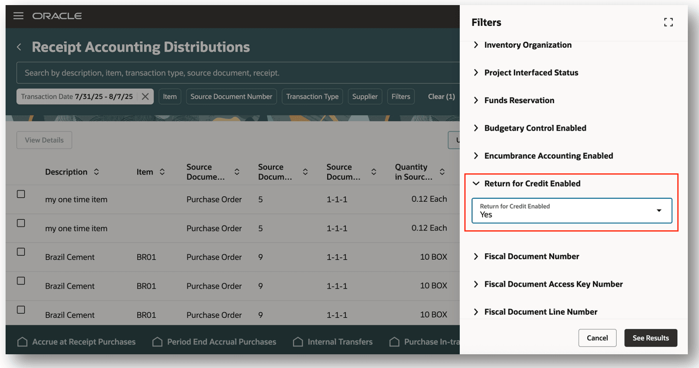

To assist Cost Accountants in managing the return for credit process, a return for credit indicator has been introduced. For example, the return for credit indicator is available as an additional accounting source in the receipt accounting subledger under receiving event class to support user configuration of accounts.
Additionally, the return for credit indicator is now a search attribute in the Receipt Accounting Distributions page for you to easily identify distributions specific to return for credit scenarios. Regarding receipt returns enabled for Projects, Budgetary Control, and Encumbrance. it will be recorded directly in Projects.

  • The Return for credit checkbox is applicable only if the status of the line being returned is delivered and the purchase order destination type is Inventory or Expense.
  • Return for credit is not allowed under the following conditions:
    • Purchase orders with destination type work order
    • Organization is located in Brazil
    • Business unit or the legal entity is enabled for delivery-based taxes
    • Drop ship flows
    • Consigned inventory flows
    • Global procurement and intercompany flows
    • Return of material residing in receiving subinventories
    • Retroactive pricing updates
  • When a return for credit transaction is performed, a debit memo is created:
    • An unmatched debit memo is automatically created in the Accounts Payable interface
    • The invoice source will be Return for Credit
  • You must run the Import Payables Invoices process to import the debit memo.
  • The invoice number of the debit memo will be in the RFC - < Transaction Id of the Return to vendor receiving transaction> - < PO Number > format.
