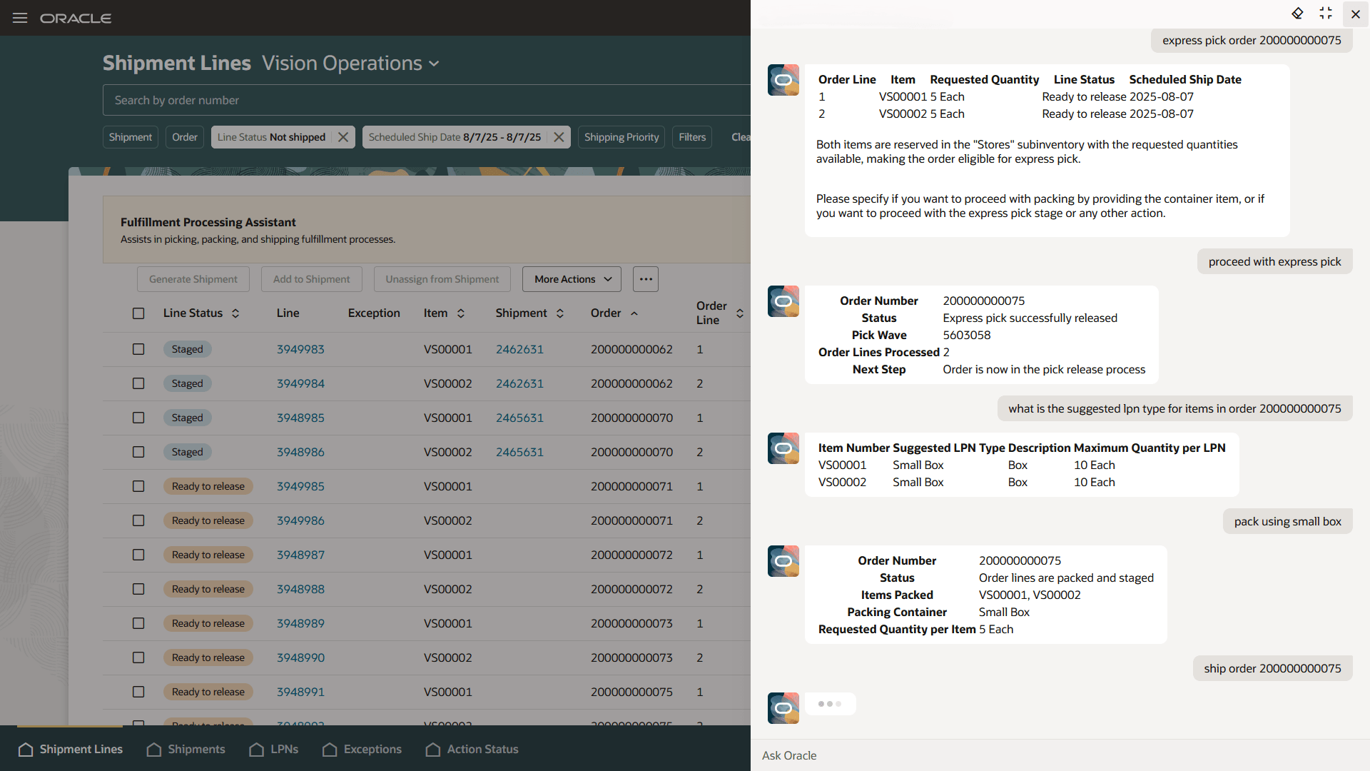

Sample Prompts
  • Show all lines and items in order 2000000073.
  • Who is the customer for shipment 2460641?
  • What is the planned delivery date for shipment 2457629?
  • What is the weight and volume of shipment 2460641.
  • What are the shipping method and freight terms for shipment 2460641?
  • What exceptions are reported for shipment 2457629?
  • What is the line status of order 2000000073?
  • Express pick order 2000000073.
  • Pick release order 2000000073.
  • Quick ship stage the order 2000000073.
  • Stage the order 2000000073.
  • Suggest LPN types for order 2000000073.
  • How many LPNs are needed to pack order 2000000073?
  • What are the last used LPNs for the item in order 2000000073?
  • Pack the order 2000000073 using container BX001.
  • Pack the order 2000000073 using LPN Type BX001.
  • Pack the order 2000000073.
  • Pack the order 2000000073 using the default configuration.
  • What is the packing policy guideline for order 2000000073?
  • Ship order 2000000073.
  • Ship confirm shipment 2457629.
  • Print shipping documents for shipment 2450664.
  • Print packing slip report for shipment 2454640.
  • Print shipping documents for order 2000000073.

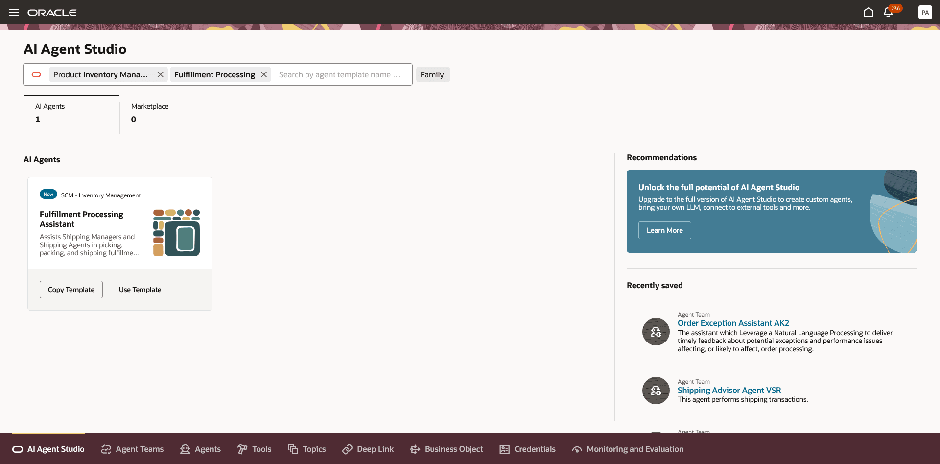

Steps to enable and configure
You can use AI Agent Studio to use or copy a preconfigured agent template to create Agents for your business processes. To automatically add a suffix to all artifacts in your agent team, you can Copy Template instead of Use Template. When you copy a template, you're directly taken to the agent team canvas where you can edit the agent team settings, agents, tools, and topics. The Use Template option takes you through a step-by-step process for configuring each artifact in the agent team.
Agent Template: Fulfillment Processing Assistant
Fulfillment Processing Assistant Template
For information on using AI Agent Studio, see How do I use AI Agent Studio?
