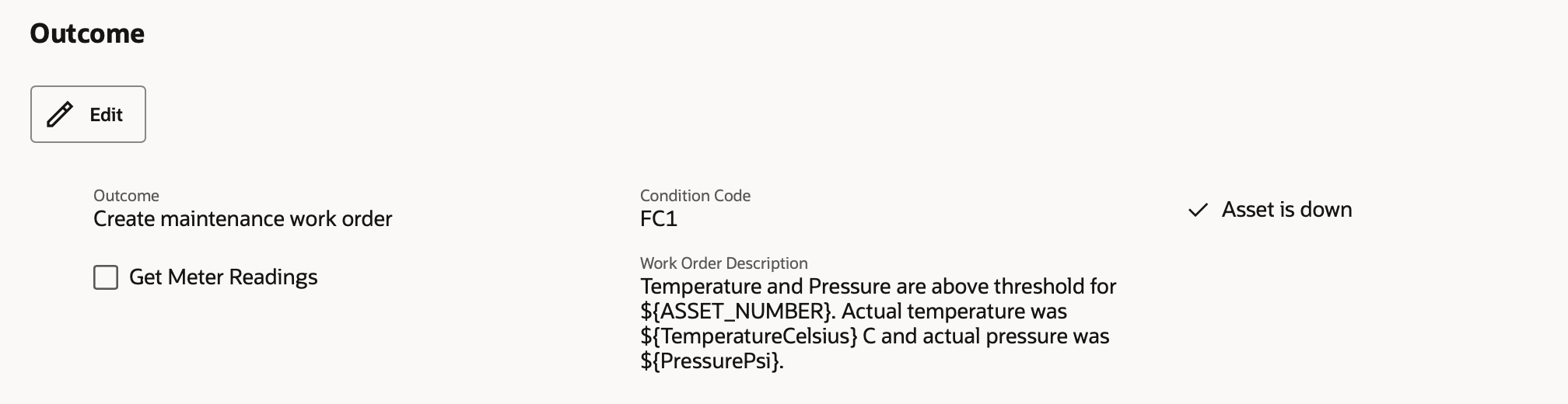

Get Meter Readings
You now have a new checkbox, Get Meter Readings, on the Outcome drawer of Operational Rules page. Select the checkbox to configure automated meter readings within a Create maintenance work order outcome. Here's a screenshot of the Outcome section followed by that of the Outcome details drawer. When you click the Edit button on the Outcome details page, the Outcome details drawer appears.
Outcome Section of the Operational Rules Page

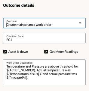

Select the Get Meter Readings checkbox in the drawer as shown in the screenshot.
Outcome Details Drawer
