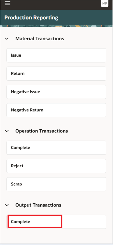

You can also access Mobile Manufacturing UIs from Quick Actions under Production Reporting.
Landinng page
Production Reporting Page

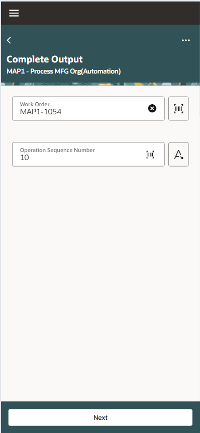

Search Work Order Operation

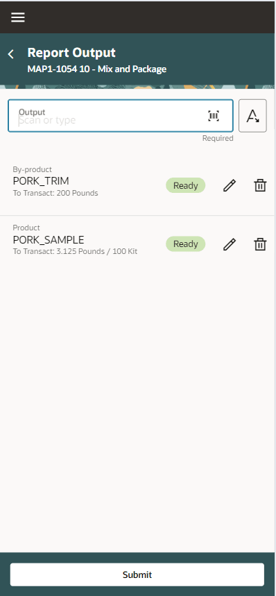

Report Output
Report Output UI
