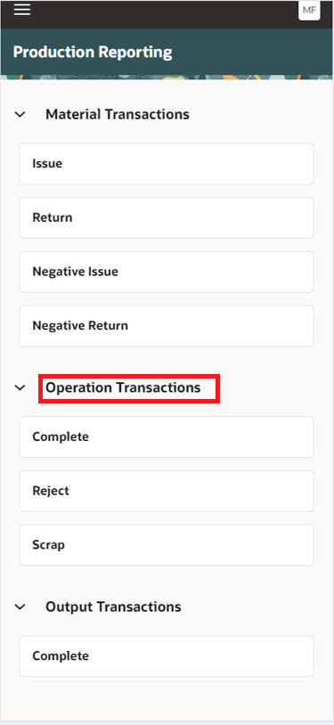

You can also access Mobile Manufacturing UIs from Quick Actions under Production Reporting.

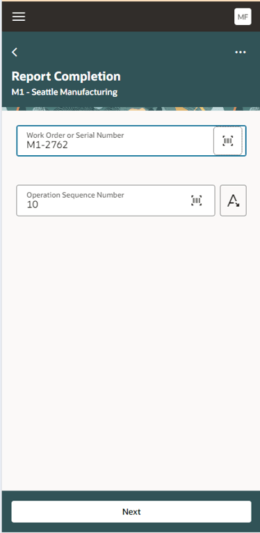

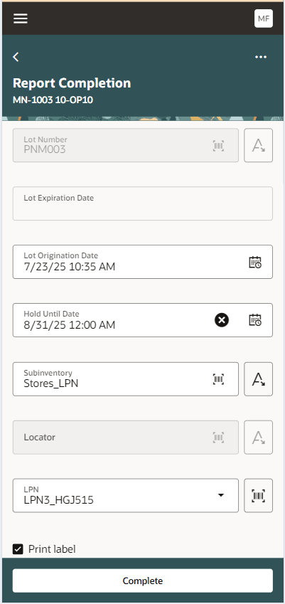

While searching for the work order operation and assembly serial of any serialized work order, the user can scan the work order or serial number. If the organization is License Plate Number (LPN) enabled, the user can specify the LPN details while completing the product. You can also access Mobile Manufacturing UIs from Quick Actions under Production Reporting.

Production Reporting Page
Operation Completion 1
Search Work Order for Operation Transaction
Operation Completion 2

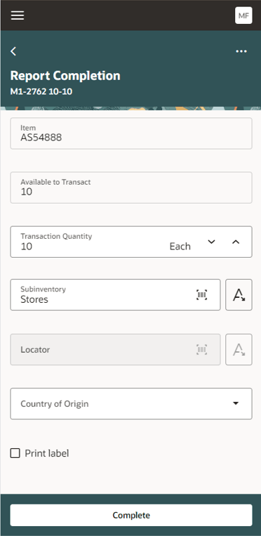

Operation Completion Details
Operation Completion details including LPN
Operation Completion Details Including LPN
