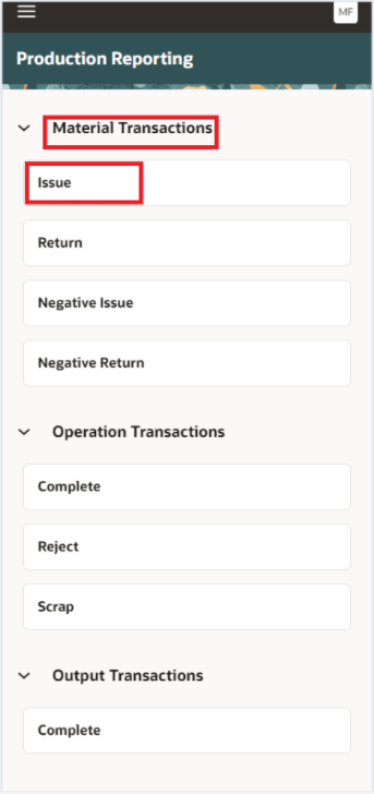

Production Reporting Page
Material Issue 1

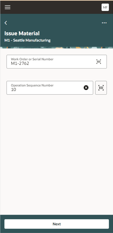

Scan or Search for Work Order Operation to Issue Materials
Material Issue 2

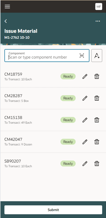

Material Issue UI
