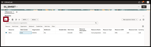

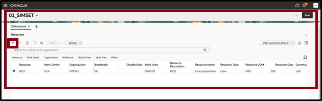

You can create new resources for what if scenarios in a simulation set by copying the attributes of the existing resources from plan input or output. You can add resources to a simulation set by clicking the Add icon on the toolbar section of the Resources table.
Resources Table in Simulation Set
To add a resource:

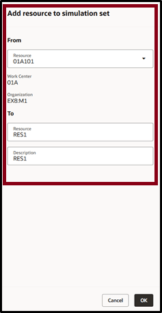

  1. Click the Add icon on the toolbar. A drawer opens.
  2. In the drawer, select an existing resource from a work center and organization.
NOTE: You can’t add a resource with the same name in a particular organization. You must either change the resource name or select a different organization.
Adding a Resource
Adding a Resource
