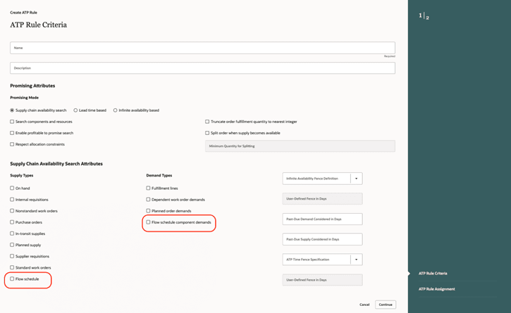

Steps to enable and configure
You don't need to opt in to any features, but you do need to enable some options on your ATP rule.
Go to the Order Promising work area, open your ATP rule for editing, then enable these options:
  • Flow Schedule
  • Flow Schedule Component Demands
For example:
Flow Schedule Flow Schedule Component Demands
