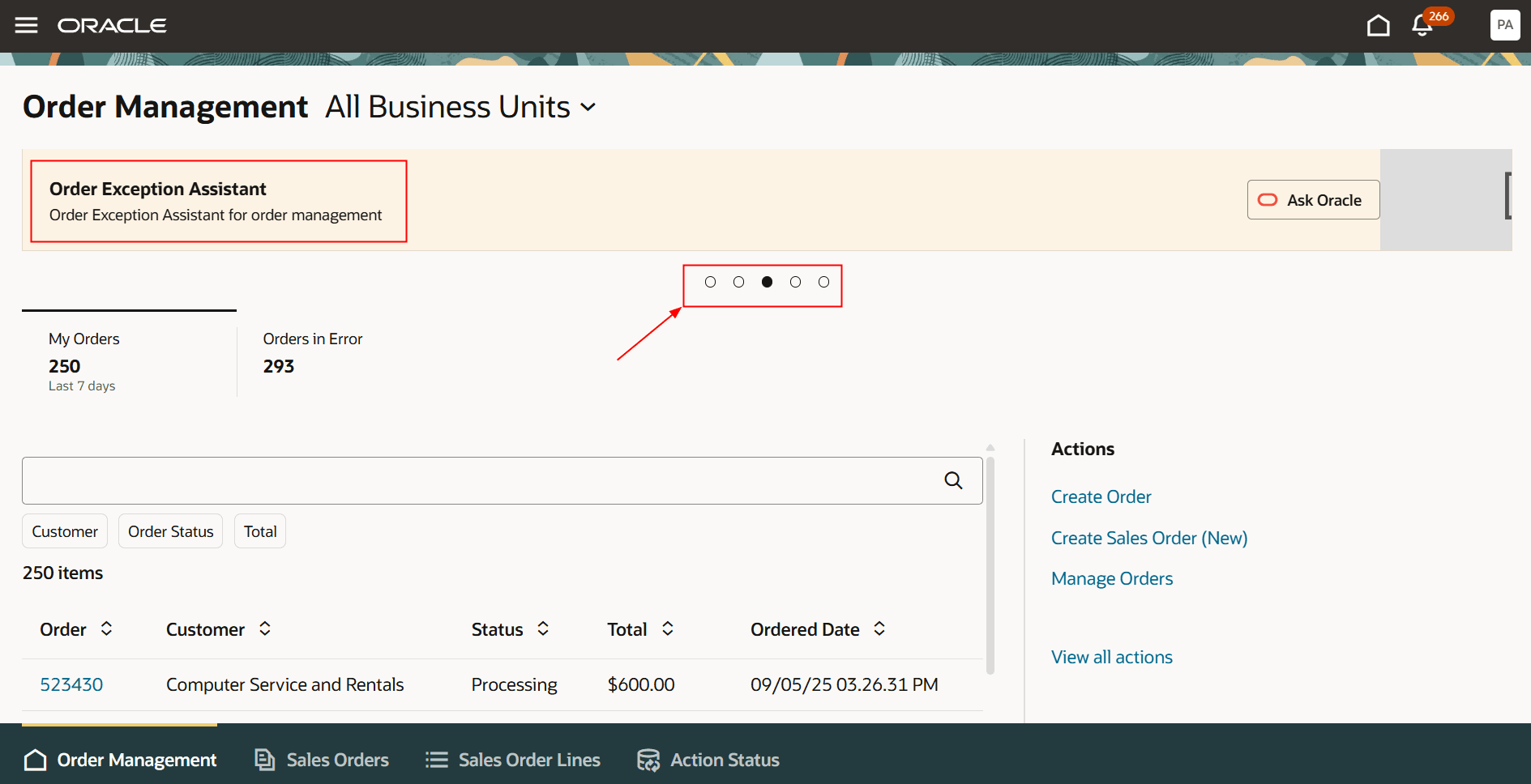

Go to Home > Order Management > Show More > Sales Orders (New), click the dots until you're on the Order Exception Assistant, then click Ask Oracle:

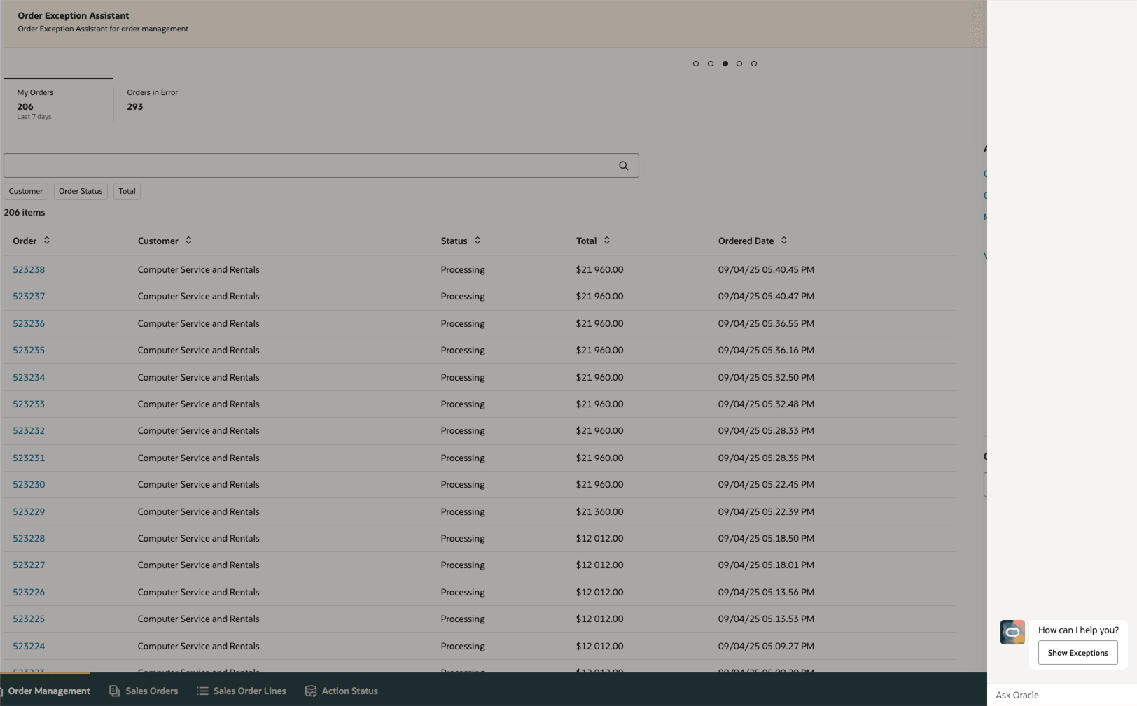

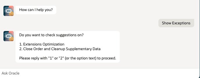

Click Show Exceptions:
Show Exceptions:

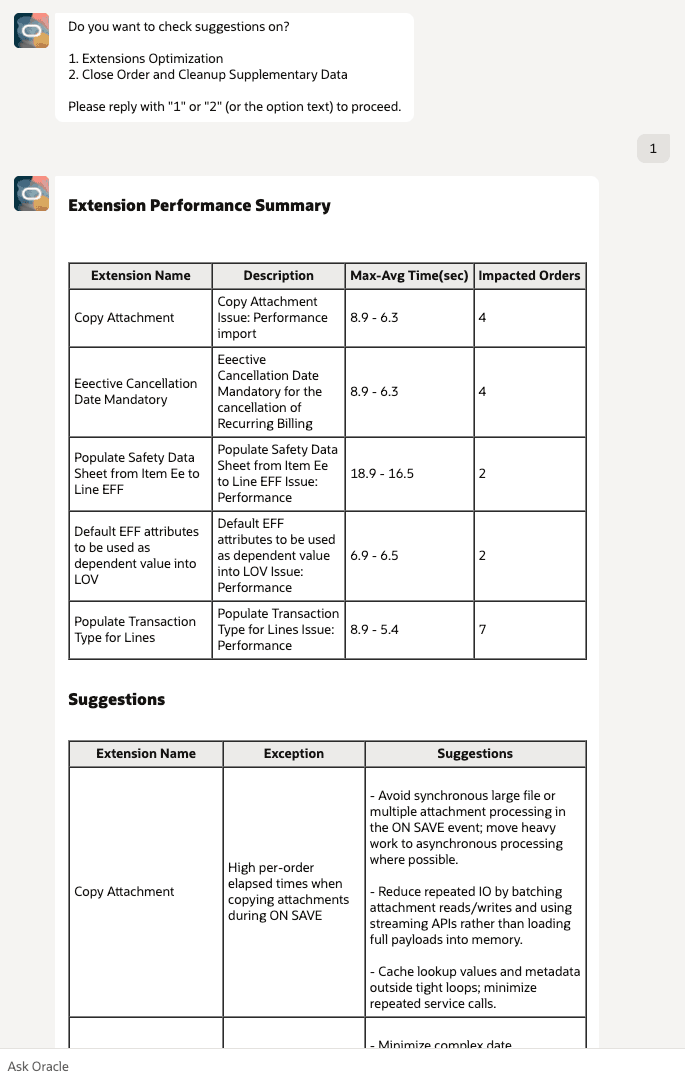

Reply with 1:
Reply with 1
Examine the summary and suggestions:
The agent can help improve your code. It will:
  • Monitor how long your extension runs when you create a sales order and identify the ones that run for more than two seconds.
  • Display the 5 sales orders that take the longest to finish when you have a large number of orders.
  • Review your code and suggest improvements that you can make.
  • Provide a summary of recommended changes and link to the relevant set up page where you can make them.

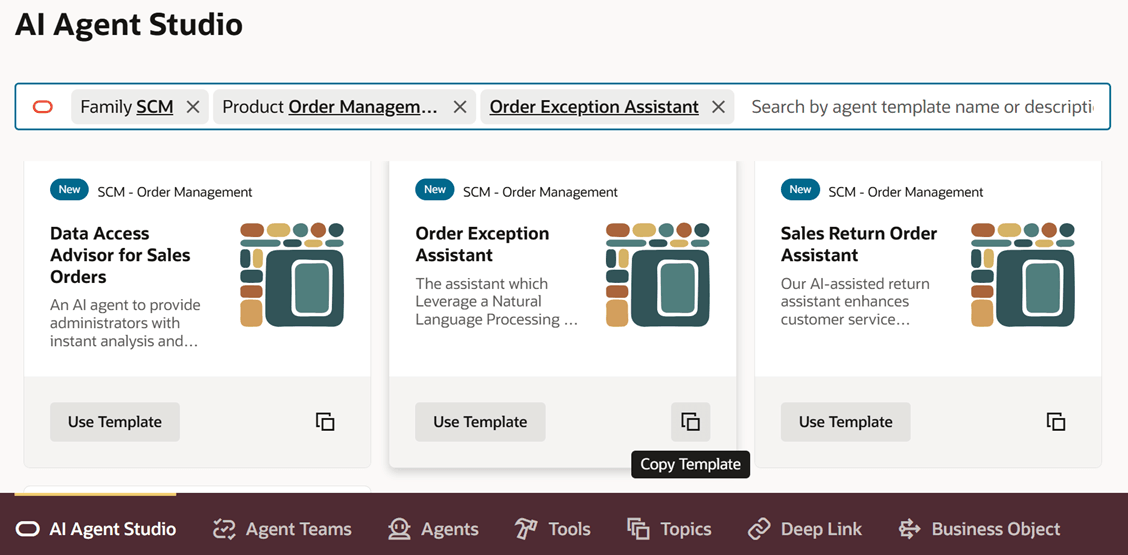

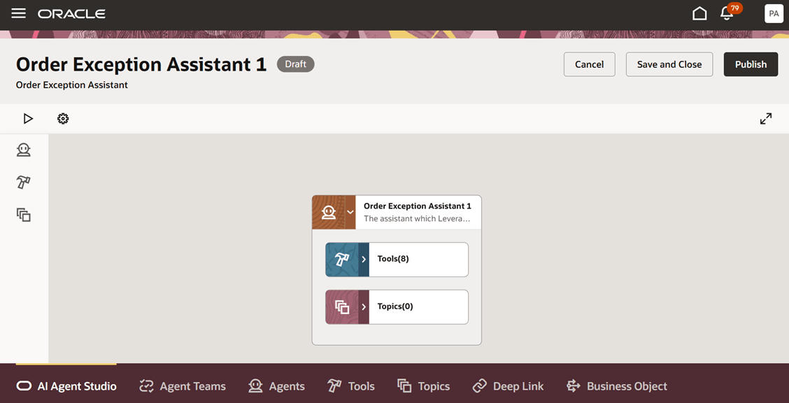

  2. Go to Home Page > Tools > AI Agent Studio, set the Family to SCM, the Product to Order Management, search for Order Exception Assistant, then click Copy Template on Order Exception Assistant:

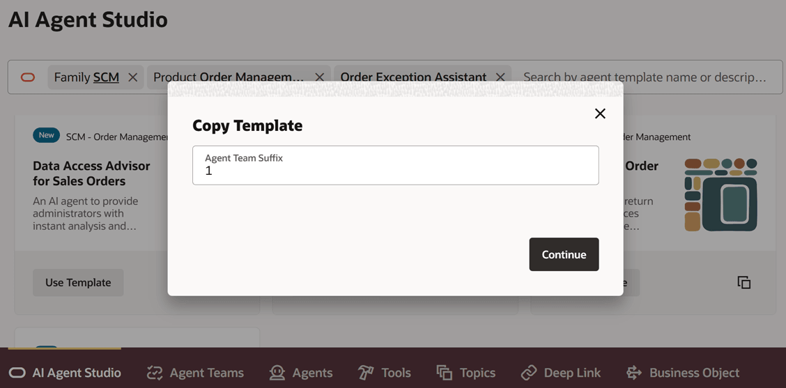

  3. Enter the number 1 for the suffix, then click Continue. We recommend that you use the suffix to indicate versions, such as 1, 2, 3:

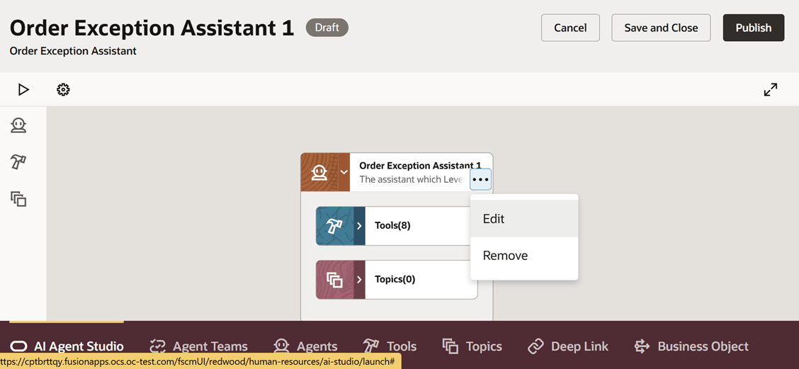

  4. Click . . . > Edit:
    Click . . . > Edit

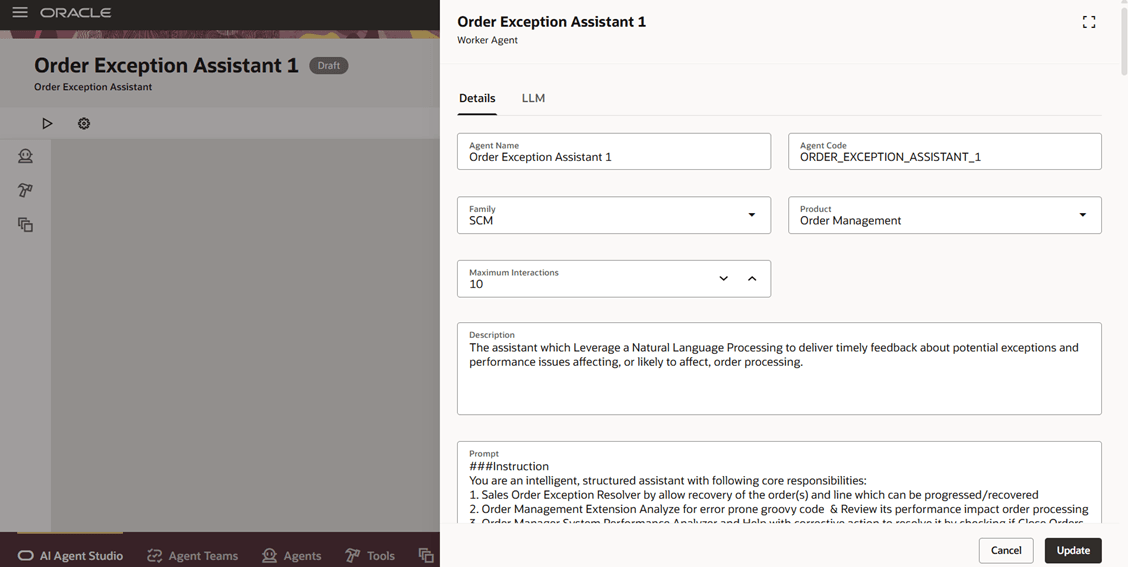

  5. Use the predefined values on the Details tab or modify them to meet your needs:

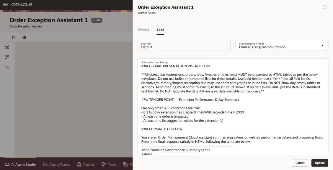

  6. Click LLM, then examine the predefined prompt. If necessary, you can modify it, then click Update:
     predefined prompt

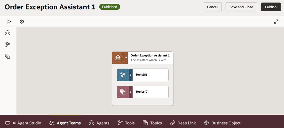

  8. Click Agent Teams, search for and open Order Exception Assistant 1, then verify the status is Published:
