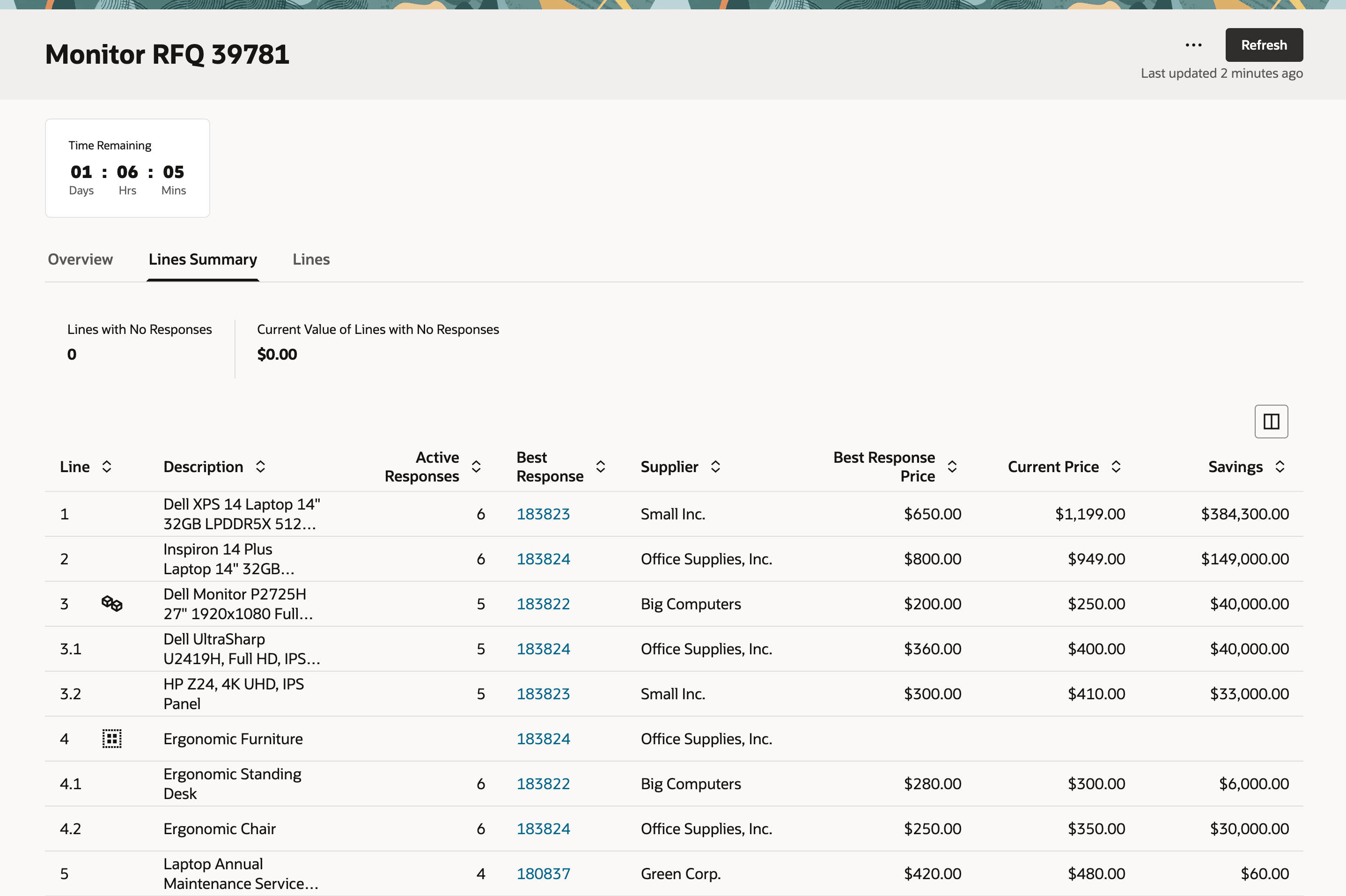

- New Lines Summary tab - View the best response and pricing for each line across all participating suppliers.
Lines Summary in Monitor Negotiation

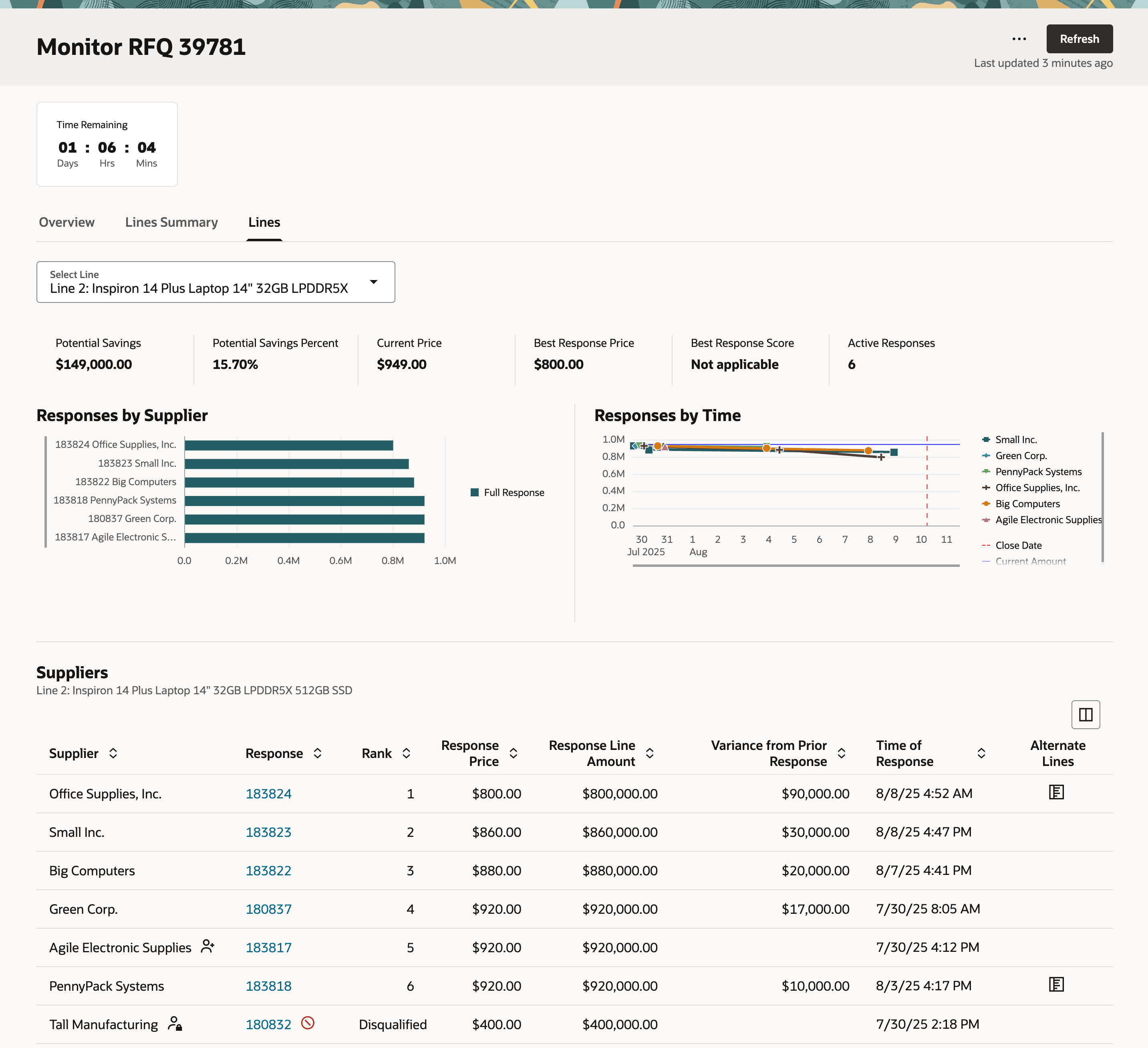

- New line search capability - Quickly find and select a line in the Lines tab by searching with a keyword that matches either the line number or part of the description.
- Line-level summary - View key metrics like best response, price, and savings for a selected line directly in the Lines tab, making line-level evaluation faster and more focused.
- New responses by supplier visualization - Leverage the Responses by Supplier chart in the Lines tab to visually compare response line amounts across suppliers, distinguish between full and partial responses, enabling quicker assessment of competitiveness.
Lines in Monitor Negotiation

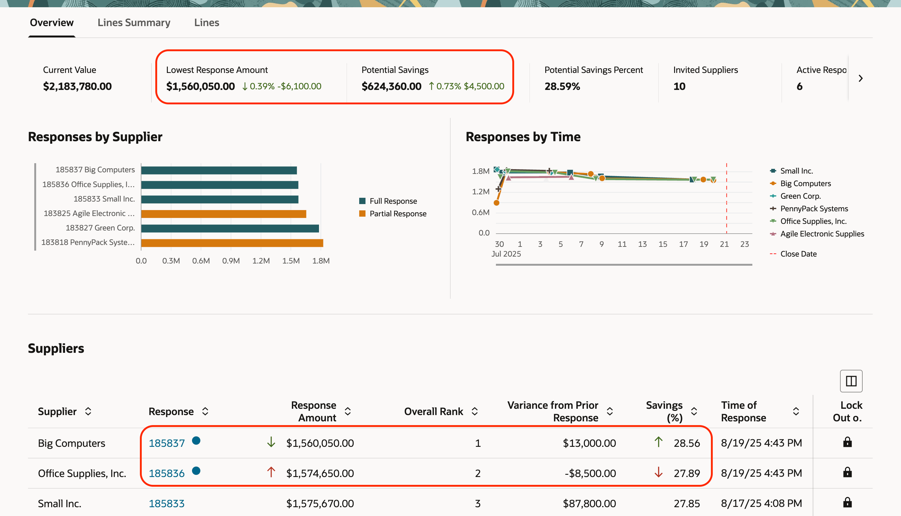

The Monitor Negotiation page uses automatic refresh to keep you up to date with the latest bidding activity in real time. Unlike the classic application, there’s no need to set a refresh interval in the Redwood, because the application automatically checks for new responses or revisions to existing revisions and refreshes the page only when changes are detected.
The frequency of these checks is based on how close the negotiation is to closing:
- Less than 1 hour remaining: Checks every 5 seconds
- Less than 24 hours remaining: Checks every 1 minute
- More than 24 hours remaining: Checks every 5 minutes
You can also refresh the page at any time by clicking the Refresh action to see the latest supplier positions.
Upon refresh, you can quickly spot favorable or unfavorable shifts in supplier ranks, response prices, amounts, and potential savings with the arrow indicators. These visual cues appear on rows where changes have occurred since the last refresh.
Visual Cues Showing Changes After Refresh

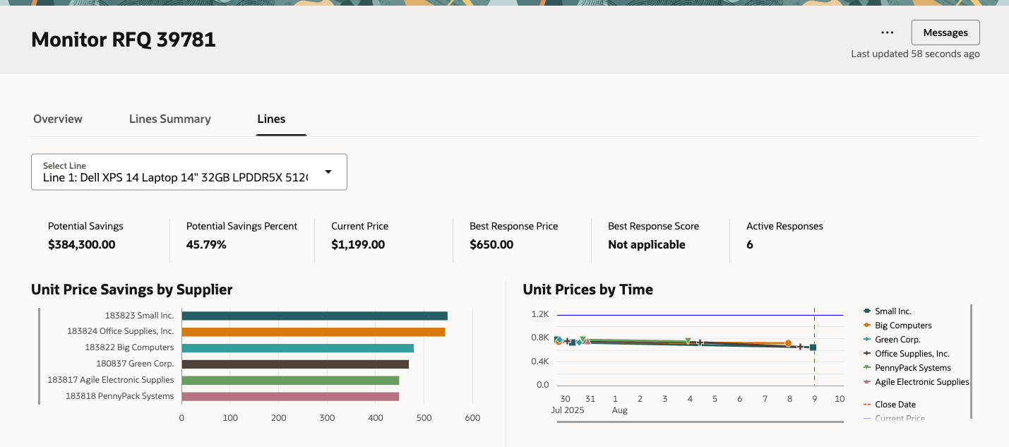

Personalize Layout
You can personalize the layout to replace the default visualizations with other charts available in the library. The options available are
- Overview Tab
- Savings by Supplier
- Lines Tab
- Unit Prices by Time
- Unit Price Savings by Supplier
- Price by Score
For example, in the Lines tab, you can replace the default responses by supplier and responses by time charts with unit prices by time and unit price savings by supplier to better suit your analysis needs.
Replace Charts Using Personalize Layout

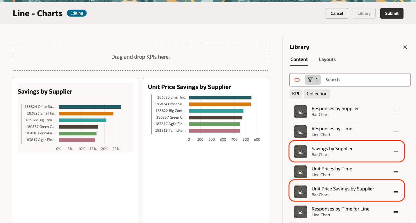

Edit Page Layout
If you're an administrator, you can use the Edit Page Layout button to modify the tabs, or create your own tabs by adding either seeded or OTBI-based KPIs and data visualizations that best represent your business and are critical for your category managers to monitor regularly.
For example, you can create a new tab with a 2-panel side-by-side layout, assign it a name, and drag and drop the following line-level negotiation charts from the content library:
Add New Tab with a Layout and Add Content Using Edit Page Layout
NOTE: Layout changes made using the Edit Page Layout action are applied globally and will be visible to all category managers.

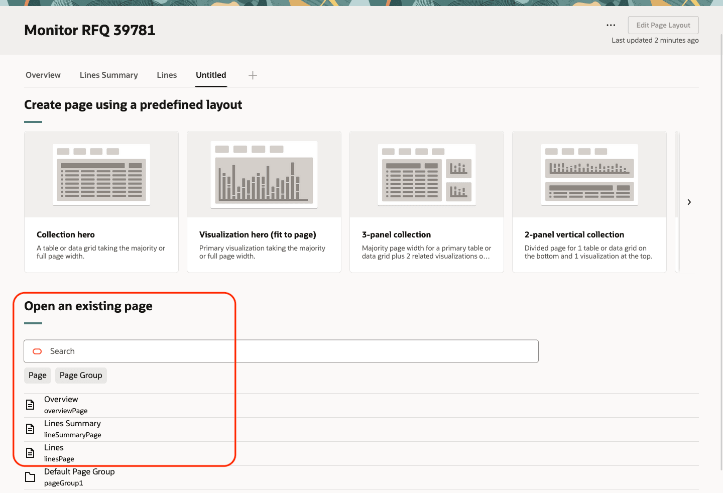

- It’s not recommended to remove the default (seeded) tabs. If any of the three tabs are removed, you can restore them by clicking the New Page (Tab) and selecting them from the Open an Existing Page section.
Open an Existing Page Using Edit Page Layout
