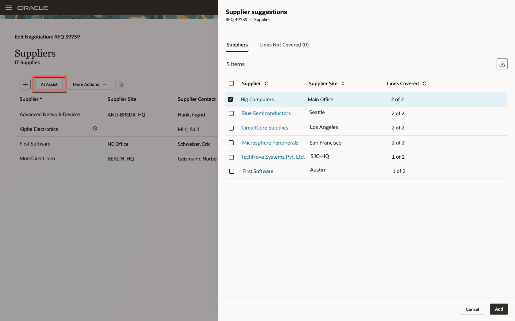

When you create a negotiation, use AI Assist to view supplier suggestions. Suppliers are listed in order of how many negotiation lines they are suggested for. Any negotiation lines without suggested suppliers will be shown under the Lines Not Covered for quick review.

Add Suppliers Suggested by Oracle AI
Review the suggestions then select and add the ones you want to include in the negotiation.

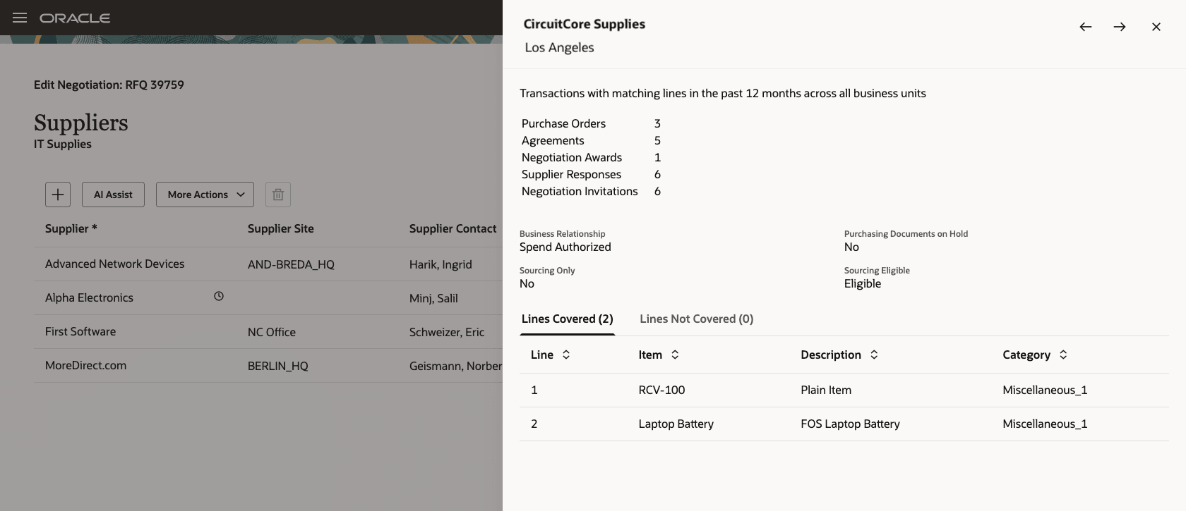

You can also review information about the supplier including past transaction summaries for the negotiations lines, which drive the AI suggestions.

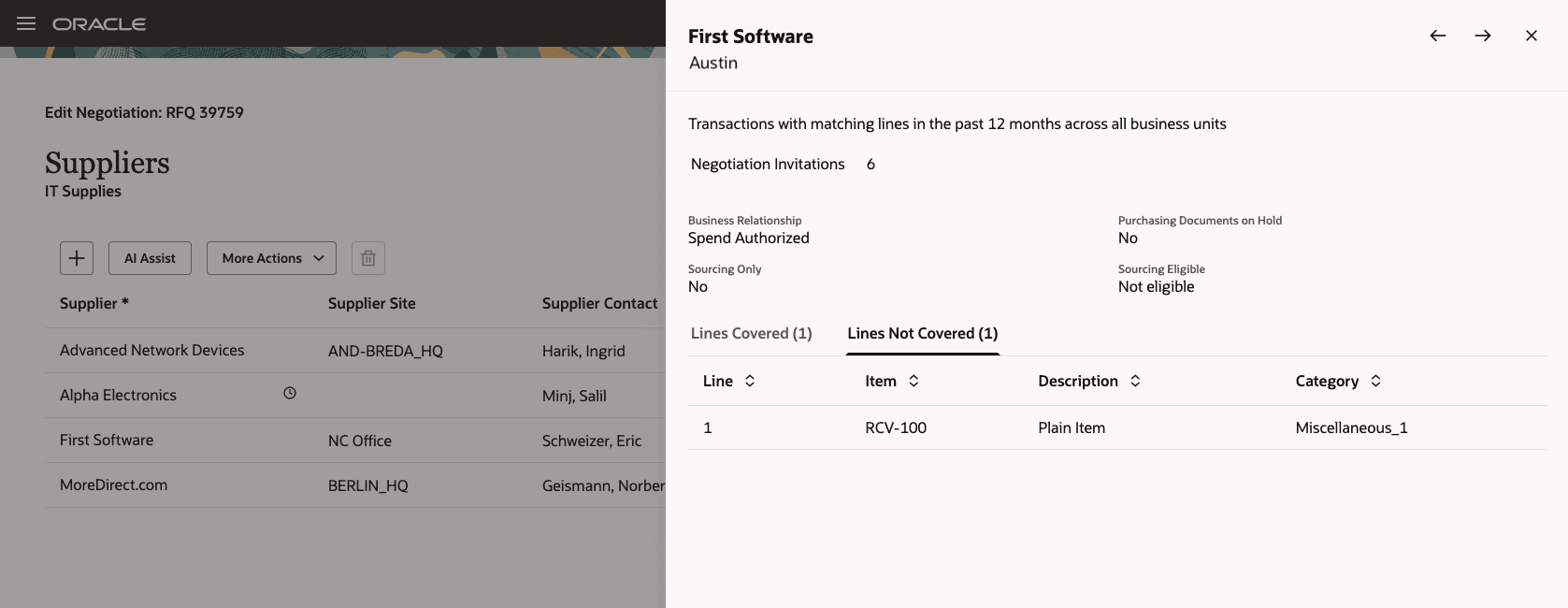

Negotiation lines not covered by the suggested supplier
Negotiation Lines not Covered by the Suggested Supplier
Any negotiation lines that weren't matched to the supplier are shown under the Lines Not Covered for quick review.

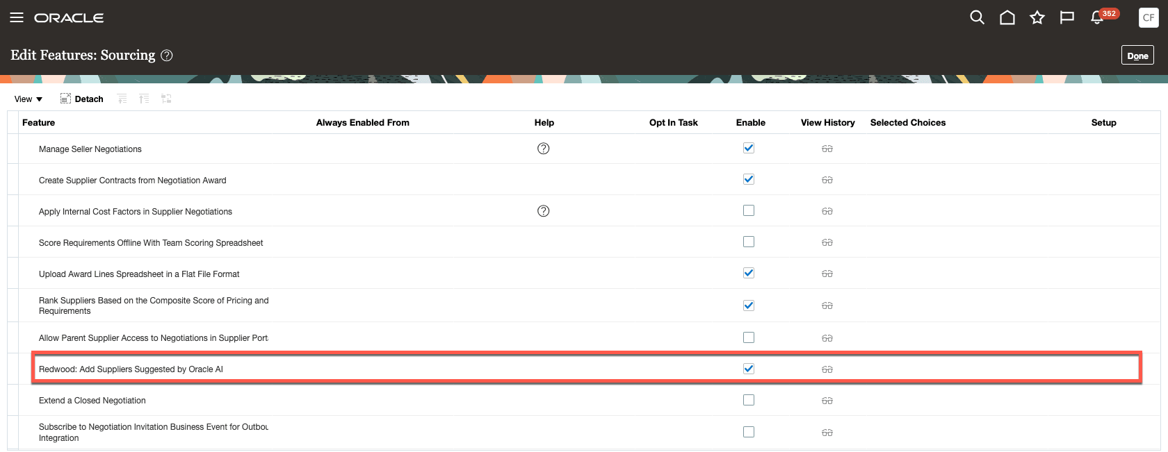

Use the Opt In UI to enable this feature. For instructions, refer to the Optional Uptake of New Features section of this document.
Offering: Procurement
You can enable this feature with opt in, Redwood: Add Suppliers Suggested by Oracle AI.
Enable Redwood: Add Suppliers Suggested by Oracle AI
Opt in to Enable Redwood: Add Suppliers Suggested by Oracle AI

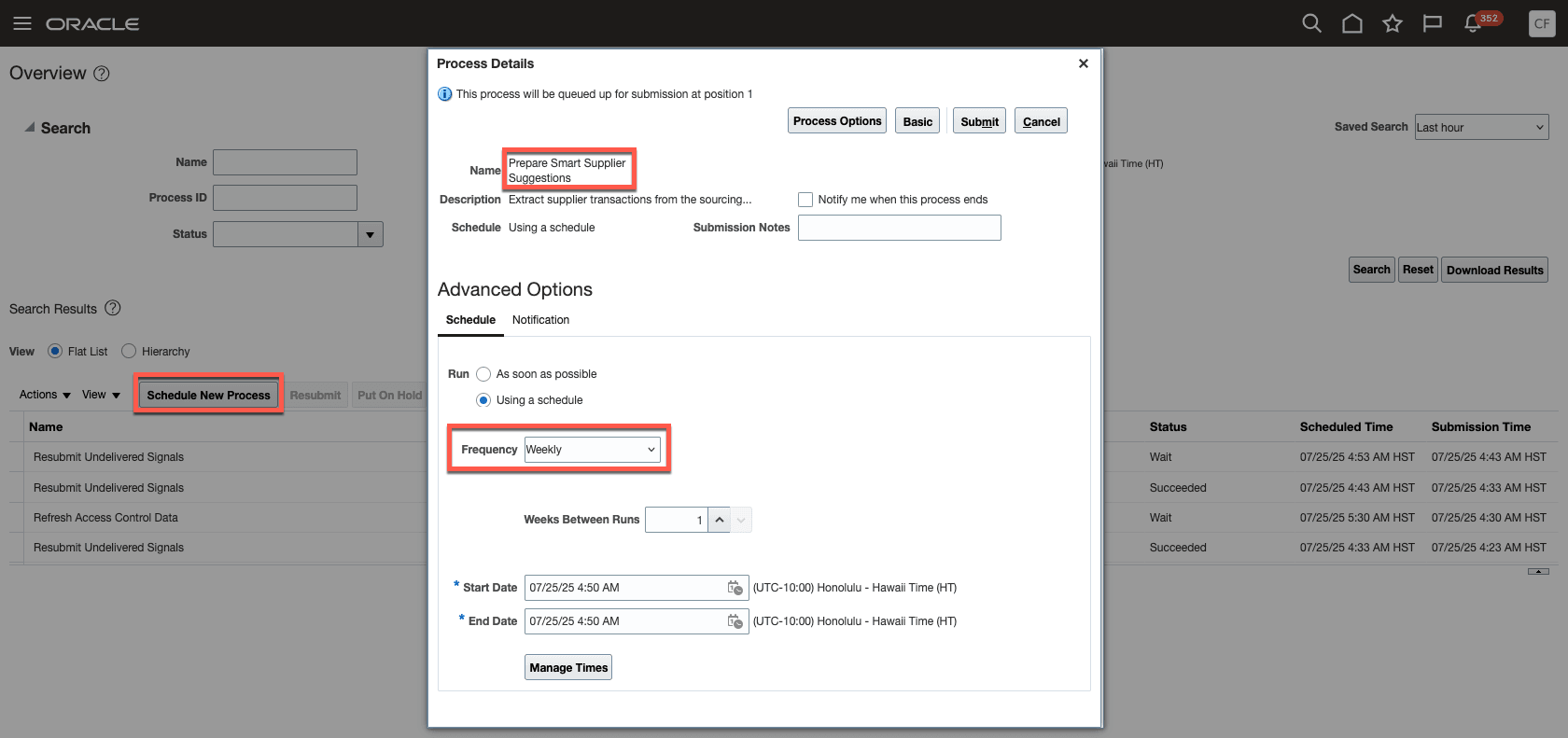

Run the Prepare Smart Supplier Suggestions ESS job to extract historical transactions and train the AI Model to provide supplier suggestions.
Schedule ESS
Schedule Prepare Smart Supplier Suggestions ESS Job

  • Run the Prepare Smart Supplier Suggestions ESS job once initially to train the AI model and enable supplier suggestions in the application. After this, supplier suggestions will remain available as the AI model is periodically retrained on new transactions.
  • Configure the ESS Job frequency in the Schedule in Advance Options to train the AI model periodically on the latest transaction based on your business needs.
