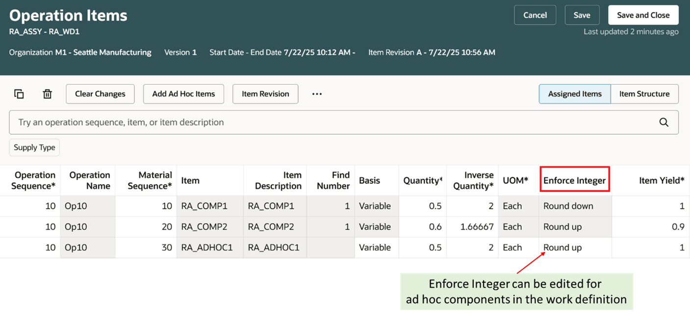

  • For the assembly RA_ASSY, two components RA_COMP1 and RA_COMP2 are defined in the Item Structure in Oracle PIM.
  • The enforce integer requirement for component RA_COMP1 is Round down, while for RA_COMP2 it is Round up. The component yield for RA_COMP2 is 0.9
  • When the work definition is created for the assembly in Oracle Manufacturing, it inherits the Enforce Integer policy for components. Enforce Integer is read only for the components inherited from the Item Structure.
  • An ad hoc component RA_ADHOC1 is added into the work definition. Enforce Integer can be edited for ad hoc components, and in this use case, it is Round up.
             Work Definition in Oracle Manufacturing

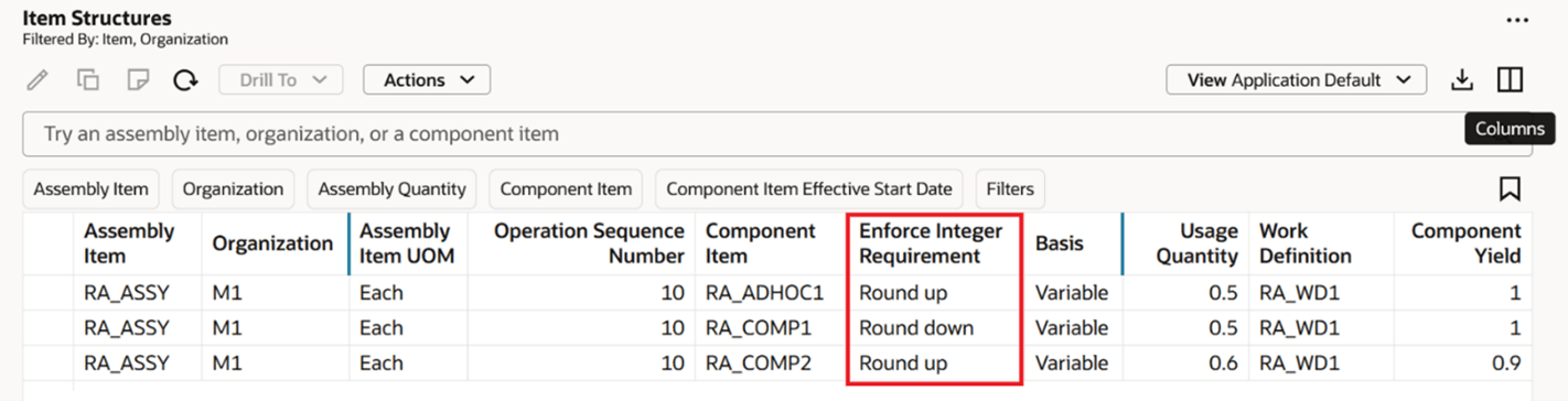

After the collections process in Oracle Fusion Cloud Supply Chain Planning, the components with enforce integer requirements can be seen in Item Structures as shown in the given screenshot.
  Item Structures in Supply Chain Planning

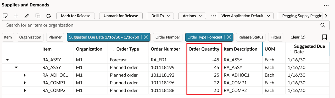

  • A supply plan is created with a forecast demand on assembly RA_ASSY of quantity 45. It generated a planned order of quantity 45 on RA_ASSY to satisfy the forecast.
  • The planned order on assembly is exploded to its components.
  • The usage of RA_COMP1 is 0.5 and enforce integer requirement is Round down. Supply Planning created the planned order demand as round down (45*0.5) =22, and a planned order for RA_COMP1 of quantity 22.
  • The usage of RA_COMP2 is 0.6, component yield is 0.9 and enforce integer requirement is Round up. Supply Planning created the planned order demand as round up ((45*0.6)/0.9) =30, and a planned order for RA_COMP2 of quantity 30.
  • The usage of RA_ADHOC1 is 0.5 and enforce integer requirement is Round up. Supply Planning created the planned order demand as round up (45*0.5) =23, and a planned order for RA_ADHOC1 of quantity 23.
                    Supply Plan Output
Supply Plan Output

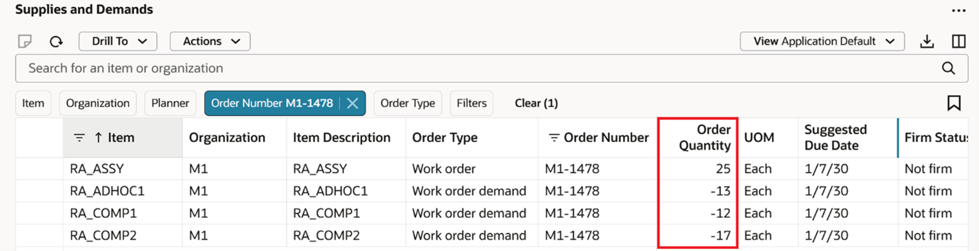

In this use case the set up remains same as of use case 1. A work order is created in Oracle Manufacturing for assembly RA_ASSY of quantity 25 and collected into Oracle Supply Chain Planning. Supply Planning collects the component requirements in their rounded integer quantities.
In this case, the usage of RA_COMP1 is 0.5 and enforce integer requirement is Round down. The work order demand is collected as round down (25*0.5) = 12. Similarly for component, RA_COMP2 the work order demand is collected as round up ((25*0.6)/0.9) = 17. For component RA_ADHOC1, the usage is 0.5 and enforce integer requirement is Round up, the work order demand is collected as round up (25*0.5) = 13.
  Work orders with Enforce Integer

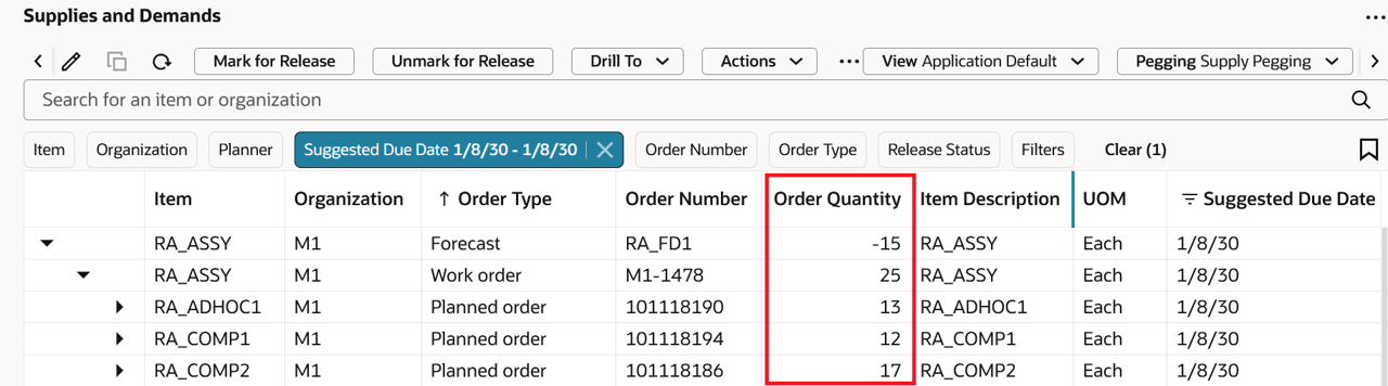

The work order is planned further in Supply Planning and planned orders are generated in integers for corresponding work order demands.
Work order in Supply Planning
