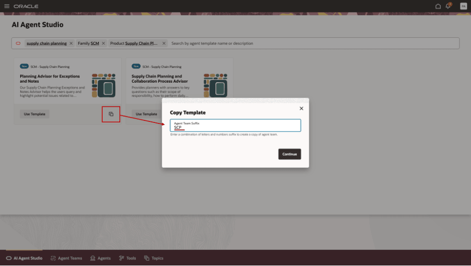

Copy Template
Copy Template

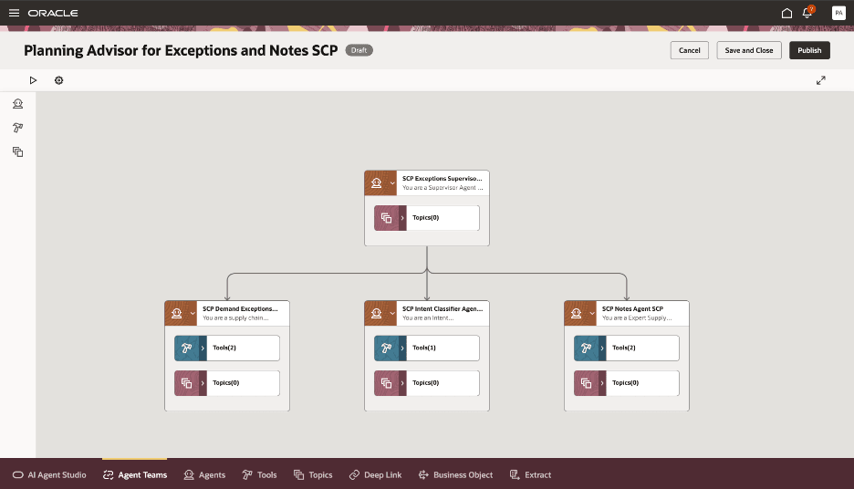

  1. Make a Copy of the template and customize the name of your Agent Team by adding a suffix. This will be added to the template defaults names in templates properties to distinguish it from others. Duplicate suffixes are not allowed. This action navigates you to the Agent Teams page which shows the graphical representation of the Agent team.
Agent team
Agent team
Each of these agents has an assigned role:
  • SCP Exceptions Supervisor Agent: A Supervisor Agent is part of a multi-agent Supply Chain Planning system. It manages and orchestrates exception-related queries from a planning user by routing them to the correct Exception Worker Agent.
  • SCP Demand Exceptions Agent: A supply chain planning Demand exceptions agent interacts with supply chain planners to give them insights about their plan's or item's demand exceptions.
  • SCP Intent Classifier Agent: An Intent Classification Agent specializes in understanding exception-related queries in the Supply Chain Planning domain. It analyzes the planning user input and returns a structured representation of what kind of exception the user is asking about, and for which item(s) or plan.
  • SCP Notes Agent SCP: A Supply Chain Planning AI Worker agent which can retrieve notes information for given plan name or item name from planners.

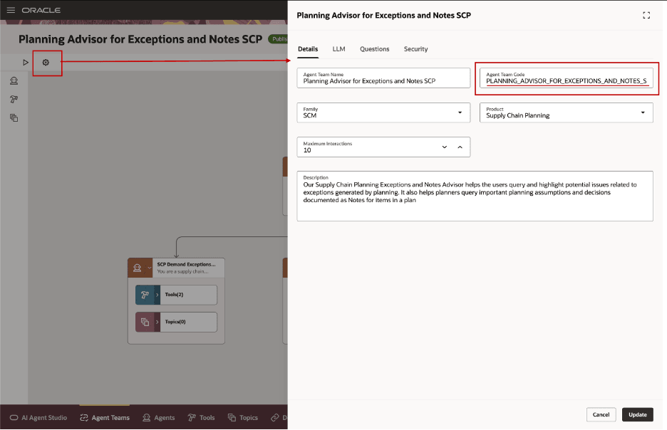

  1. Publish the Agent Team: Click on the Publish action button. The agent team is now available for use.
  2. Copy the Agent Team Code. Click on the Agent Team’s Settings Icon on the page header. This opens the property details of the agent team. Copy the agent team code. This will be used for adding the Planning Advisor action to your page.
Copy agent team code
This opens the property details drawer for the Agent Team. This is required to copy into the planning page as Visual Basic constant property to enable the Agent in the planning menu interface.

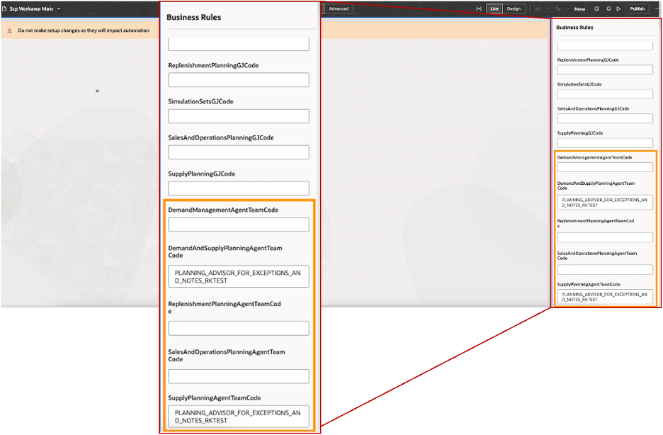

  1. Update the SupplyPlanningAgentTeamCode parameter in the User Profile: To make the Exceptions agent available in the user menu, the agent team code needs to be added to the user profile. To achieve this, do the following actions:
  • Go to the user interface’s ‘Edit Page in Visual Builder Studio’ under the Administration setting.
User profile option
User profile option
This will initiate the Oracle Visual Builder Studio in a new browser tab with the below settings.
Using Visual Basic Studio to set a constant: There are now two possible ways that the VB Studio in the new browser tab could appear.
If the Visual Basic Studio project has already been set up in the environment, all you need to do is set the constant values (i.e., as seen in the screenshot below, set the Agent Team code to the correct plan type constant).
The Agent Team Code is the code that needs to be entered into that constant parameter. Update the SupplyPlanningAgentTeamCode with the agent team code obtained in step 3.
After doing this, publish the changes. You will now be able to see the Planning Advisor in the menu with the menu option for the Exceptions agent.

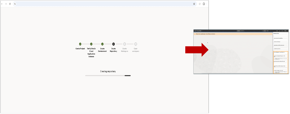

NOTE: If this is an environment where the VB Studio project has not been set up for “Edit Page”, you will be prompted to create new project, after which you will be taken to the VB studio setup page.
VB Studio setup message

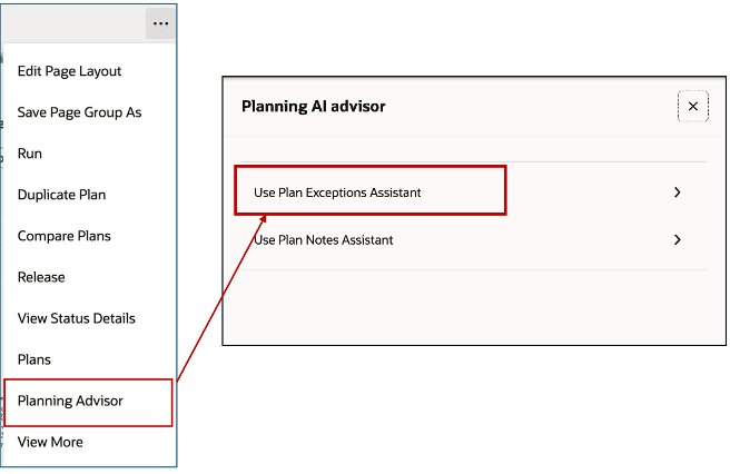

  • Reload the Redwood page. After reload, select the corresponding plan (of same type for which Agent Team Code was set)
Go to the menu at the top right -> then click on “Planning Advisor”
Planning AI Advisor menu

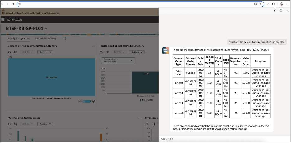

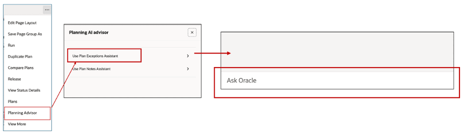

Accessing the Use Plan Exceptions Assistant initiates the agent interface. Clicking on “Use Plan Exceptions Assistant” or “Use Plan Notes Assistant” will open up the chat.
In the chat, you need not specify the plan name. As it has already been sent as context based on the currently open plan in the UIShell.
You are now ready to use the agent through a conversational interface.
 By allowing you to look into particular aspects of the exceptions, querying the demand exceptions agent accelerates the exceptions analysis process and helps you make crucial planning decisions faster, through a quick conversational experience.
Illustration of a user query and the Exception agent response

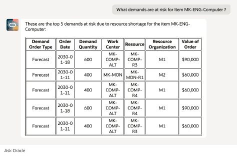

  • Item criteria: By including item-specific questions in the query.
    • For example, What demands are at risk for Item MK-ENG_Computer ?
Query response:
What are the demands at risk for item

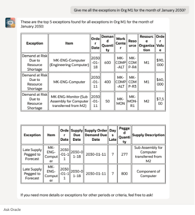

  • Criteria other than Item: By including two other non-item specific criteria such as organization, customer, exception type or dates in the query.
    • For example, Give me all the exceptions in Org M1 for the month of January 2030 ?
Query response:
Exceptions for a period

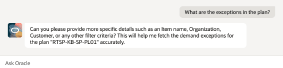

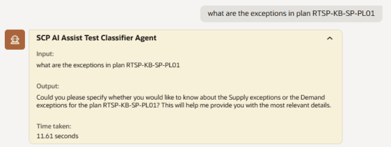

Queries that do not have specific criteria, prompt clarifying questions from the assistant, requesting more details to provide a response.
For example, Give me all the demand exceptions in the plan ?
This returns a message, "Can you please give more specific context like Item, Exception type, Organization, Date, Customer ?” to further refine the query.
