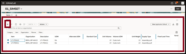

You can add or copy items to a simulation set by clicking the Add icon on the toolbar section of the Items table.
Items Table in Simulation Set

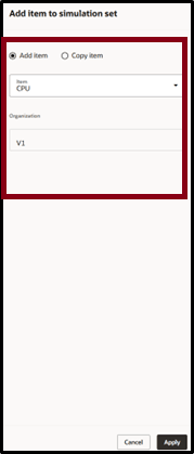

Adding an Item
- Click the Add icon on the toolbar. A drawer opens.
- In the drawer, select Add Item.
- Select the item and organization.
NOTE: You can’t add an item with that same name in a particular organization. You must either change the item name, select a different organization, or select a different item to copy.
Adding an Item
