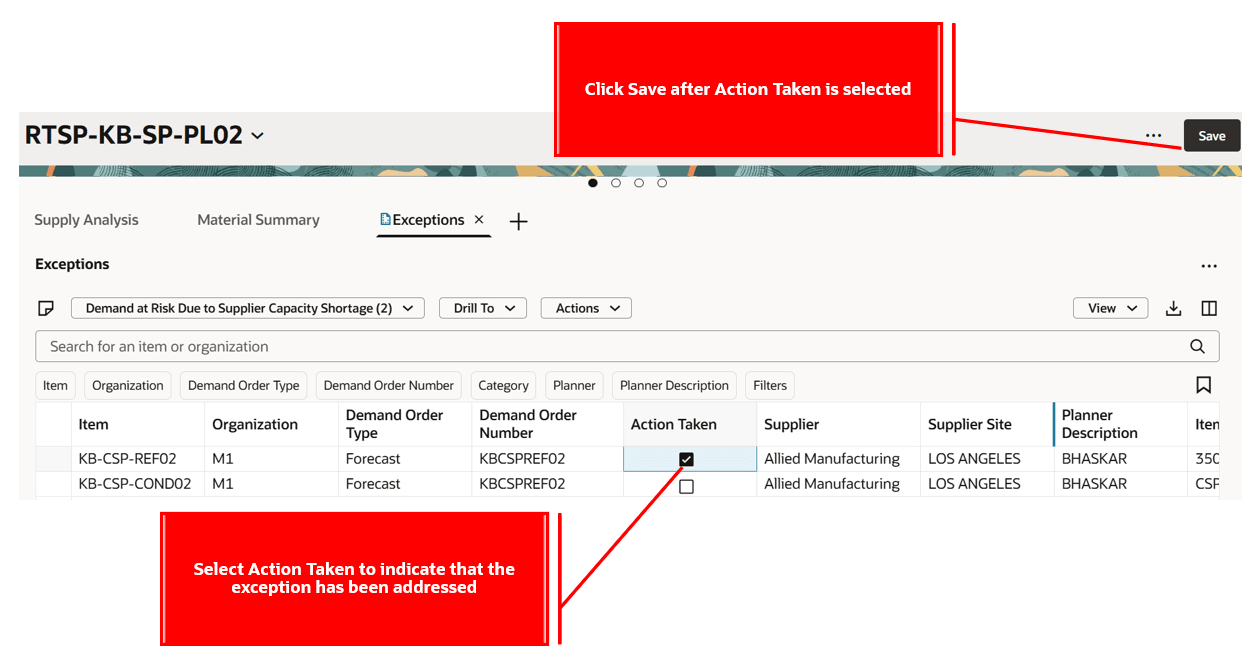

Action Taken
You can use the Action Taken checkbox to mark that an exception detail of an order-based exception has been acted upon. The Action Taken checkbox is applicable for supply plans and demand and supply plans.
To mark that an action was taken on an exception:
- Identify the order-based exception for which an action needs to be taken.
- Act on the exception. For example, add resource availability or supplier capacity, or address lead times.
- Select the Action Taken checkbox for the exception and click Save.
The following example shows the exception Demand at Risk Due to Supplier Capacity Shortage for item KB-CSP-REF02 from supplier Allied Manufacturing at supplier site LOS ANGELES. Once the planner has added supplier capacity and the forecast demand’s risk has been mitigated, the planner can select the Action Taken checkbox and click Save to record that the exception has been addressed.
Action Taken Checkbox Selected for an Exception Detail
