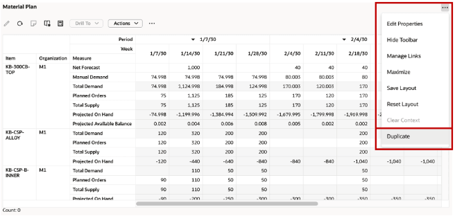

  1. On the page, click the Edit icon.
  2. From the menu options, select Duplicate. Depending on the type of visualization you are duplicating for, pivot table or graph, you will see a change in the visualization.
Duplicate Option
Duplicate Option
Note: You may need to make changes to the properties such as data, layout, and visualization of the visualization to make it suitable for your requirement.

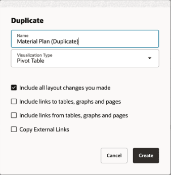

The Duplicate drawer opens.
Duplicate Drawer
Duplicate Drawer
  1. Enter a name. The name of the of the original table or graph is populated. By default, Duplicate is added to the original name.
  2. Select the visualization type you want to change to.
Visualization Type
Visualization Type
  1. Select the options based on your preferences:
    1. Include all your layout changes: Selected by default. Use this option when you want the duplicate to closely match the original but want to adjust only certain parts such as change the time bucket or add/remove a measure.This includes:
      • Selected measures and attributes
      • Filters and search conditions
      • Sorting and formatting
      • Time level selections
      • Column and row configurations
    2. Include links to tables, graphs, and pages: Select this option if the original component contains outgoing navigation links, such as drill-downs or links to other pages in the planning work area. Use this when you want the duplicate visualization to maintain the same navigation behavior.
    3. Include links from tables, graphs, and pages: Select this option to carry over incoming navigation links from other pages or components that direct users to this view. Use this when the duplicate visualization must also be a landing view in navigation flows, such as dashboard-style layouts.
    4. Include links to external systems: Select this option to retain any external hyperlinks. For example, links opening:
      • Oracle Cloud applications,
      • ERP and Analytical systems
      • Other external reporting systems
    5. Use this option when your analysis workflow depends on external references, and you want them fully accessible in the duplicate visualization.
Duplicate Options
Duplicate Options

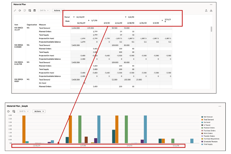

When you are changing the visualization from a pivot table to a graph visualization and if the pivot table has multiple dimensions, only one of them will be shown in the graph. You can change the graph’s properties in the edit properties options. In the given screenshot, the calendar dimension is the horizontal dimension after the transformation of the pivot table to a graph visualization.
Changing a Visualization from a Pivot Table to a Graph

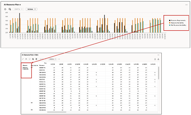

When you are changing the visualization from a graph to pivot table, the measures that are on the horizontal axis will appear as innermost rows in pivot table. This is the expected behavior. You can adjust the layout in the newly created pivot table’s layout properties. In the given illustration, the resource measures have transformed to the innermost rows in the pivot table.
Changing a Visualization from a Graph to a Pivot Table
