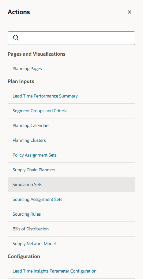

You can now use the Redwood user experience to view and make changes to Simulation Sets. You can access this page from the Supply Chain Planning work area when viewing a plan, plan inputs, or a simulation set. Open the action menu, click the View More action, and select the Simulation Sets link in the Plan Inputs section.

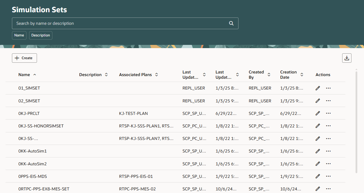

On the Simulation Sets screen, you can search, view, copy, edit, and delete simulation sets. You can open a simulation set in a new tab in the Supply Chain Planning work area.

Searching for Simulation Sets
  1. Keyword search: Use keywords to search for simulation sets based on the Name and Description columns. The search runs over the Name and Description columns using the contains operator and is case insensitive.
  2. Suggested filters: Use the suggested filters for column-specific criteria. For example, select the Name and Description suggested filters to view all the simulation sets based on the name and description. Press Enter or click outside of the suggested filter to update the table. The table displays only the rows that meet the current criteria.
Search Results
The search results table lists the simulation sets by name, a newly available description field, and includes a list of plans using the simulation set in their plan options configurations. The other columns display the user and the date that the simulation set was last updated or created. Each column can be sorted in ascending or descending order.

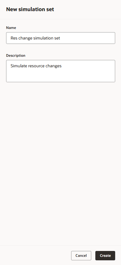

Creating a simulation set
  1. Click Create.
This opens the New simulation set drawer.
  1. Enter a unique name and an optional description.
    If the name of the simulation set already exists, an error message will be displayed.
  2. Click Create.
New Simulation Set
New Simulation Set
After you click Create, the new simulation is displayed in the list of simulation sets.

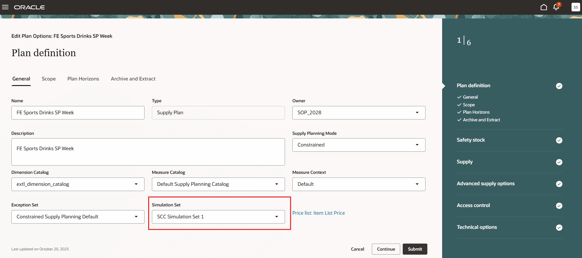

After you copy the data to a simulation set, you can run the simulation to verify your data by assigning this simulation to a plan in the Plan Options page of the plan. You can then run the plan with this simulation set.
