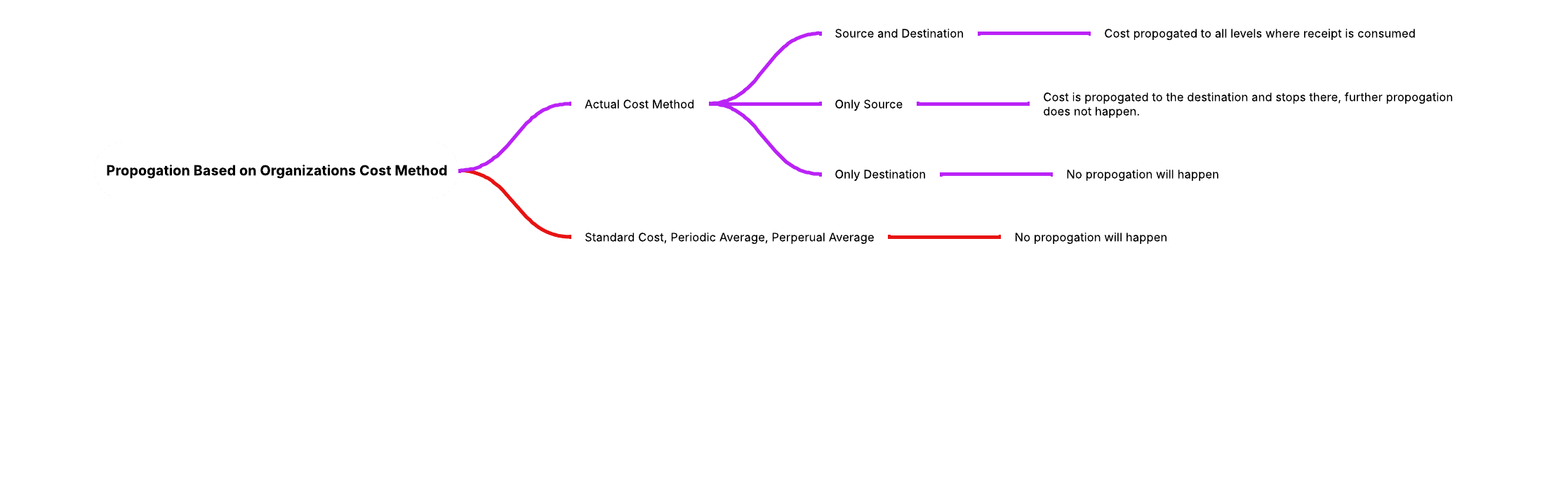

Cost propagation based on the organization's cost method
With this update, cost propagation is accurate across your inventory flows:
  • Supports both direct and in-transit inventory transfers within the same profit center business unit (PCBU).
  • Works for inventory as well as expense destinations.
  • Automatically propagates cost adjustments to projects and budgetary control for expense destinations.
  • Applies only when the source organization follows the actual cost method and cost propagation is enabled in the cost profile.
  • Updates both primary and secondary cost books when they share the same run control. If managed separately, only the linked book receives the update.

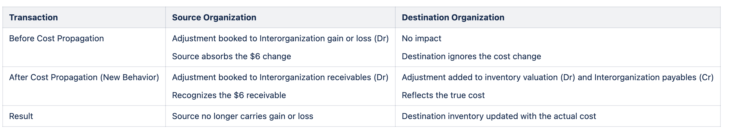

Distributions before and after cost propogation
Some of the benefits of this feature include:
  • Keeps inventory valuation accurate across all organizations.
  • Removes unrealized gain or loss from the source organization.
  • Ensures gross margins and financial reports reflect true costs.
  • Automatically updates projects, budgetary control, and COGS with the right values.
  • Gives better visibility into the real landed cost of inventory items.
