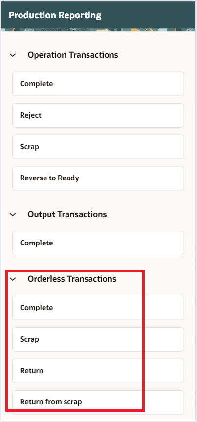

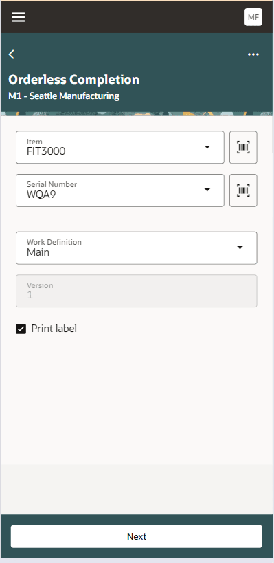

In high volume, lean environments, operators must efficiently report production completions without slowing down for administrative tasks. You can now report orderless completions, return, scrap, or return from scrap transactions using an industrial handheld device that uses barcode scanning from the Production Reporting page.
For Scrap and Return from Scrap, you need to provide a reason code. For serialized production, you can select a serial number to complete. You can also provide transaction notes and select the option to print the label.
Orderless Transactions Production Reporting Page
Scan or Search for Item Details for Orderless Transactions
Scan or Search Item Details for Orderless Transactions

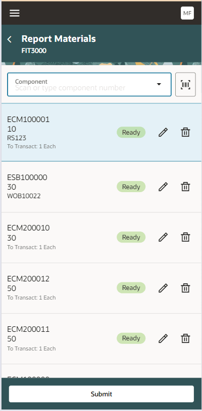

Material Issue during Orderless Transaction
Material Issue During an Orderless Transaction
