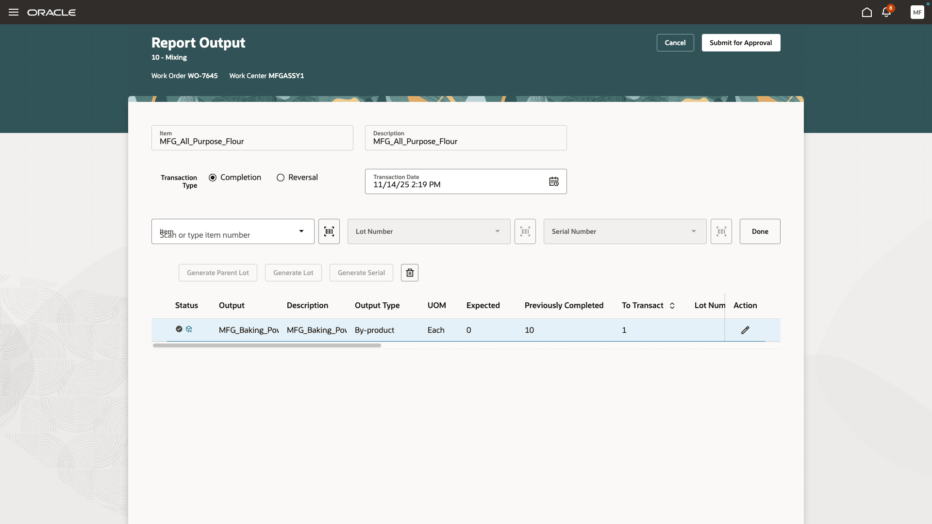

Operator Submits Output Transaction for Approval

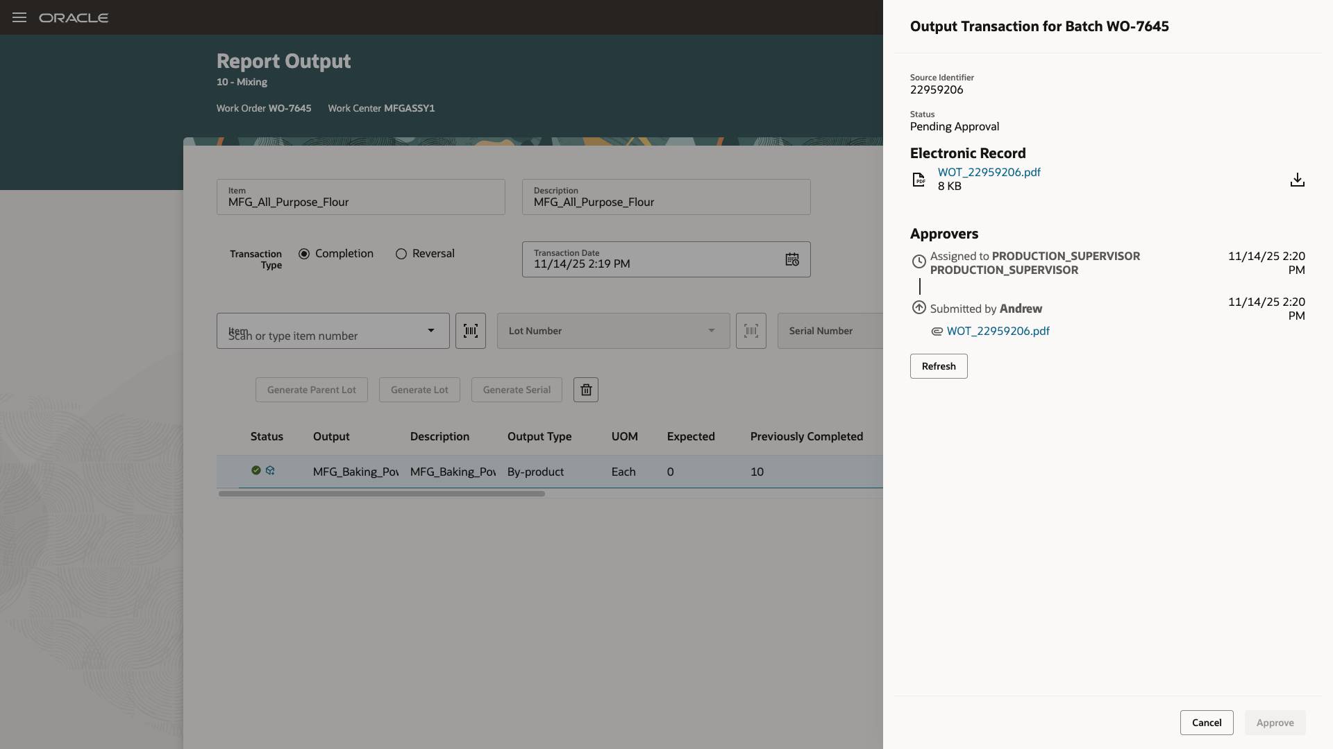

Operator Awaiting Approval for the Output Transaction

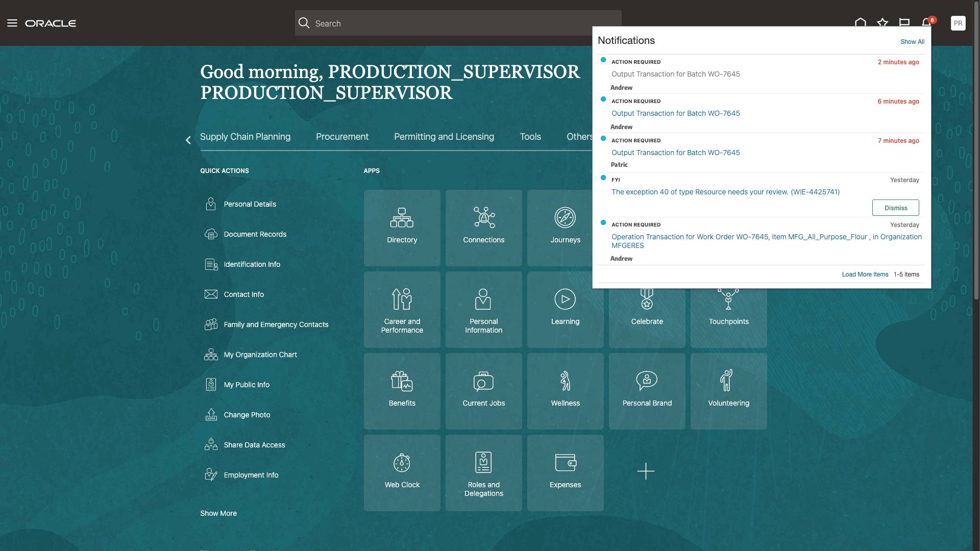

Approver Receives Notification for Approval of the Output Transaction

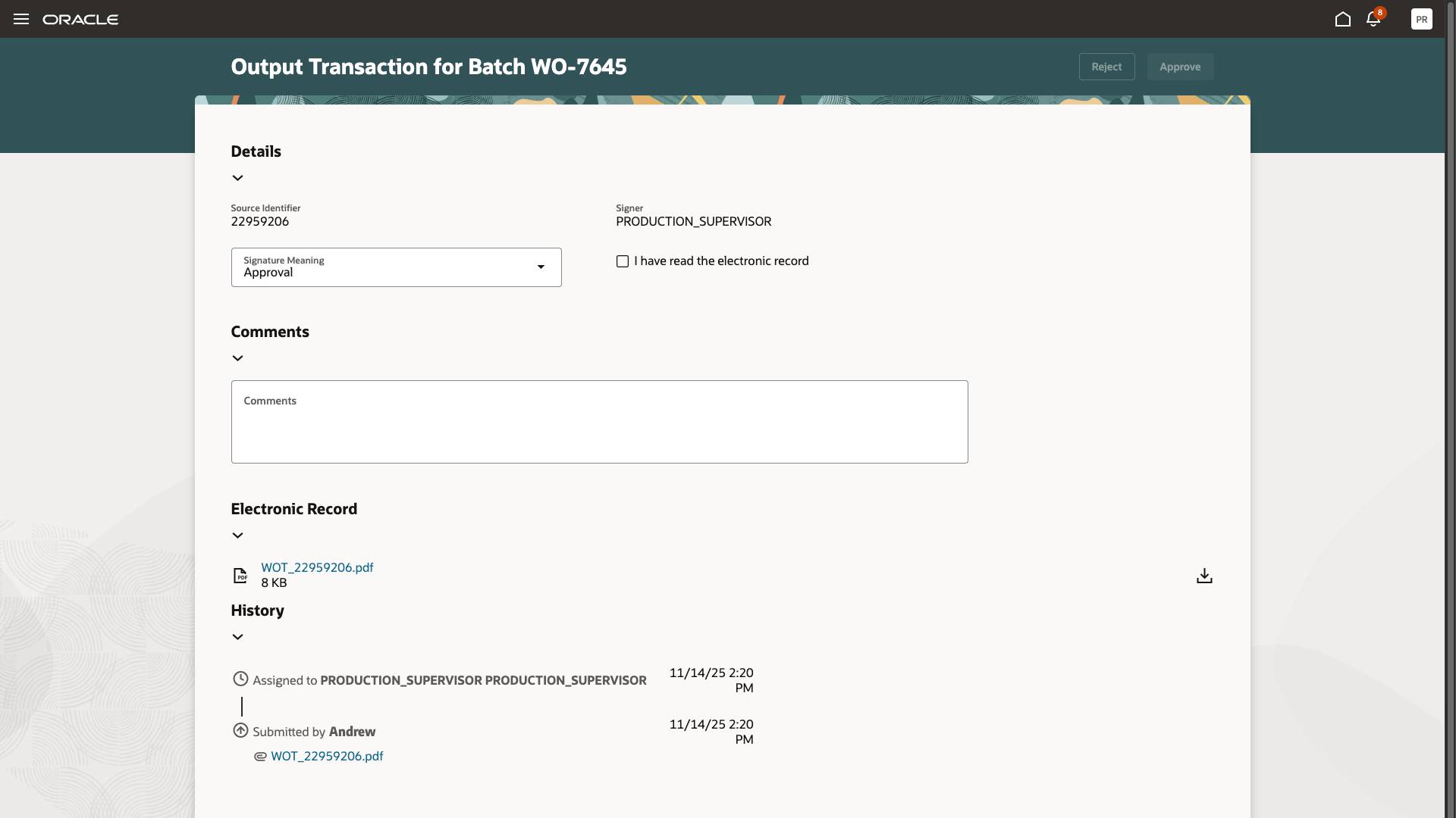

Approver Reviews Details of the Output Transaction
