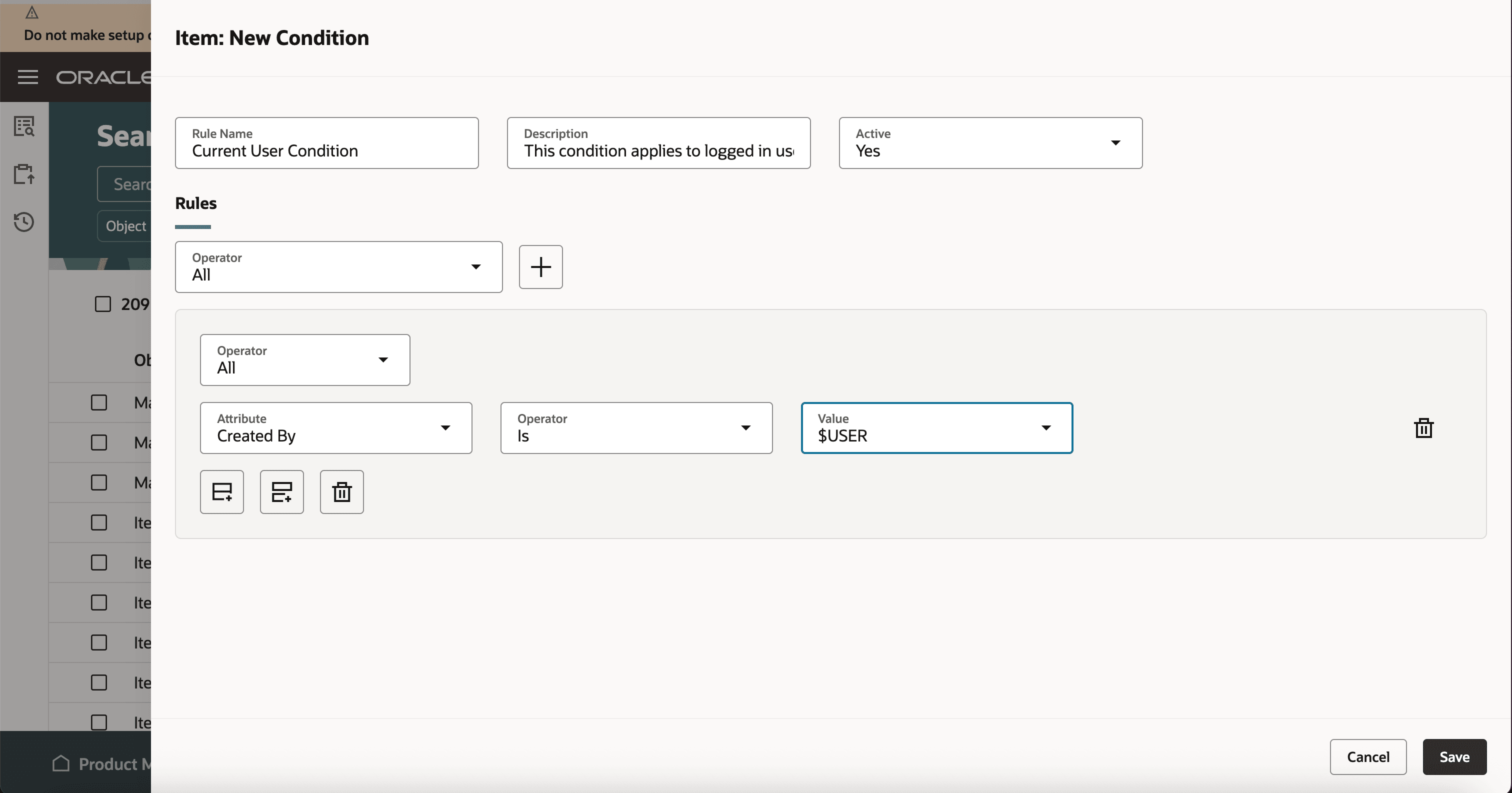

Variable Support
The enhanced Access Control List (ACL) allows evaluation of conditions based on the logged in user. The attribute Created By will now accept the variable $User. To enable this, select $User as the value for the Created By attribute when defining conditions for items or manufacturers. By setting a condition such as Created By = $User and assigning it to a permission set and team, you grant team members access to all items or manufacturers they've created.
Current User Condition for Items

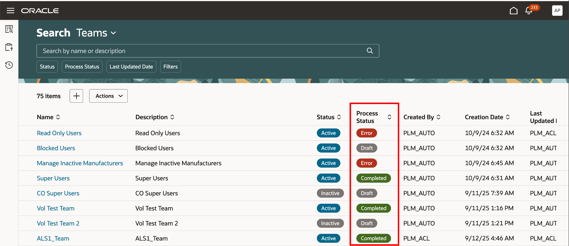

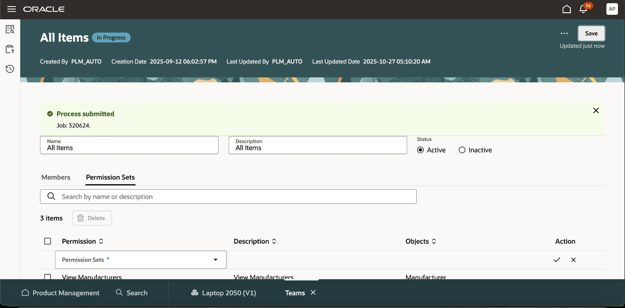

Team Indicators
Whenever you save changes to a permission set that is associated with a team or add or remove a permission set from a team, a scheduled job Refresh the Access Control List for the Teams runs to apply and update your security modifications. The Process Status indicator provides real-time information on the process. You can now easily track the status of this process using an indicator displayed on the Team page and the Teams search page. You can also filter your search results by the Process Status filter.
Indicators and their Significance:
  • Draft (Grey): Indicates that the team is inactive or doesn't have permission sets added yet.
  • In Progress (Blue): Shows that a scheduled process is currently running to apply updates made to team security.
  • Completed (Green): Confirms that the scheduled process is completed, security changes have been successfully applied and the team is ready for use.
  • Error (Red): Signals that the scheduled process has encountered an error. Administrators must then, manually run the Refresh the Access Control List for the Teams job for the affected team to apply the changes.
Team Process Status
Team Process Status
After saving the changes, such as adding a new permission set to a team or modifying an existing one, an information message will appear, showing the job ID of the submitted process. You can track the progress of this job on the Scheduled Processes page.
Message with Job ID of the Submitted Process
Users can also navigate to the scheduled process page for more information on security changes.

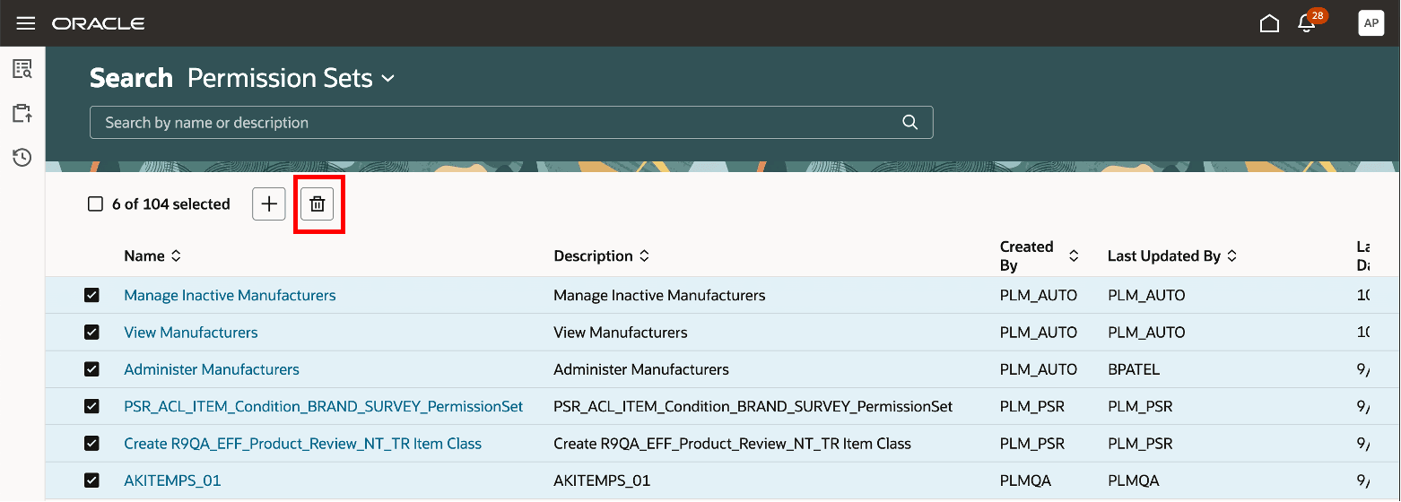

Delete Permission Sets
You can delete permission sets that aren't assigned to any teams. Here’s how:
  1. Permission Search Page: Select up to 25 permission sets directly from the search page and click the Delete button to remove them in bulk.
  2. Permission Details Page: Open the details page for a specific permission set and click the Delete button to remove it individually.
Delete Permission Set in Permission Set Search Page
You can also delete the conditions as it is already supported.

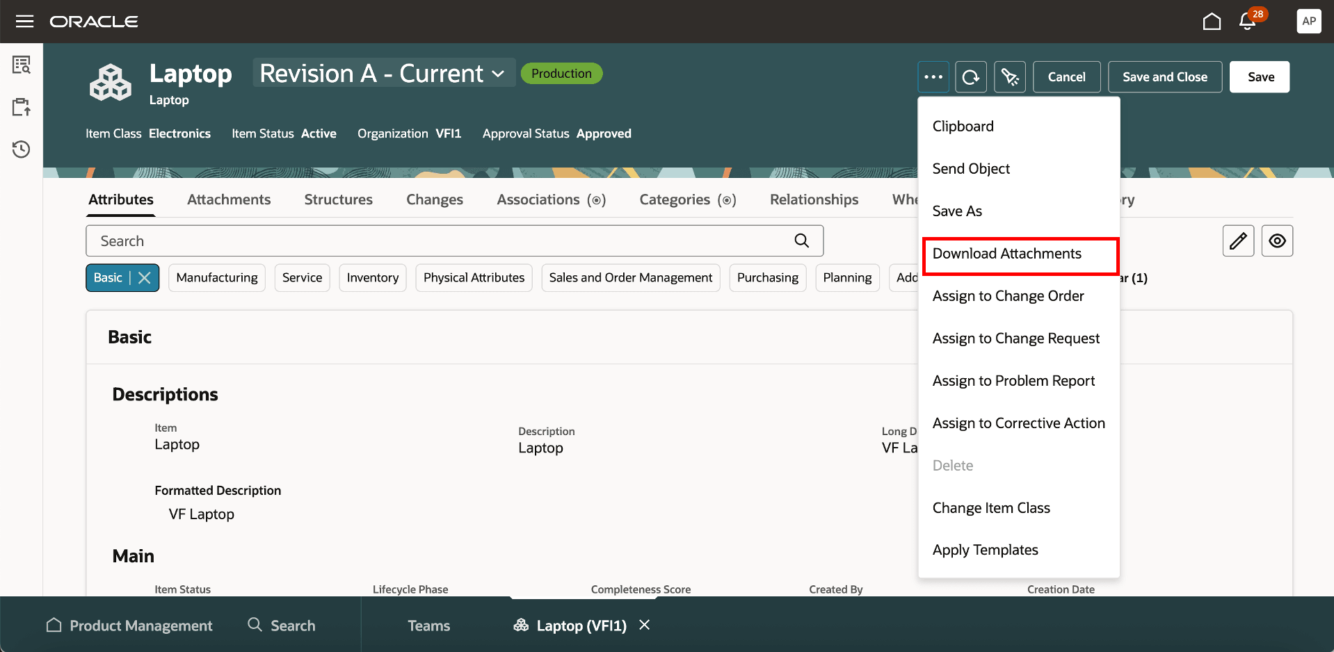

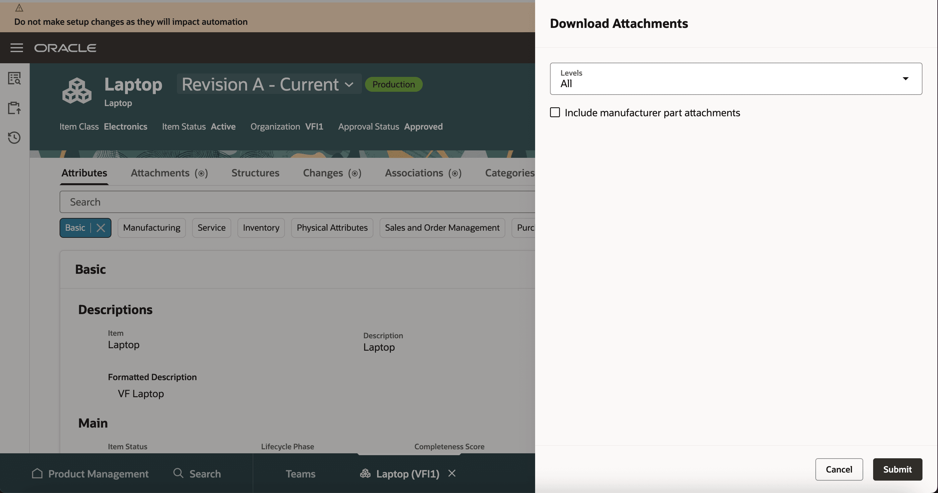

Download Attachments for Items:
Attachments added to an item are now secured by Item Access Control Lists.
Click More Actions > Download Attachments on the item page to download the attachments according to the security defined on the item. You can view the related data in the following table.
Download Attachment Option
Required Permission for Item ACL
Access To
Result
Single
View or Manage
Structure, Attachments
User can download and view attachments for the parent item and first level components
All
View or Manage
User can download and view attachments for the parent item and all structure components
Include Manufacturer Part Items
View or Manage
Structure, Relationships - Trading Partner Items
User can download and view manufacturer part attachments for the parent item and its structure components based on your selection - Single or All levels
Download Attachments in Item
Download Attachments in Item for All Levels

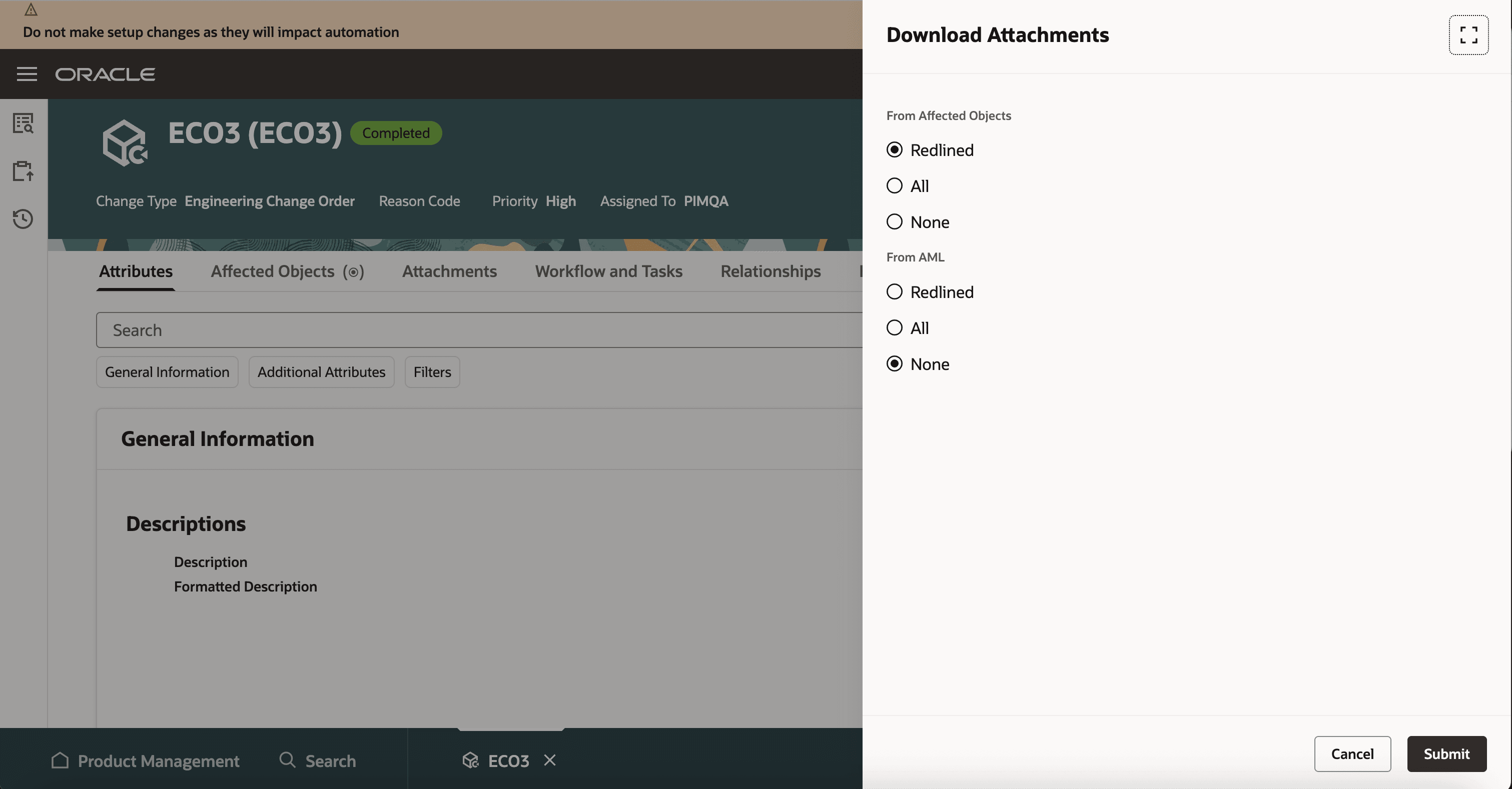

User must have the respective workflow privileges and permissions to download and view item attachments from the workflow.
Click More Actions > Download Attachments on the workflow page to download the attachments according to the security defined on the item. You can view the related data in the following table:

Download Attachments from an Engineering Change Order

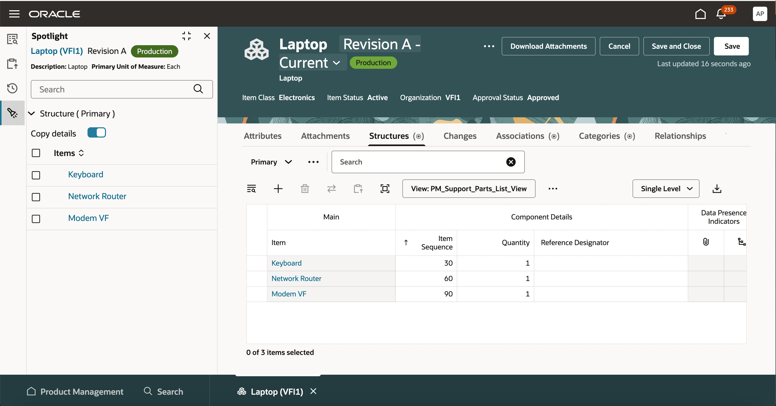

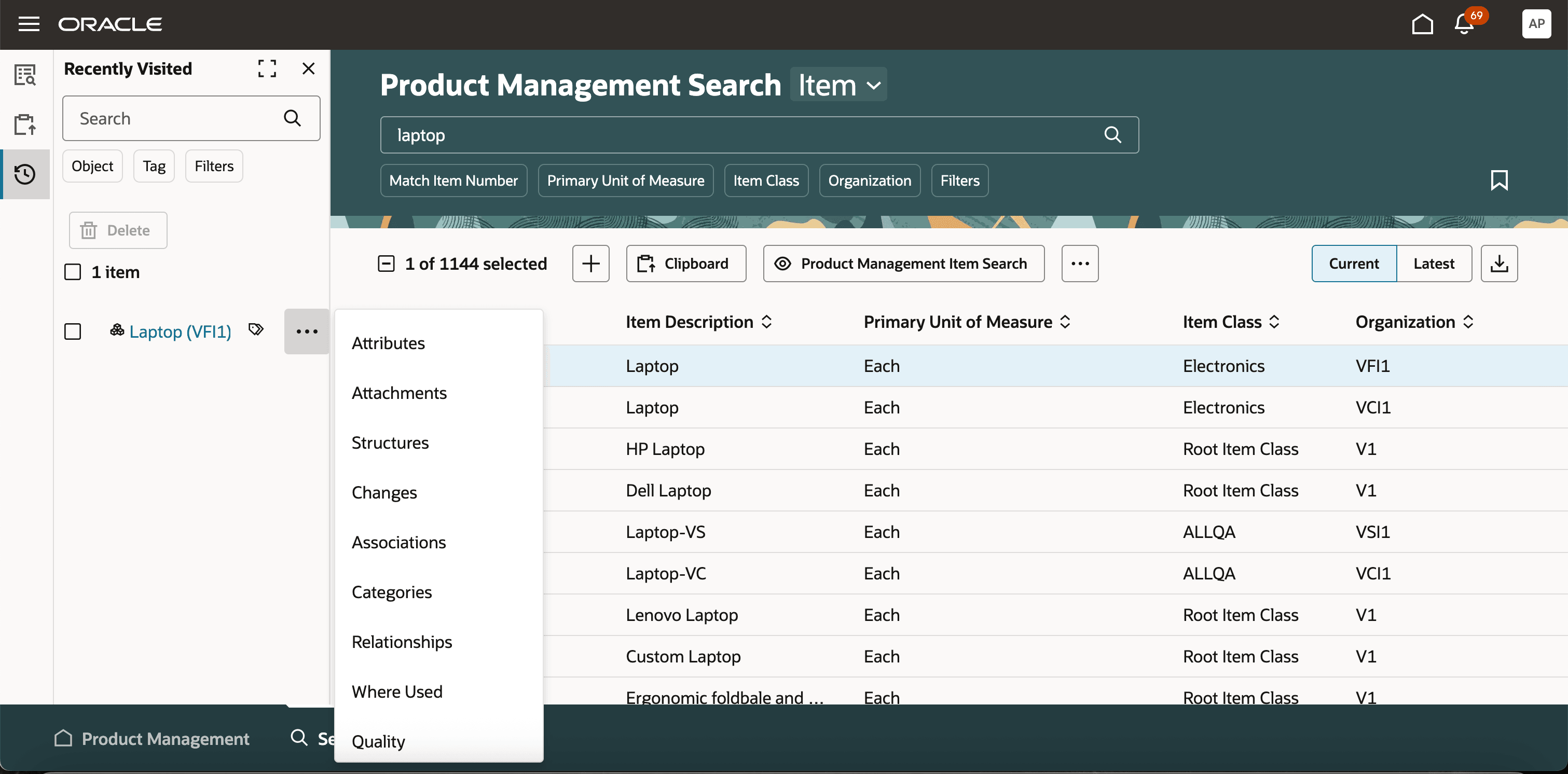

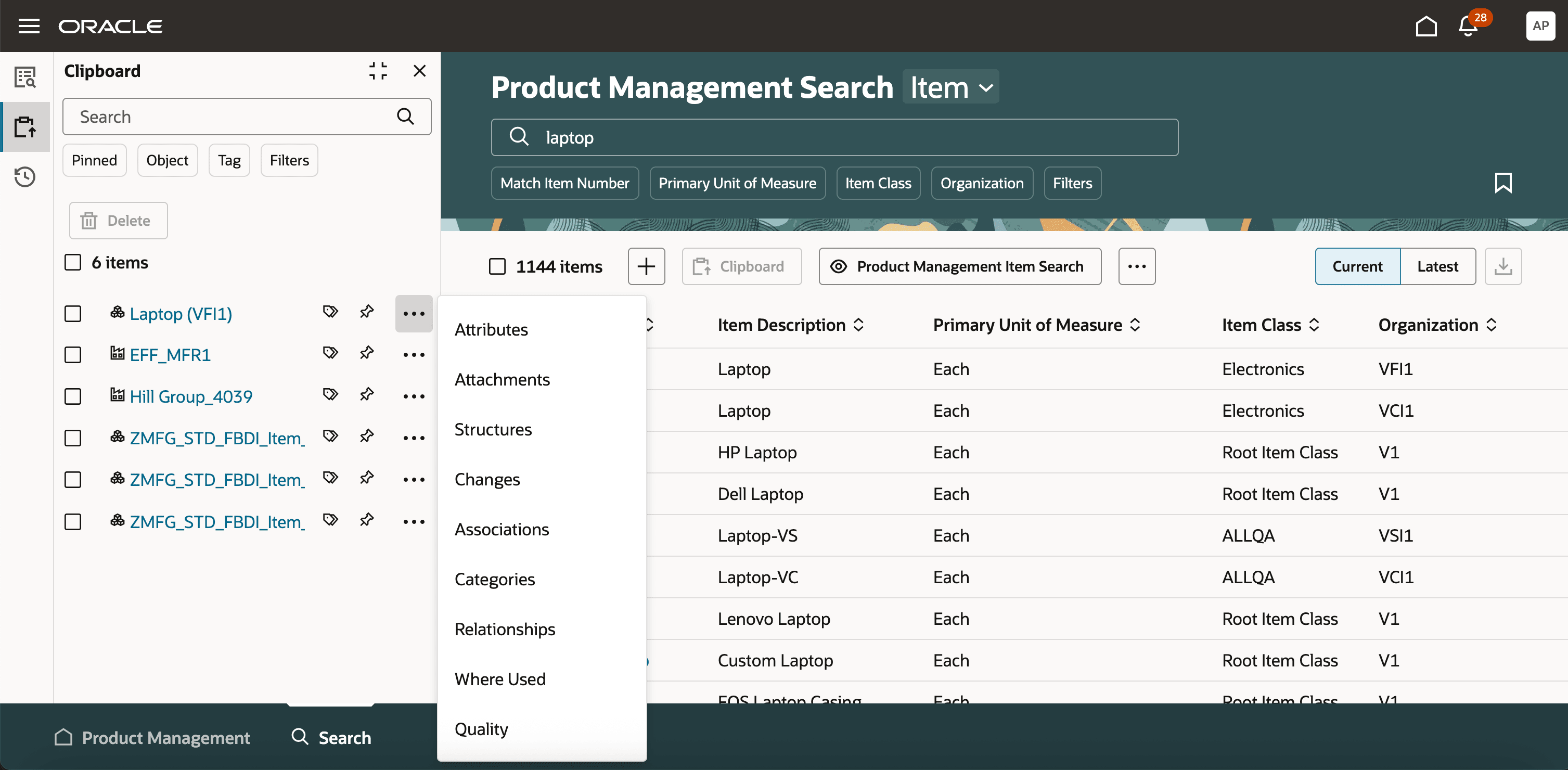

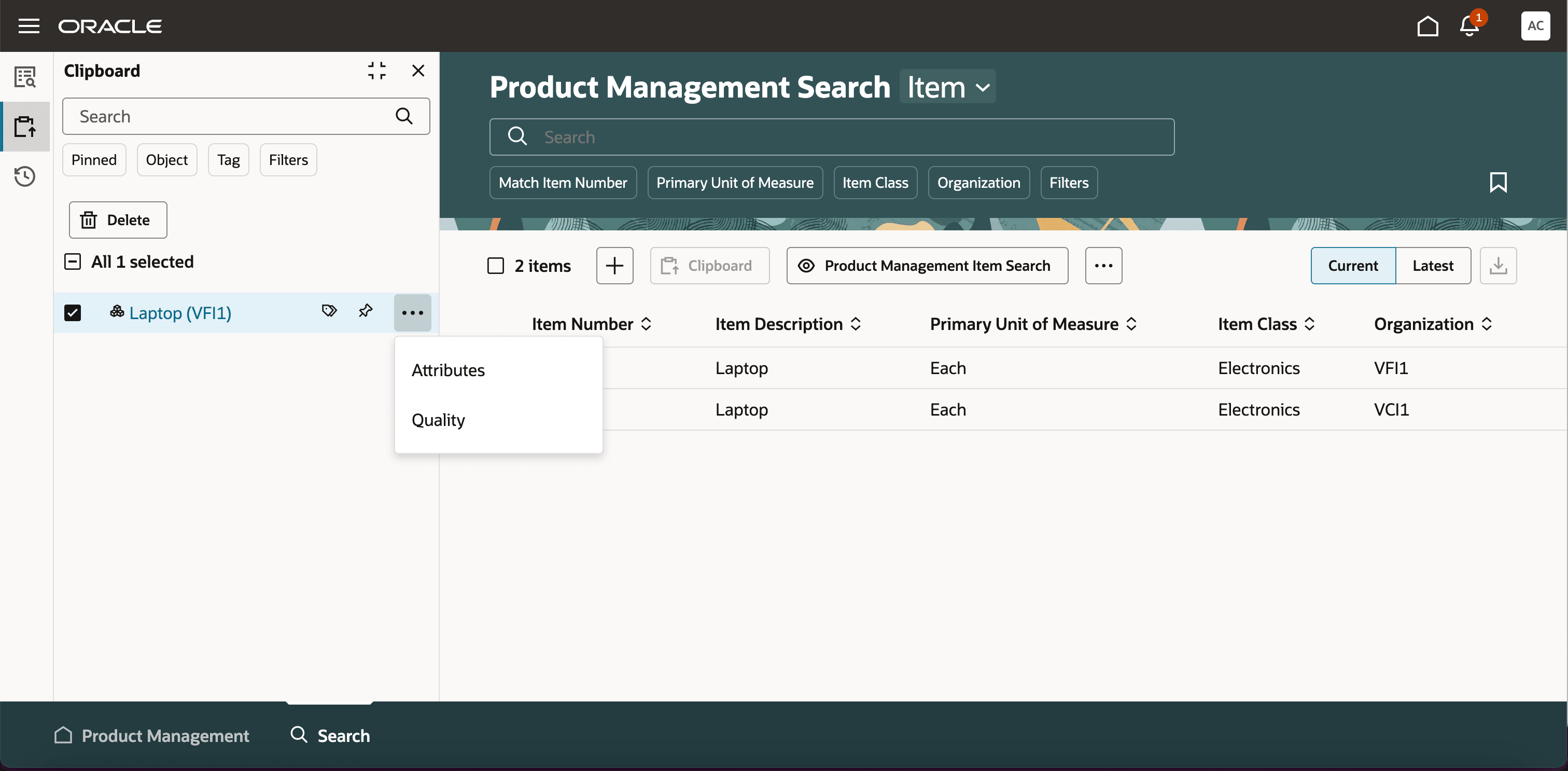

Clipboard, Spotlight, and Recently Visited for Items
Users can only add items to the clipboard and spotlight if they've View or Manage access to those items. From the clipboard, users can navigate to the various tabs of an item according to the permissions defined in the Item Access Control List. Users can view the items in the recently visited fragment if they've View or Manage permission on the item.
If users have access to all tabs, they can view the navigation options for each tab. If they’ve access to only certain tabs, they can view the navigation options only for those tabs.
View of Item Added to Clipboard with User Access to All Tabs
View of Item Added to Clipboard with User Access to Few Selected Tabs
Item Added to Spotlight
Item in Recently Visited

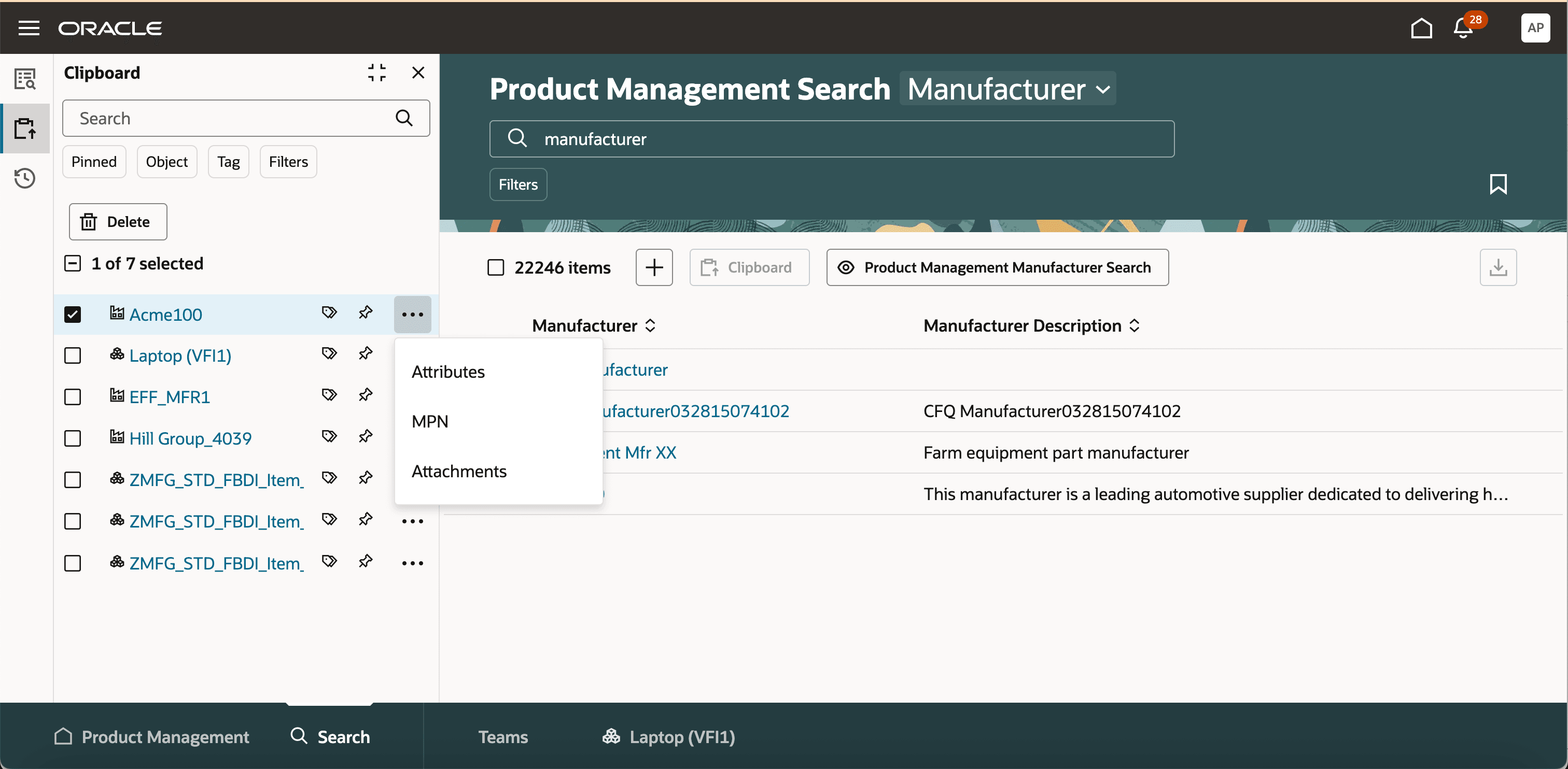

Clipboard and Recently Visited for Manufacturers
Users can only add manufacturers to the clipboard if they've View or Manage access to those manufacturers. From the clipboard, users can navigate to the various tabs of a manufacturer according to the permissions defined in the Item Access Control List. Users can view the manufacturers in the recently visited fragment if they've View or Manage permission on the manufacturer.
View of Manufacturer Added to Clipboard with User Access to All Tabs
