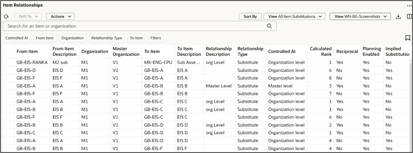

The Item Relationships page provides a single destination where you can view, analyze, and manage item relationships.

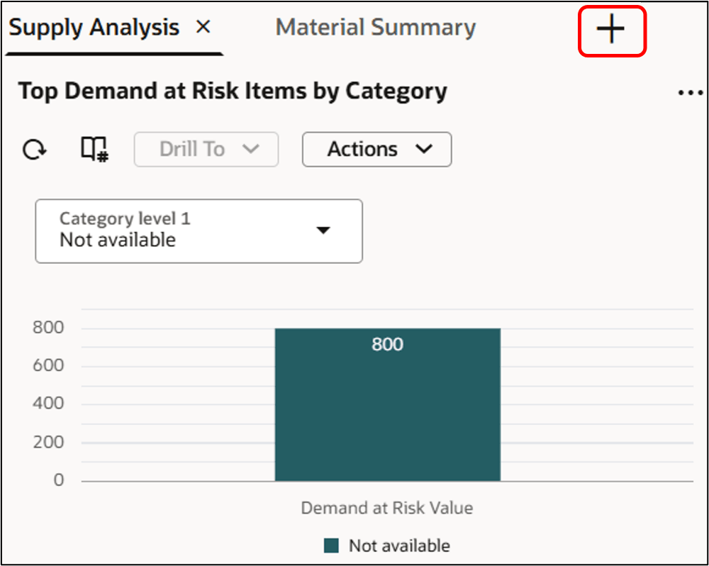

- Click the + icon to add more pages.
Click + to Add Pages

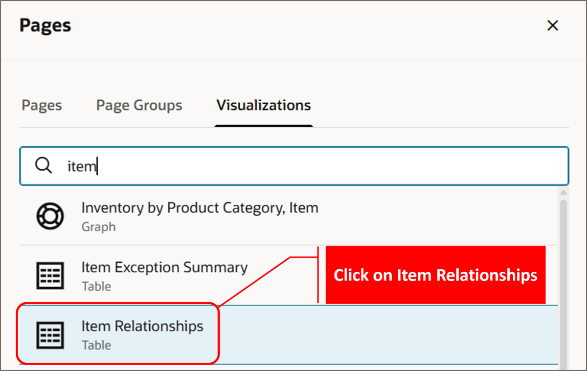

- Select the Visualizations tab.
- Search for and select Item Relationships.
Search for and Select Item Relationships
The Item Relationships page opens.
Item Relationships Page

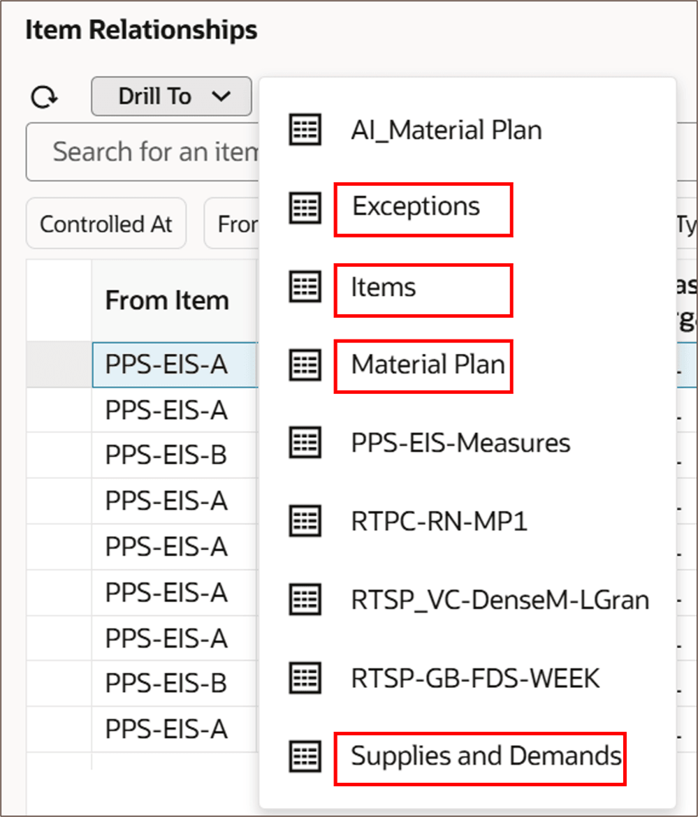

Drilling To and From Item Relationships
You can drill to Item Relationships from the following pages:
- Exceptions
- Items
- Material Plan
- Supplies and Demands
And you can also drill out from the Item Relationships page to these same pages, maintaining context and filter states for continuity in analysis.
In each case, the system passes the selected From Item, To Item, and Organization as context to the page being drilled to.
Drill To Other Pages

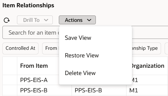

Actions
From the Actions menu at the top of the page, you can save, restore, or delete a view.
Save Page Layout by Using Save View
A view controls the page layout. You can change the page layout by adding, deleting, and reordering columns. You can save the revised layout with a name and description and specify if the layout is public or private. You can always restore to the Application Default layout. You can also delete your private layouts.

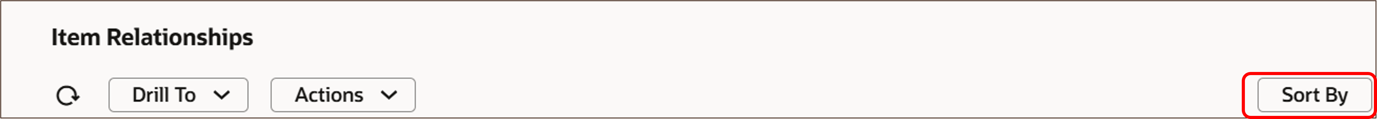

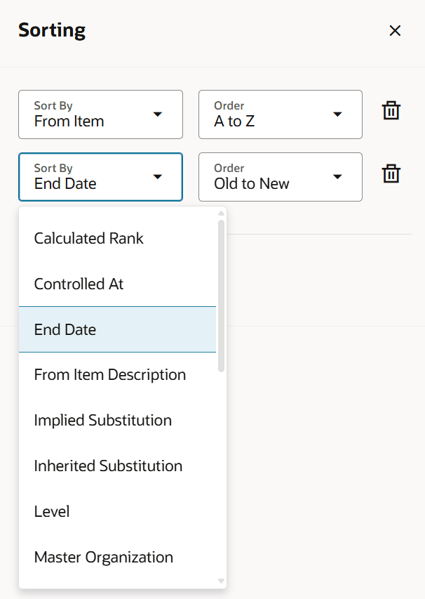

Sort by Specified Columns
You can sort the table view for multiple columns at once by clicking the Sort By button.
Click on Sort By to Sort Item Relationships View
This opens a drawer, where you can select the sorting order, such as A to Z or Old to New, for specified columns in the table.
Sorting by Specified Columns

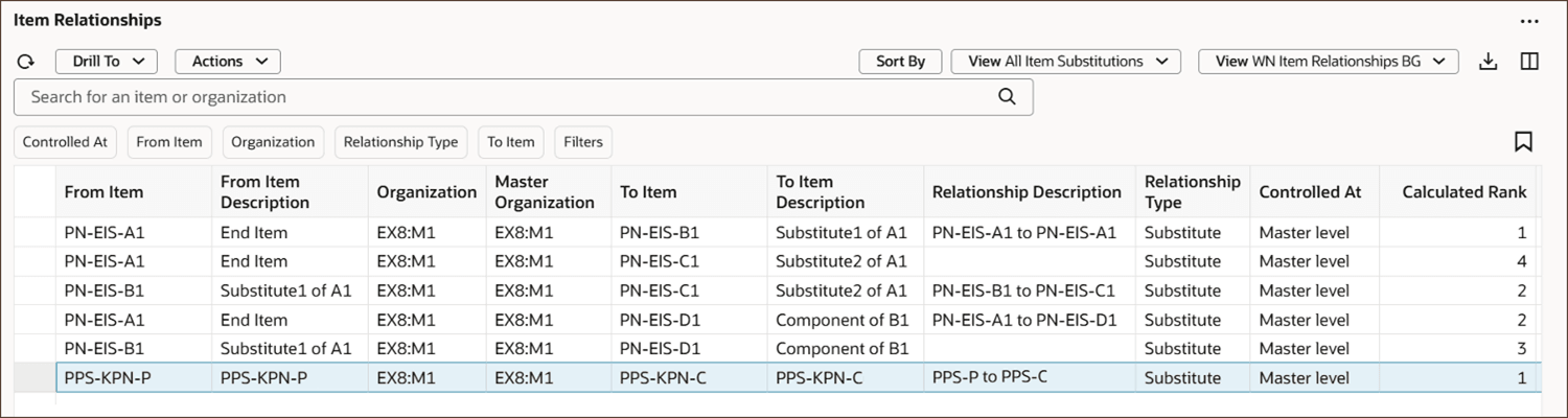

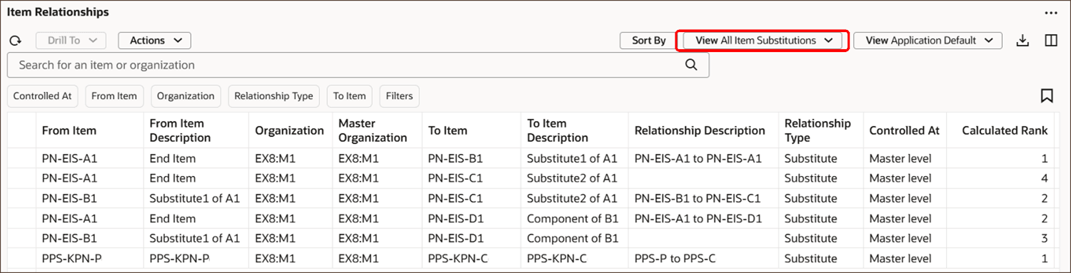

Options for Viewing Substitutions
The View menu at the top of the page displays two options for viewing substitutions in the table:
- All Item Substitutions
- Displays all item substitutions. This is the default value.

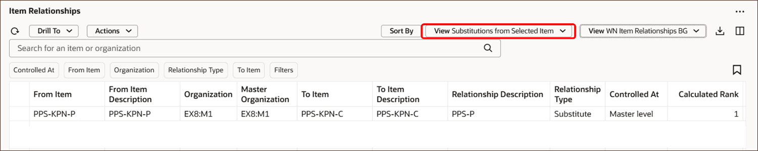

- Substitutions from Selected Item

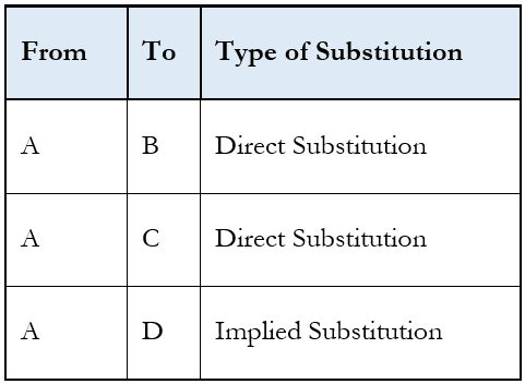

- Displays selected item substitutions. This option shows direct substitutions for the selected item, but also implied substitutions.

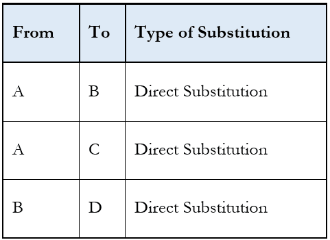

For example: Item A has 2 substitutes: Item B and Item C. Item B has 1 substitute: Item D.
The All Item Substitutions option displays:
The Substitutions from Selected Item option displays:
If you select All Item Substitutions from the View menu with no row selected, you’ll see results similar to the following:
View All Item Substitutions with No Row Selected
The following two images show the results when you select a row and then change the View option from All Item Substitutions to Substitutions from Selected Item.
Search Substitutions from Selected Item with One Row Selected
View Substitutions from Selected Item
Note: If you select multiple records in the preceding step, All Item Substitutions is displayed. This is the same as not selecting any row.

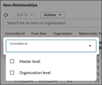

Controlled At Filter Chip: You can view item relationships by selecting Master Level, Organization Level, or both.
Select Master Level and/or Organization Level

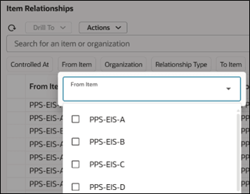

From Item Filter Chip: You can view item relationships by selecting one or more items from the list of values.
Select From Item from List

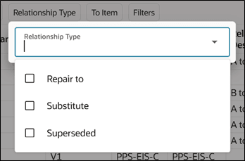

Relationship Type Filter Chip: You can view item relationships by selecting one or more relationship types from the list of values.
Select Relationship Type from List

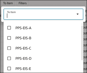

To Item Filter Chip: You can view item relationships by selecting one or more items from the list of values.
Select To Item from List

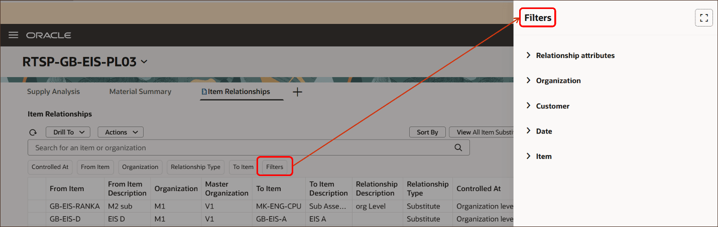

To access even more complex filtering capabilities, click on the Filters chip, which opens the Filters drawer.
Opening the Filters Drawer
The Filters drawer includes the following five filter groups to further refine the view.
- Relationship attributes
- Organization
- Customer
- Date
- Item
Click the arrow next to each group name to expand the group and select values for the desired fields.

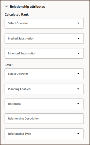

Relationship attributes: You can view item relationships by Calculated Rank and Level.
Relationship Attributes Used for Filtering Item Relationships
For more information about these attributes, see Respect Organization-Specific Item Substitution Rules.

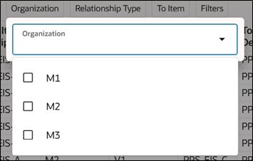

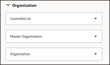

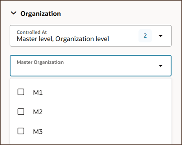

Organization: You can view item relationships by selecting whether the relationships are controlled at the Master level or the Organization level or both, and then select one or more organizations from the list of values.
Select Control At Master Organization, Organization Level, or Both
Select Organizations for Master Level or Organization Level

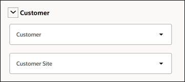

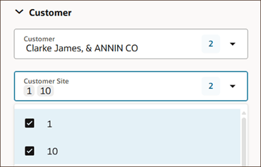

Customer: You can view item relationships by selecting one or more customers and their corresponding sites from the list of values.
Select Customers and Customer Sites
Select Customer Sites for the Specified Customer

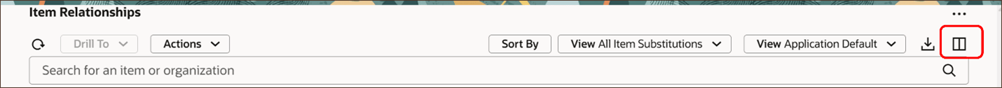

Note: Customer and Customer Site columns are available in Plan Inputs by default. You can add these columns in the Plans mode by using the column icon, highlighted in the following image.
Select Columns Icon

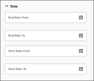

Date: You can view item relationships by selecting End Date and Start Date ranges from the list of values.
View Item Relationships by Date Ranges

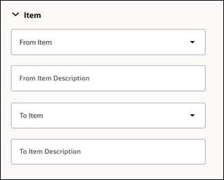

Item: You can view item relationships by selecting From Item and To Item ranges from the list of values.
View Item Relationships by From Item and To Item Ranges

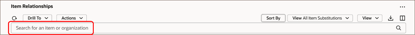

Default Search Behavior: The default search in the toolbar applies to both From Item and To Item as well as Organization and Master Organization.
Search Toolbar
