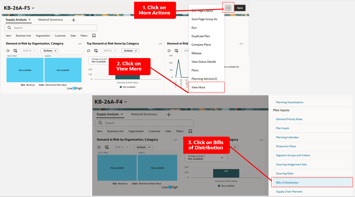

To access the Bills of Distribution page:
  1. Click the More Actions (...) icon and then click View More.
  2. In the Plan Inputs section, click Bills of Distribution.

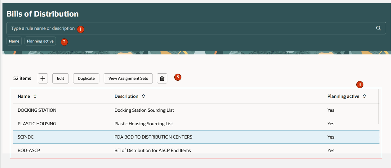

The Bills of Distribution page contains the following:
  1. Keyword search - Lets you search across the Bills of Distribution page. You can search by bill of distribution name or description. The search is case insensitive and performs a search using the contains operator.
  2. Suggested filters - Filters the Bills of Distribution page by Name and Planning active column details.
  3. Action toolbar - Enables you to create, edit, duplicate, or delete a bill of distribution. Also lets you view assignment sets associated with a bill of distribution.
  4. Bills of distribution - Displays a table showing the bills of distribution created on the page or collected using the file-based data import (FBDI) process.

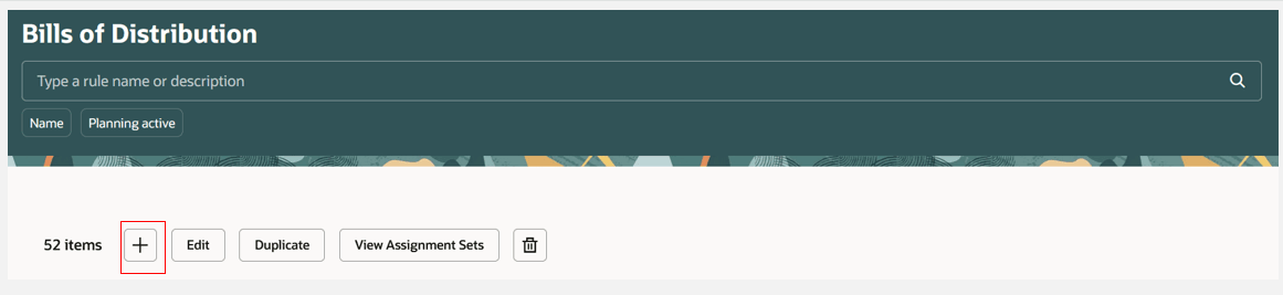

Create a Bill of Distribution
  1. Click the + icon on the Bills of Distribution page.

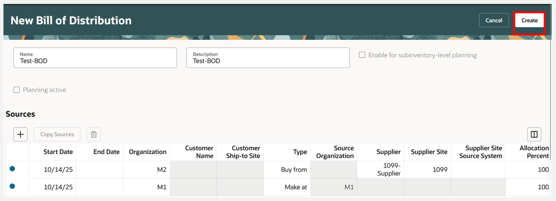

  1. A page named New Bill of Distribution opens on the same browser tab.
  2. Provide a name and description for the new bill of distribution and enter source and destination details. For information on adding sources to the bill of distribution, see "Bills of Distribution – Sources Section Details" later in this document.
  3. Click the Create button.

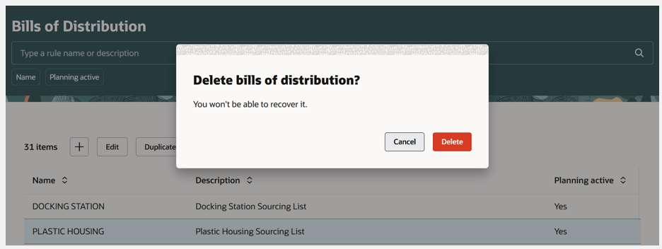

Delete Bill of Distribution
  1. Select a bill of distribution and click the Delete icon.
  2. A confirmation message appears. Click Delete to confirm that you want to delete the bill of distribution.

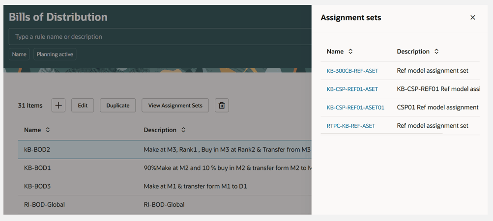

View Assignment Sets
  1. Select a bill of distribution and click the View Assignment Sets button.
  2. The Assignment sets drawer opens, displaying the assignment sets assigned to the bill of distribution. Assignment set names are displayed as hyperlinks.
  1. Click on the assignment set name to open the assignment set and review its details. The Assignment Set page opens in a new tab.

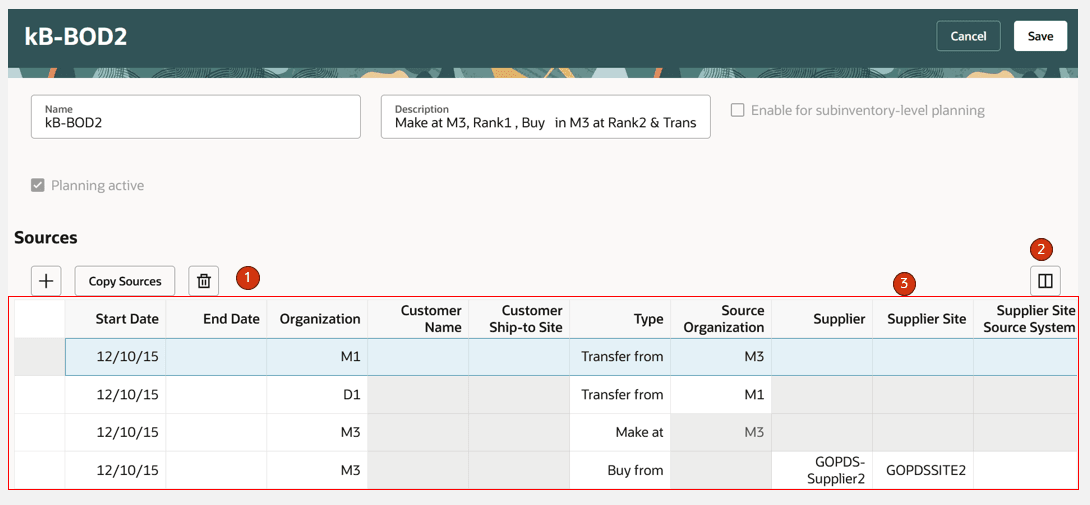

Let’s now understand the Sources section on the page.
Sources in Bill of Distribution
  1. Sources toolbar – Enables you to create, copy, and delete a source
  2. Manage columns – Enables you to manage columns displayed in the Sources section of a bill of distribution
  3. Sourcing details – Displays the details of the sources within the bill of distribution
Date effectivity (effective start date and effective end date) and organization are a part of each source row in the sourcing details region. Rows with identical date effectivities (same effective start and end dates) and organization are considered to be a related block of sources. When you change the effective start date, end date, or organization of one source in a block, then the effective dates and organization of the other sources in the block automatically change to match.
Within a block of sources, sources with the same rank must have allocation percentages that total 100.
  • To add a source:
  1. Click the + icon. A new source row is added at the beginning of the sourcing details region, with the Start Date defaulted to the system date.
  2. Update the Start Date and End Date as needed.
  3. Enter other source details.
  4. Click Save.
  • To edit a source:
  1. Select a source row and perform inline edits of the details.
  2. If needed, select another row and perform inline edits for that row. Repeat as needed.
  3. Click Save when done.
  • To delete a source:
  1. Select a source row.
  2. Click the Delete icon.

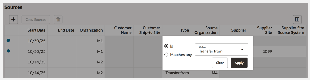

Column filters are ad-hoc filters that are appended to the keyword search and filter chips, allowing you to further refine your results. To access column filters, hover over the column header and click on the Filter icon.
Here’s an example of applying a column filter for Type in the sourcing details.
Column Filter for Type Column in Sources

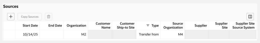

Result After Applying Column Filter for Type Column in Sources
