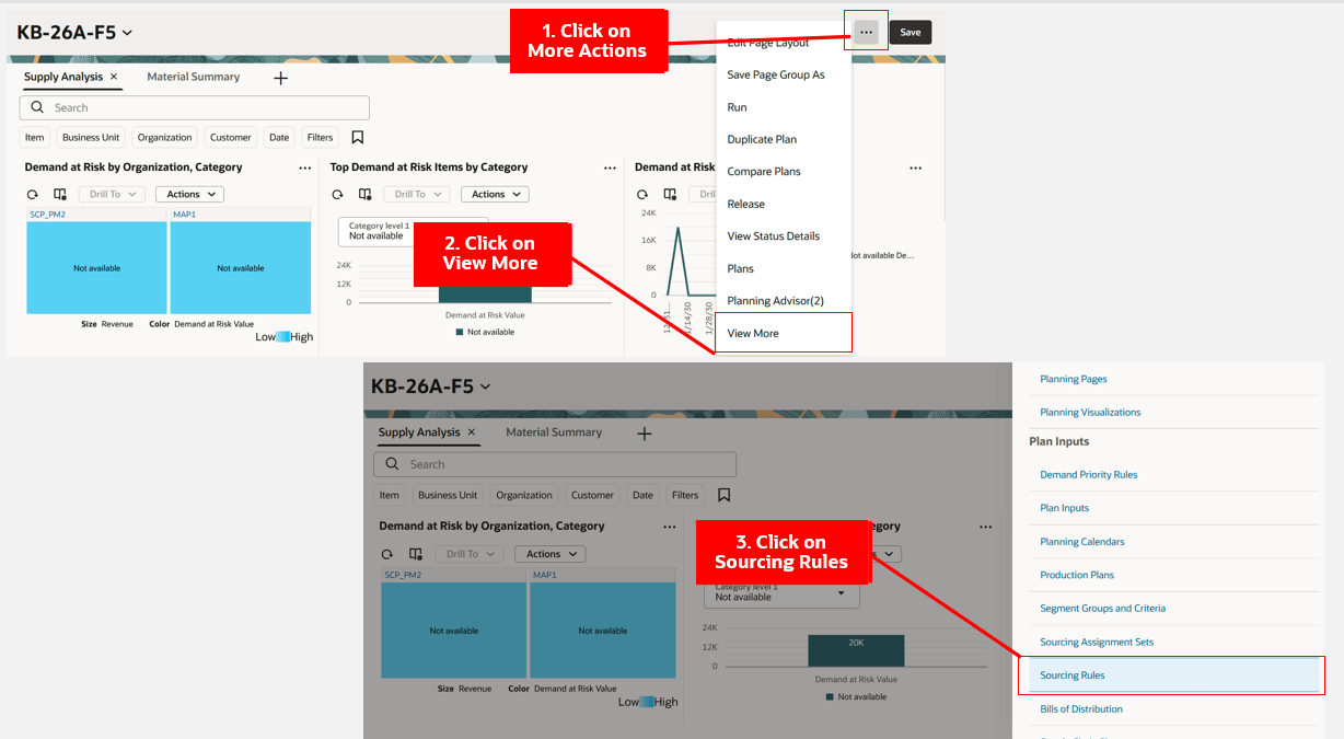

To access the Sourcing Rules page:
  • Click the More Actions (…) icon and then click View More.
  • In the Plan Inputs section, click Sourcing Rules.
  • The Sourcing Rules page opens in a new browser tab.

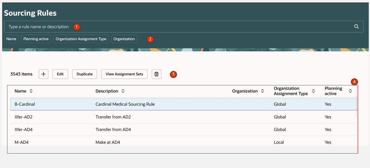

The Sourcing Rules page contains the following:
  1. Keyword search - Lets you search across the Sourcing Rules page. You can search by sourcing rule name or description. The search is case insensitive and performs a search using the contains operator.
  2. Suggested filters - Filters the Sourcing Rule page by Name, Planning Active, Organization Assignment Type, and Organization column details.
  3. Action toolbar - Enables you to create, edit, duplicate, or delete a sourcing rule. Also lets you view assignment sets associated with a sourcing rule.
  4. Sourcing rules - Displays a table showing the sourcing rules created on the page or collected using the file-based data import (FBDI) process.

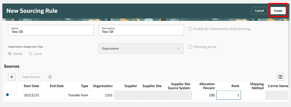

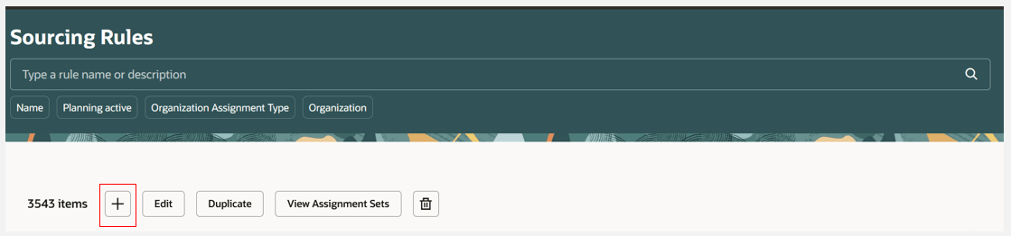

Create a Sourcing Rule
  1. Click the + icon on the Sourcing Rules page.
  1. A page named New Sourcing Rule opens on the same browser tab.
  2. Provide a name and description for the new sourcing rule and enter sourcing details. For information on adding sources to the sourcing rule, see "Sourcing Rules – Sources Section Details" later in this document.
  3. Click the Create button.
Click Create Button to Create a New Sourcing Rule
  1. The sourcing rule is now created.

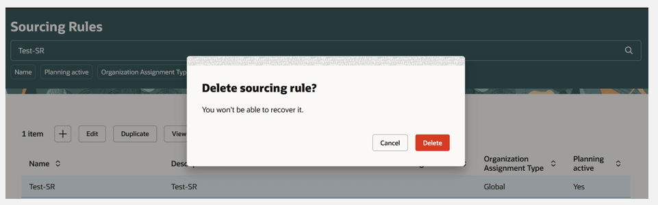

Delete Sourcing Rule
  1. Select a sourcing rule and click the Delete icon.
  2. A confirmation message appears. Click Delete to confirm that you want to to delete the sourcing rule.

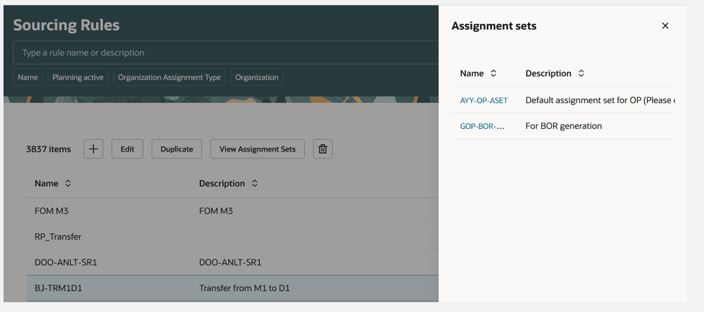

 View Assignment Sets
To view the assignment sets that contain a given sourcing rule:
  1. Select a sourcing rule and click the View Assignment Sets button.
  2. The Assignment sets drawer opens, displaying the assignment sets that contain the selected sourcing rule.
  1. Click on the assignment set name to open the assignment set and review its details. The Assignment Set page opens in a new tab.

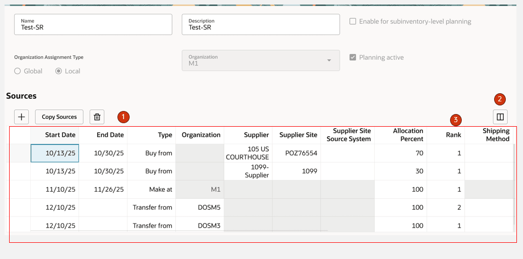

Let’s now understand the Sources section on the page.
Sources in Sourcing Rule
  1. Sources toolbar – Enables you to create, copy, and delete a source
  2. Manage columns – Enables you to manage columns displayed in the Sources section of a sourcing rule
  3. Sourcing details – Displays the details of the sources within the sourcing rule

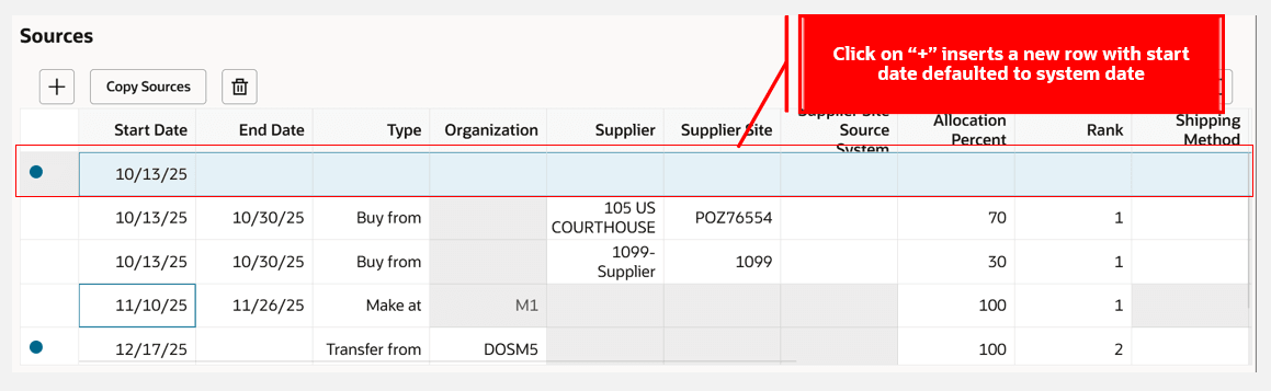

Date effectivity (effective start date and effective end date) is a part of each source row in the sourcing details region. Rows with identical date effectivities (same effective start and end dates) are considered to be a related block of sources. When you change the effective start or end date of one source in a block, then the effective dates of the other sources in the block automatically change to match. Within a block of sources, sources with the same rank must have allocation percentages that total 100.
To add a source:
  1. Click the + icon. A new source row is added at the beginning of the sourcing details region, with the Start Date defaulted to the system date.
  2. Update the Start Date and End Date as needed.
  3. Enter other source details.
  4. Click Save.

To edit a source:
  1. Select a source row and perform inline edits of the details.
  2. If needed, select another row and perform inline edits for that row. Repeat as needed.
  3. Click Save when done.

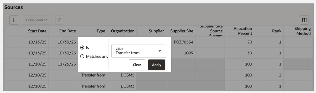

Column filters are ad-hoc filters that are appended to the keyword search and filter chips, allowing you to further refine your results. To access column filters, hover over the column header and click on the Filter icon.
Here’s an example of applying a column filter for Type in the sourcing details.
Column Filter for Type Column in Sources
Result After Applying Column Filter for Type Column in Sources

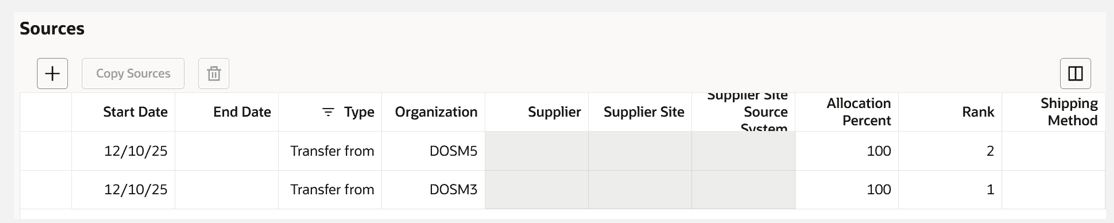

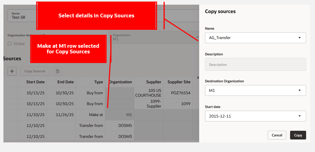

Copy Sources
To copy sourcing details from another sourcing rule:
  1. Select a sourcing detail from the table and click the Copy Sources button.
  2. The Copy sources drawer opens.
  3. Select the sourcing rule, destination organization, and start date reference for the sourcing rule from which the sourcing detail is to be copied.
Copy Sources Drawer with Details

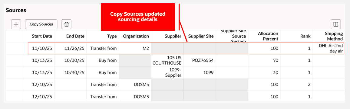

Copy Sources Updated Sourcing Details
  1. Click Copy and then save the changes.
