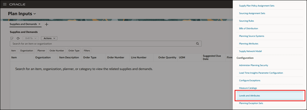

You can open the Levels and Attributes page from a demand, demand and supply, replenishment, sales and operations, or supply plan or the Plan Inputs.
To open the Levels and Attributes page, on the More Actions menu, select View More, and in the Actions drawer, in Configuration, select Levels and Attributes. The page will open on a new browser tab.
Actions Drawer
Actions Drawer

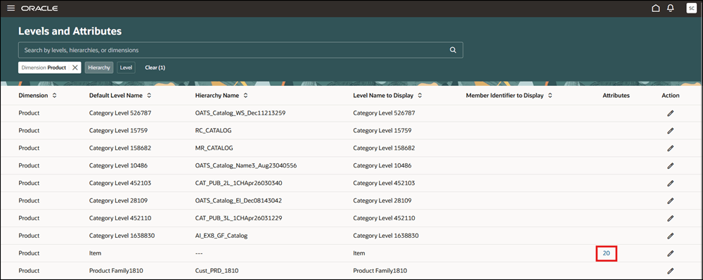

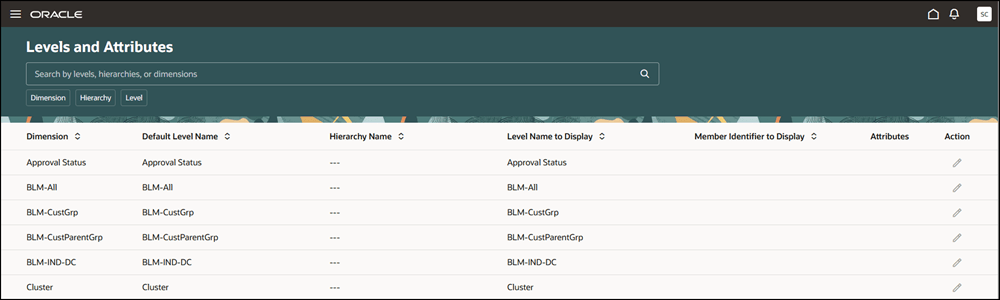

Levels and Attributes Page
On the page you can use the search bar to search for records by level, hierarchy, or dimension. You can also use the suggested filters for dimensions, hierarchies, and levels.
You can select the Edit icon for a record to edit it.

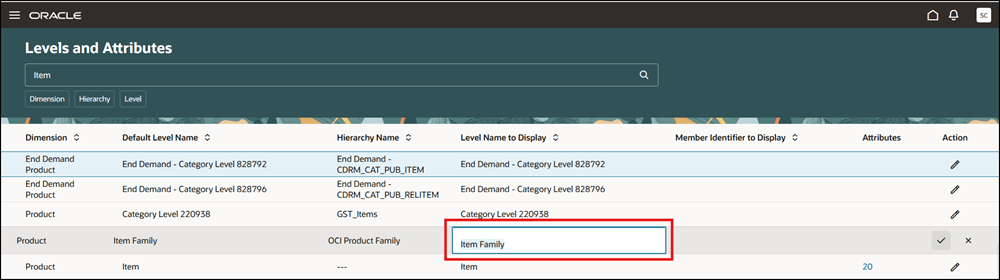

Change the Display Name
For any level except the lowest levels, you can use the field in the Level Name to Display column to change the name that’s displayed in tables and graphs for the level.
Field for Editing Display Name for Level

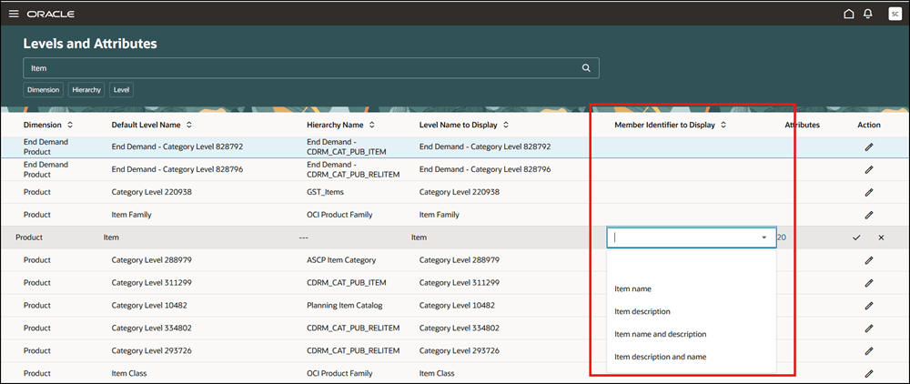

Select the Member Identifier
You can use the list in the Member Identifier to Display column to configure how a level is displayed for the following:
  • Item level of the Product dimension
  • Organization level of the Organization dimension
  • Resource, Work Center, Work Area, and Organization levels of the Resource dimension
The available choices vary by the level being edited.
List for Configuring Member Identifier

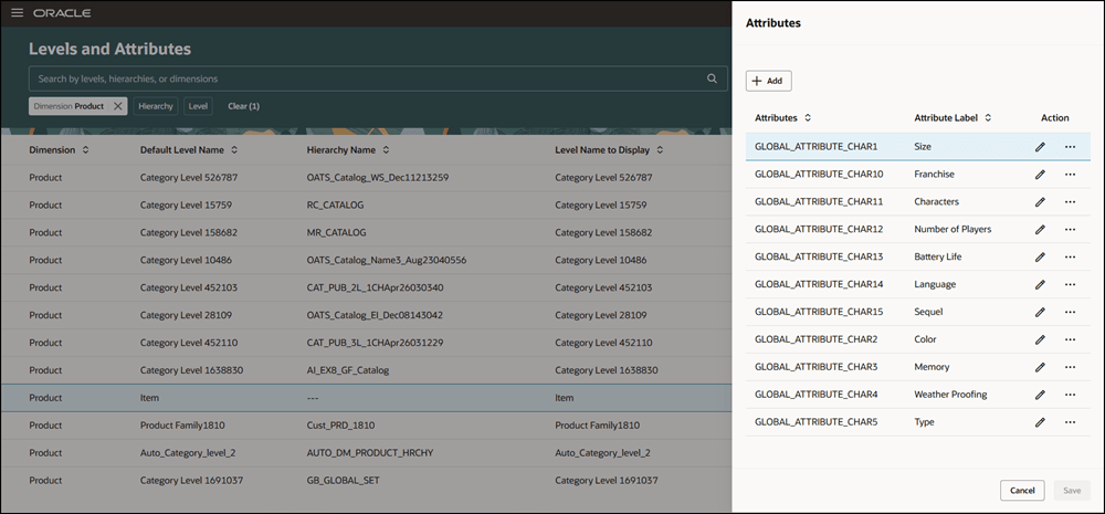

Edit the Attributes
You can edit the attributes for the following:
When you select the number in the Attributes column, the Attributes drawer will open, in which you can add, edit, and remove attributes for the level.
Number in Attributes Column
Attributes Drawer
Attributes Drawer
