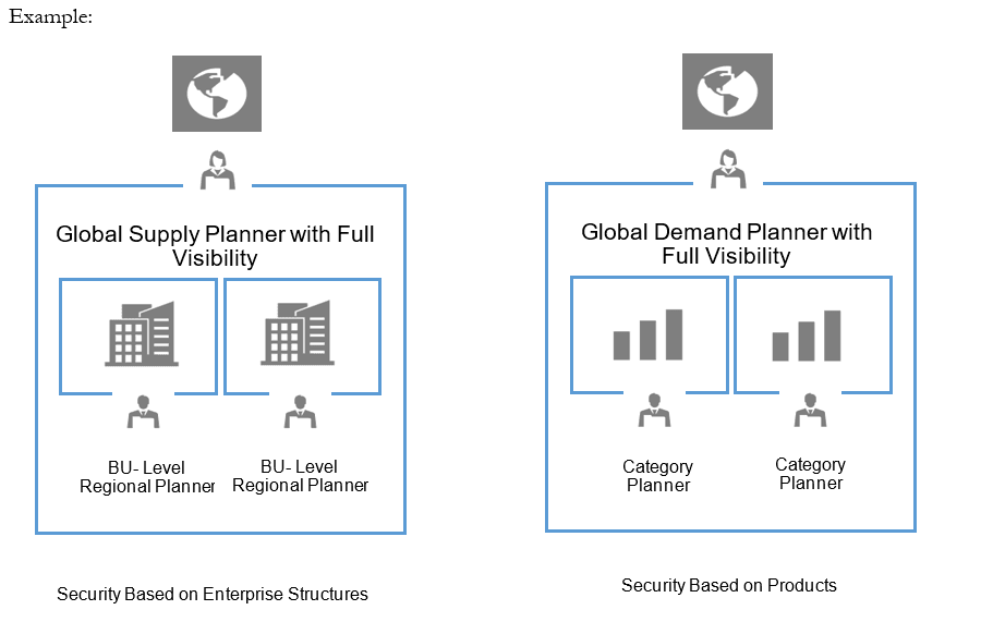

Consider a global plan covering four organizations: A, B, C, and D. The access requirements are as follows:
  • Planners 1 and 2 should have access to Organizations A and B
  • Planners 3 and 4 should have access to Organizations C and D
 Configuration Steps
  1. Create Job Role X and assign it to Planners 1 and 2.
  2. Create Job Role Y and assign it to Planners 3 and 4.
  3. Create Data Access Set DAS1 and assign it to Job Role X.
  4. Create Data Access Set DAS2 and assign it to Job Role Y.
  5. For DAS1, create a condition where Organization = A, B.
  6. For DAS2, create a condition where Organization = C, D.
This configuration ensures that planners can only access the supply and demand data relevant to their assigned organizations.

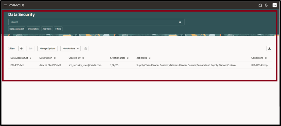

To open the page, select Administer Planning Security from the UI Shell. The Data Security page will then be displayed.
Data Security
Data Security Toolbar
Data Security
The Data Security toolbar provides the following actions:
  1. Add - Create a new Data Access Set.
  2. Edit - Modify attributes of an existing Data Access Set.

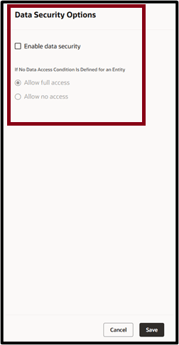

  3. Manage Options - Enable Data Security at a global level for entities where a Data Access Set is not defined.

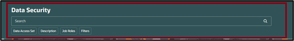

Searching and Filtering Data Security
You can search for Data Access Set using the search bar and the suggested filters.
Data Security
Keyword search bar: Search across multiple columns by entering text in the keyword search field. For Data Access Sets, the search specifically applies to the Data Access Set and Description columns, using the contains operator. For example, type DAS and press Enter or click the search icon. The table displays all Data Access Set names containing DAS, such as DAS1.
Note: Keyword search isn’t case sensitive.
Suggested filters: Filter Data Access Sets using the column-specific filter suggestions. For example, select a Job Role or Data Access Set from the suggested filters, then press Enter or click outside the filter. The table updates to show only the rows that match your selection.
The following screenshot appears on creating the Name and Description of the data access set and assigning to specific roles.
Data Security

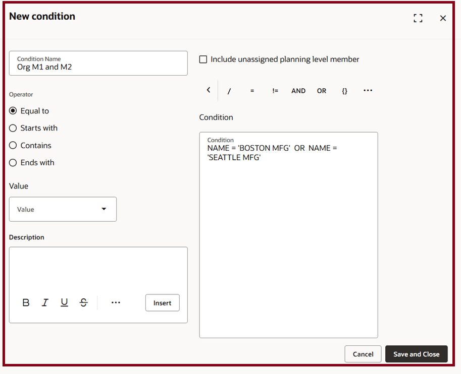

New Condition Drawer
In the New Condition drawer, follow these steps to define a condition for a data access set:
  1. Enter a Condition Name.
  2. Define the condition using the Advanced Create Expression option.
    For example, an Org M2 condition can be created where data security is applied only when the Organization equals BOSTON MFG or SEATTLE MFG.
