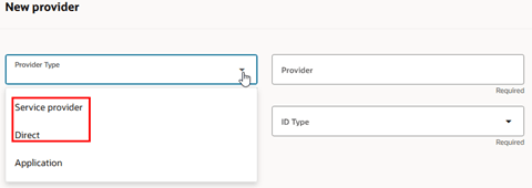

Define Your Providers
- Select Connections from the in-app navigation bar.
- Select the Providers tab to add a new provider.
- Select Direct or Service Provider as the Provider Type and add the remaining details.
- Click Save.
Add a Provider

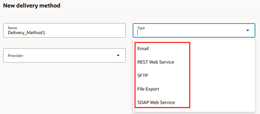

Configure Your Delivery Method
- Select the Delivery Methods tab and add a new delivery method. Enter the required details.
- Delivery methods that are associated with a provider can only be used for that provider when creating connections. You don’t need to create delivery methods for B2B Adapter or Business Event. When you’re creating connections, you can select one of the values below for these delivery method types:
- ORA_B2BAdapter
- ORA_BusinessEvent
- Click Save.
Add a New Delivery Method

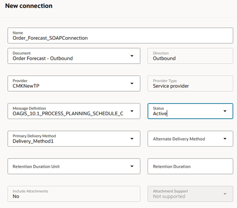

Create a Connection for Each of the Documents You Exchange
- Select the Connections tab.
- Click Add to add a new connection and enter the details. Set the status to Active and click Submit.
- Repeat this process to create connections for all your outbound documents.
Add a Connection

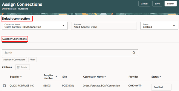

Assign Connections to Documents
- Select Documents from the in-app navigation bar.
- Select each of your outbound documents and set the Enabled field to Yes. Select Configure Document Properties to define any properties specific to the selected document.
- For outbound documents, you can configure the document so that you get the partner information from the payload for message processing.
- Enable the property group Partner identification from payload.
- Select Edit Properties and enter a value for Partner ID path. You can also enter a value for Partner ID type path. If you don’t enter a value, the partner ID type Generic is used.
- Click Submit.
- On the B2B Documents page, select the Order Forecast - Outbound document and click Assign Connections.
- On the Assign Connections page, select a default connection for the document and enable it.
- You can also assign a supplier connection.
- Click Submit.
Default and Supplier Connection
- When Supply Forecast – Outbound is selected on the B2B Documents page, the Assign Connections page will display Customer Connections instead of Supplier Connections.
- You can’t assign connections to inbound documents, but you must have active connections and partner properties for each of your inbound documents.

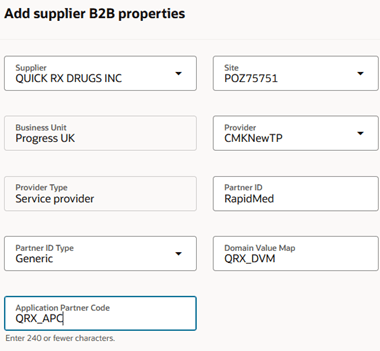

Here’s how you add Supplier B2B properties:
- Select Partners from the in-app navigation bar.
- On the Supplier B2B Properties tab, click Add.
- Enter the details in the Add supplier B2B properties drawer.
- Click Save.
Add Supplier B2B Properties

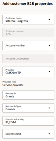

Here’s how you add Customer B2B properties:
- On the Customer B2B Properties tab, click Add.
- Enter the details in the Add customer B2B properties drawer.
- Click Save.
Add Customer B2B Properties
