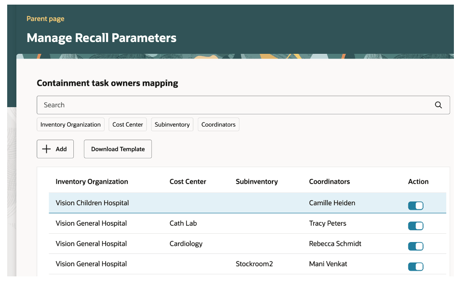

Location-to-employee mapping for containment task ownership:
  • Define mappings for:
    • Inventory organization only
    • Inventory organization + department (cost center)
    • Inventory organization + subinventory
Note: Department and subinventory cannot both be populated for the same mapping.
  • Assign multiple task owners per mapping. Mappings are date-effective, and the owner active at task creation time is used.
  • Support manual entry and bulk upload/download using a provided XLS template.
Containment task owners mapping
