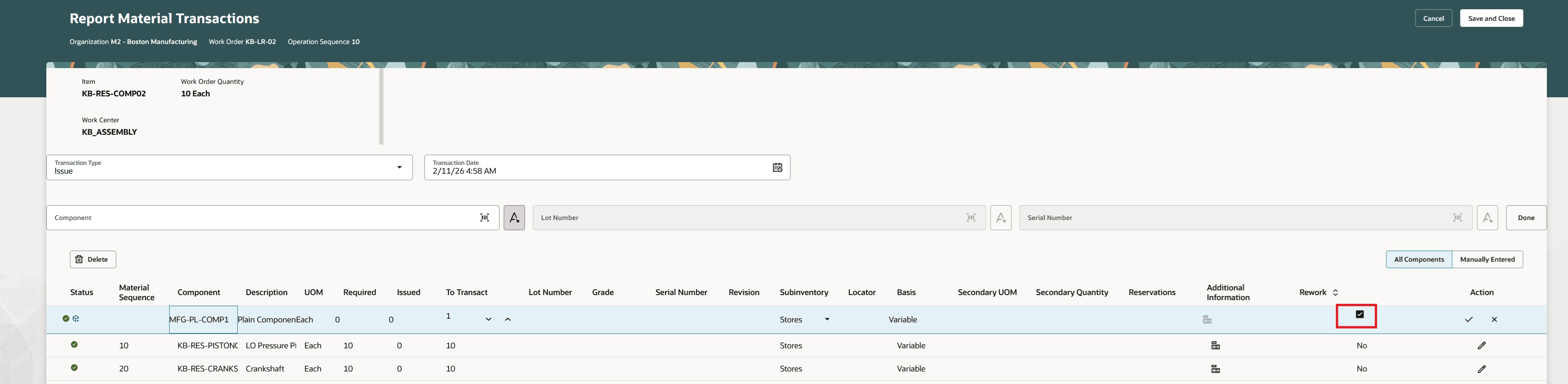

Report a material transaction with the rework identifier
Report a Material Transaction with the Rework Identifier

  • The Rework checkbox is not selected by default. When reporting material and resource transactions, you should select Rework to include them in the cost of rework.
  • You can use existing materials and resources or add ad hoc materials and resources for the purpose of rework at a work order operation.
