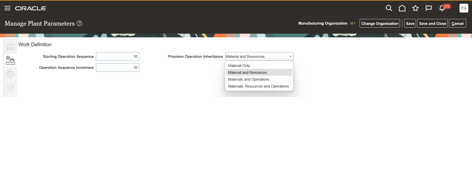

Steps to enable and configure
To enable this feature, update the current value for the Phantom Operation Inheritance plant parameter with one of these new options:
  • Materials and Operations
  • Materials, Resources and Operations
Phantom Operation Inheritance Plant Parameter
