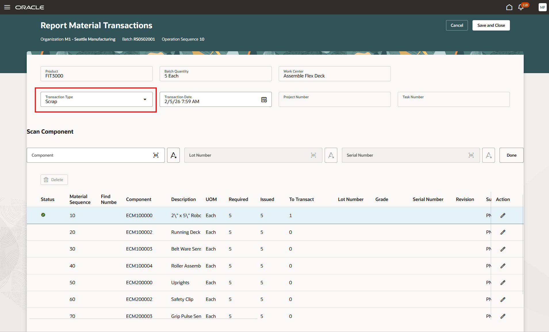

Scrap component transaction
Scrap Component Transaction

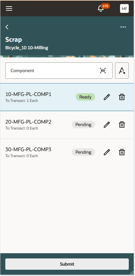

Scrap transaction through handheld device
