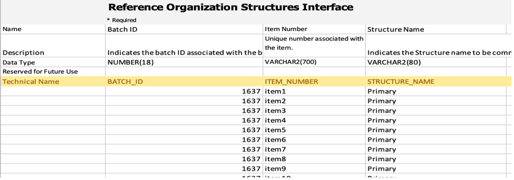

  • EGP_IMPORT_REF_ORG_STRUCT_INT: This sheet is used to identify the structures that belong to each item, that will be common to the identified reference organizations.
    Reference Organization Structures Interface Sheet
    • Specify the same batch ID (that was specified in the previous sheet).
    • If the item number and structure name is provided in this sheet, then the structures will be made common to those reference organizations listed in the EGP_IMPORT_REF_ORG_ORGS_INT sheet.
    • If the item number isn’t provided and structure name is provided in this sheet, then the structures for the items listed in the EGP_IMPORT_REF_ORG_ITEMS_INT sheet will be made common to all the reference organizations listed in the EGP_IMPORT_REF_ORG_ORGS_INT sheet.
    • If the item number is provided and structure name isn’t provided, then all the structures  are made common for the items listed in the EGP_IMPORT_REF_ORG_ITEMS_INT sheet.

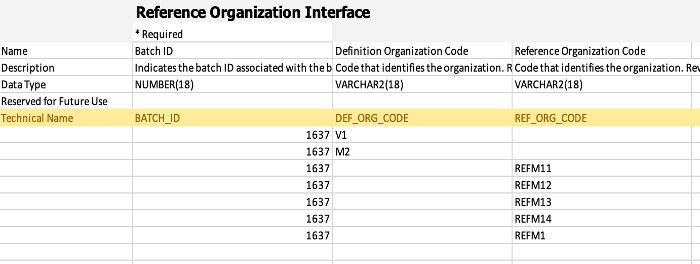

  • EGP_IMPORT_REF_ORG_ORGS_INT: This sheet identifies the list of definition organizations and reference organizations to which the item will be assigned.
    Reference Organization Interface Sheet
  • Provide the same batch ID that was identified in the first sheet.
  • If the definition organization is provided and not the reference organization, then the items in the EGP_IMPORT_REF_ORG_ITEMS_INT sheet will be assigned to all the associated reference organizations.
  • If the definition organization isn’t provided and the reference organization is provided, the items in the EGP_IMPORT_REF_ORG_ITEMS_INT sheet will be assigned to only these reference organizations.

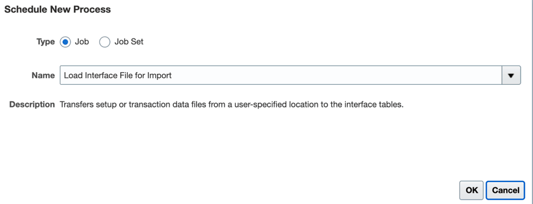

  1. Upload the ZIP file using the Load Interface File for Import scheduled process. Go to Tools > Scheduled Process, select Schedule New Process, search and select the Load Interface File for Import scheduled process, and select OK.
    Load Interface File for Import Scheduled Proce
    Load Interface File for Import Scheduled Process

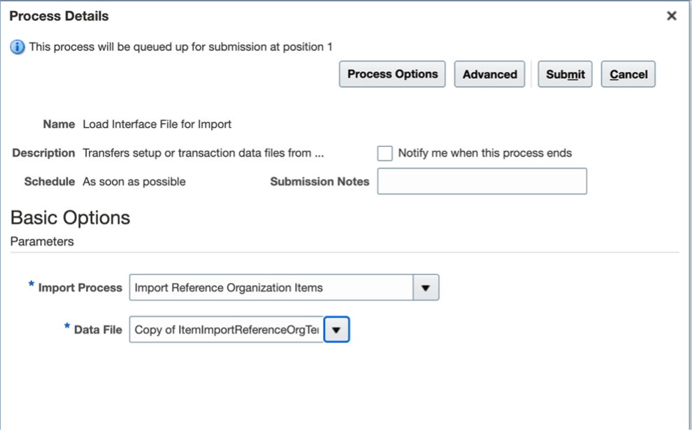

  1. Specify the following details:
    • For Import Process, select Import Reference Organization Items.
    • In Data File, select Upload New File and upload the FBDI zip file.
      Load Interface File for Import Scheduled Process Detail
  2. Submit the scheduled process. This process loads all the data from the FBDI file to the new import reference organization interface table.

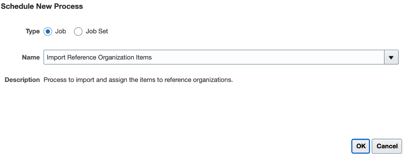

  3. After the Load Interface File for Import scheduled process is completed successfully, run the Import Reference Organization Items scheduled process to import the reference organization items.
    Import Reference Organization Items Scheduled Proces
    Import Reference Organization Items Scheduled Process

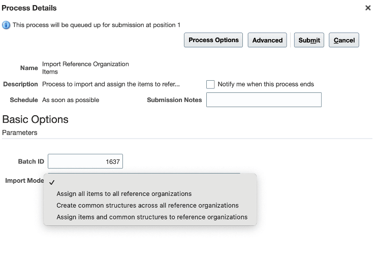

  4. Specify the following details.
    Import Reference Organization Items Process Details
    • In the Process Details window, provide the batch ID.
    • Select the corresponding Import Mode to appropriately assign the reference organization assignments or create common structures across all the reference organization or both:
      • Assign all items to all reference organizations: Assigns items in the sheet EGP_IMPORT_REF_ORG_ITEMS_INT to all the reference organizations listed in the EGP_IMPORT_REF_ORG_ORGS_INT sheet.
      • Create common structures across all reference organizations: Creates common structures across reference organizations.
      • Assign items and common structures to all reference organizations: Assigns items to all reference organizations and creates a common structure for all the reference organizations.
  5. Select Submit to submit the scheduled process.

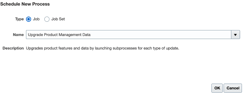

  1. Go to Tools > Scheduled Process, and select Schedule New Process.
  2. Search and select the Upgrade Product Management Data scheduled process, and select OK
    Upgrade Product Management Data Scheduled Process

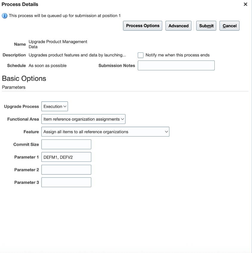

  3. In the Process Details window, specify the details as shown in the following screenshot.
    Upgrade Product Management Data Scheduled Process Details
The Parameter1 attribute accepts the list of definition organizations as an argument in a comma separated value format. All the reference organizations associated with each definition organization in this field will automatically assign all the items in the enterprise.
