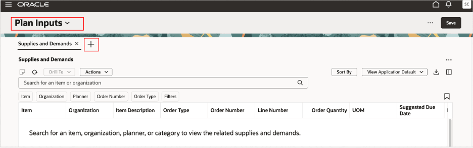

In the Redwood work area named Supply Chain Planning, go to the Plan Inputs by doing one of the following:
- Select Plan Inputs from the context selector. The Plan Inputs will open on the same tab.
- On the More Actions menu, select View More, and on the Actions drawer, in Plan Inputs, select Plan Inputs. The Plan Inputs will open on a new browser tab.
Plan Inputs
In the Plan Inputs, select the Add icon to open the Pages drawer.

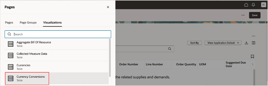

On the Visualizations tab, search for the Currency Conversions table, and select it.

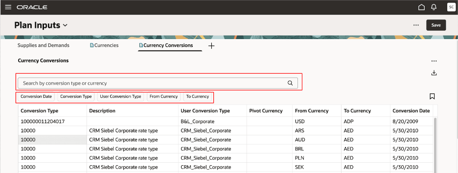

The Currency Conversions table will open on a new tab for the Plan Inputs.
Pages Drawer in Plan Inputs
Currency Conversions Table

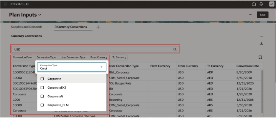

You can use the sorting options for each column. Also, you can search by currency name or conversion type in the search bar and use the suggested filters.
Search Bar and Suggested Filters for Currency Conversions Table
