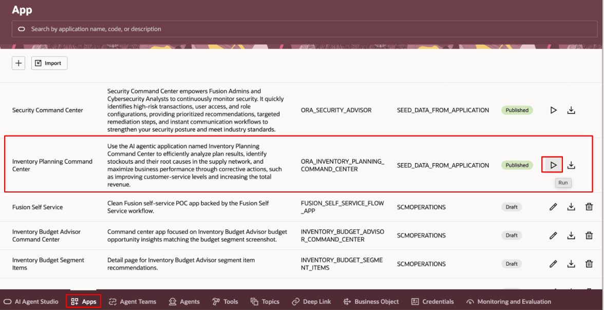

  1. In the Navigator, under Tools, select AI Agent Studio.
The AI Agent Studio will open.
  1. Select the Apps tab at the bottom of the AI Agent Studio.
  2. Search for the Inventory Planning Command Center, and select the Run icon.
The Inventory Planning Command Center will open on a new tab of your browser.
Run Icon for Inventory Planning Command Center

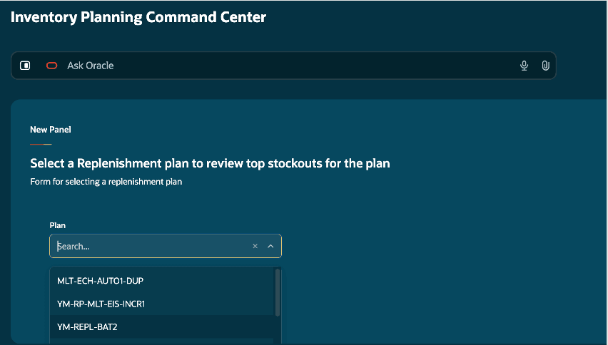

  1. In the Plan list, select the replenishment plan that you would like to analyze.
The available plans are only those that have been successfully run and for which you’ve selected the Calculate replenishments checkbox on the General tab in the Plan definition step of the guided process for creating or editing your replenishment plan.
Plan List
Plan List

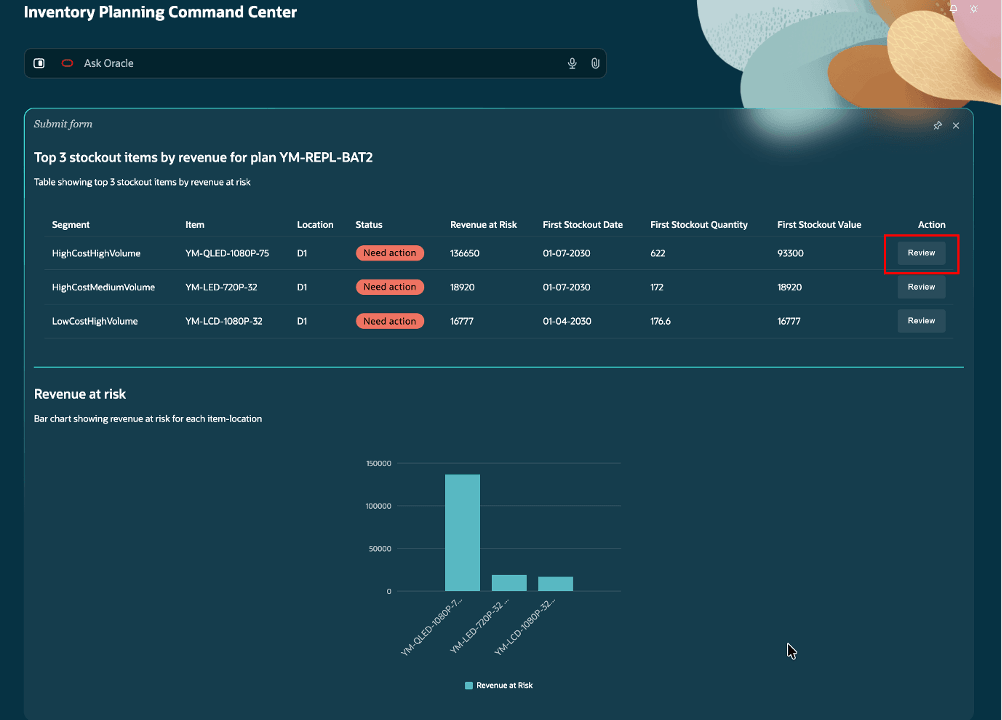

By default, the Inventory Planning Command Center displays the top three item-location combinations in the plan with stockouts by the risk to the revenue.
If you want to work on specific segments or item-location combinations, you can enter prompts similar to the following in the search bar:
  • Show me stockouts for item <item name> and location <location name>.
  • List the top three stockouts for location <location name>.
  • List the top three stockouts for segment <segment name>.
  1. Select the Review button in the Action column for an item-location combination for which you want to review and resolve the stockout.
Review Button for Item-Location Combination with Stockout

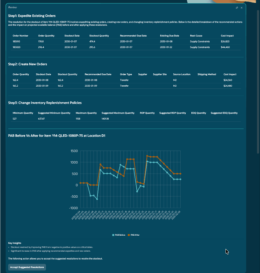

The Inventory Planning Command Center analyzes the root causes of the stockouts and suggests remedial actions starting from the most imminent stockouts to the stockouts farthest out in the planning horizon. The recommendations are displayed and implemented in this order:
  1. Expedite Existing Orders: The Inventory Planning Command Center suggests rescheduling of the existing orders to resolve stockouts within the replenishment lead time. With this step, lead-time constraints may get violated.
  2. Create New Orders: If the stockouts within the replenishment lead time aren’t completely resolved even after existing orders are rescheduled, the Inventory Planning Command Center suggests creating orders to resolve the stockouts within the replenishment lead time.
  3. Change Inventory Replenishment Policies: If there are still stockouts within the planning horizon but outside the replenishment lead time, then the Inventory Planning Command Center will suggest increasing the policy-parameter values.
Recommendations by Inventory Planning Command Center

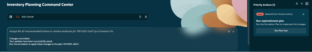

  1. To accept all the recommendations, select the Accept Suggested Resolutions button. A confirmation message will be displayed.
Confirmation Message for Accepted Resolutions

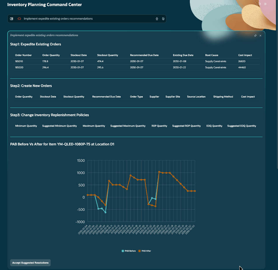

If you want to implement only a subset of the recommendations, you can enter prompts similar to the following in the search bar:
  • Select/show/preview/implement the first two recommendations for expediting orders.
  • Select all recommendations/suggestions/resolutions/options for expediting and creating orders.
  • Select the option for changing inventory policies.
  • Select all options but the create orders option.
  • Select all options but the change inventory policies option.
After you enter your prompt, the page will be refreshed and show the impact of the implemented recommendations on the stockouts. Use the graph for the projected available balance (PAB) to view the impact of implementing these recommendations. If you are satisfied with the impact, select Accept Suggested Resolutions. The changes are saved, and a confirmation message will be displayed.
