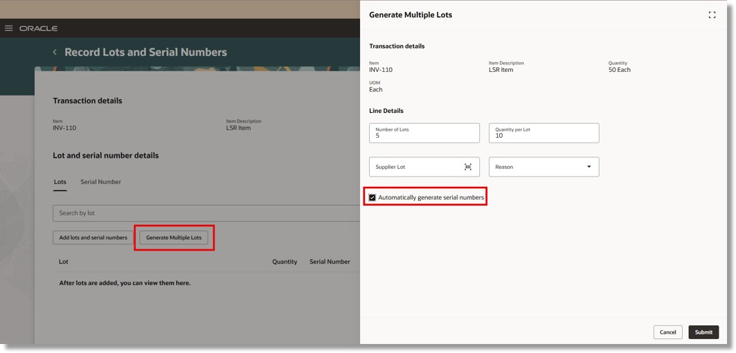

The Generate Lot, Generate Parent Lot, and Generate Multiple Lots action buttons have been added to these transactional pages where applicable:
Inventory
Page Navigation Additional Action Buttons
Miscellaneous Transactions Item Quantities > Create Miscellaneous Transactions > Record Lots
  • Generate Lot
  • Generate Parent Lot
  • Generate Multiple Lots

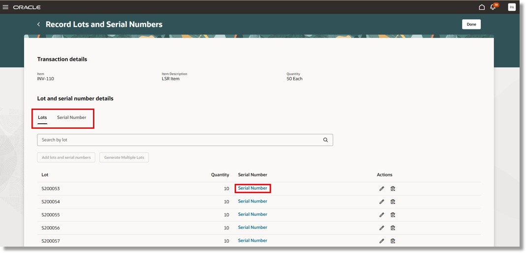

You can now generate multiple lots with or without serial numbers. System-generated serial numbers are created in ranges. After generating the lots, you can choose to manually enter or scan the serial numbers.
Lots and serial numbers are displayed in a tabbed structure, with serial numbers accessible through links.
Record Lots
Record Lots
This feature allows you to make necessary updates in real time, without disrupting your workflow, resulting in improved efficiency, more consistent data capture, and stronger support for traceability and regulatory compliance.
