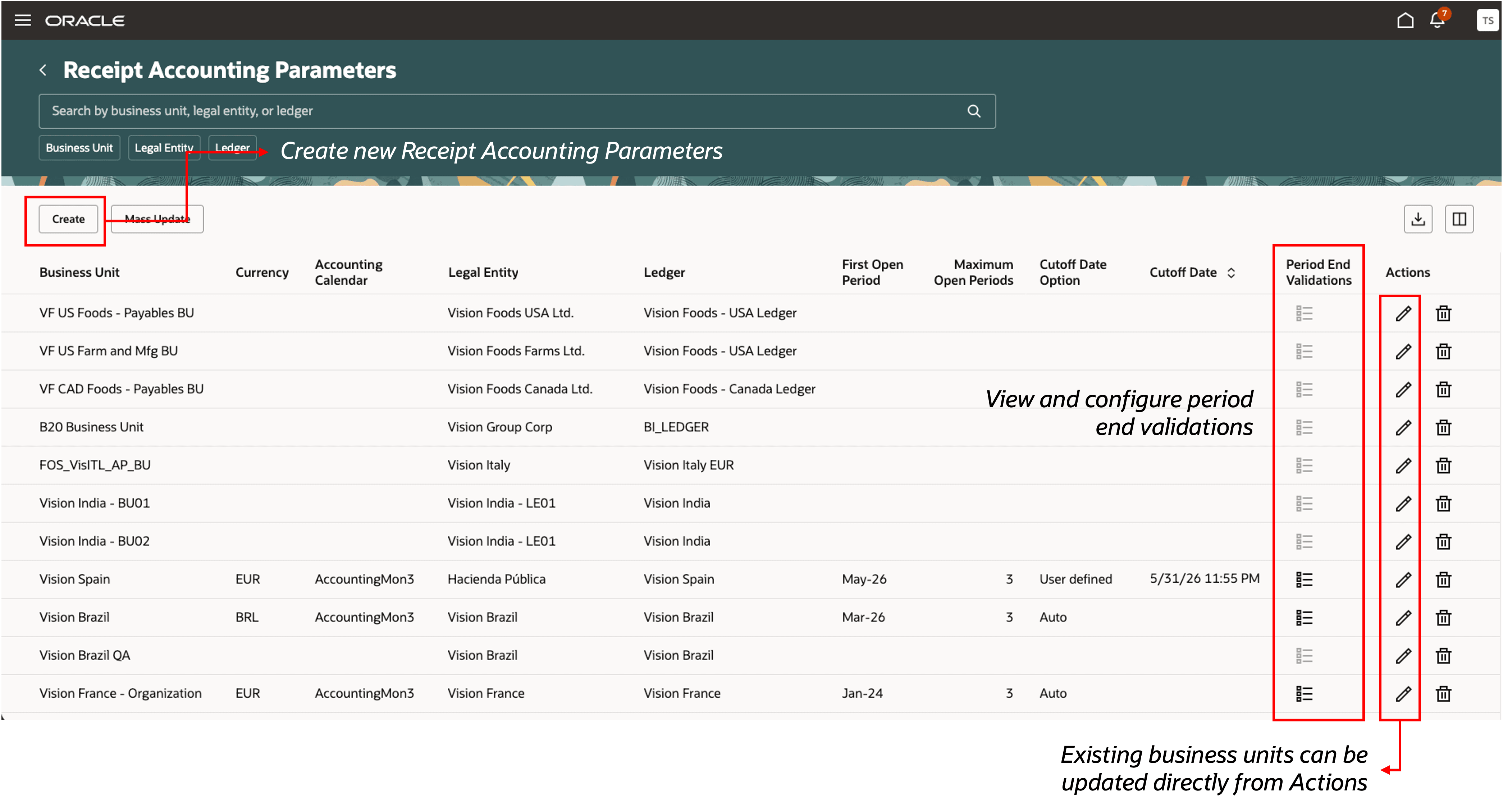

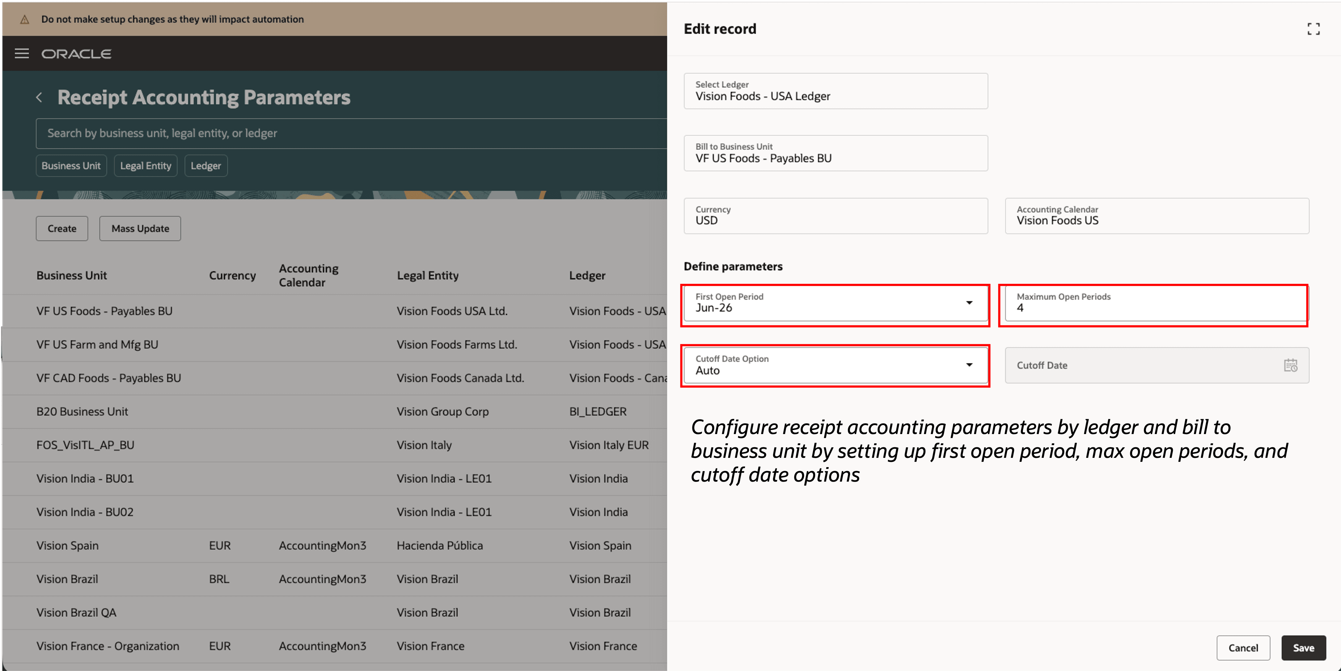

Receipt Accounting Parameters
To start using the receipt accounting periods, you must first set up the receipt accounting parameters. On the Receipt Accounting Parameters page, you can see all your bill-to business units and ledgers, and start period control for these combinations. You can either configure period controls for one bill-to business unit or apply the same configuration to multiple bill-to business units at once (for example, all bill-to business units in a ledger). This is critical for large enterprises that can have dozens or hundreds of bill-to business units because it reduces manual work, improves consistency, and lowers cutover risk.
Some of the key attributes you must define on this page are:
  • First open period:
    • New bill-to business units: Any transactions that are in or precede the first opened period are accounted in the first opened period.
    • Existing bill-to business units using Receipt Accounting: Use this for cutting over to the new receipt accounting periods functionality. Transactions that occurred before the defined first opened period will be accounted using the general ledger period as it was done prior to this update.
  • Maximum open periods: Specifies the maximum number of concurrent periods that can be open. If the number of periods is maximized, then no additional period can be opened until one of the open periods changes to the Closed, Permanently Closed, or Pending Close status.
  • Cutoff date: When the cutoff date option is automatic, the cutoff date is derived as the last day of the earliest open receipt accounting period after the last closed period during the Create Receipt Accounting Distributions process. You can optionally configure the cutoff date manually.
New Receipt Accounting Parameters Redwood Page
Create or Update a Receipt Accounting Parameter

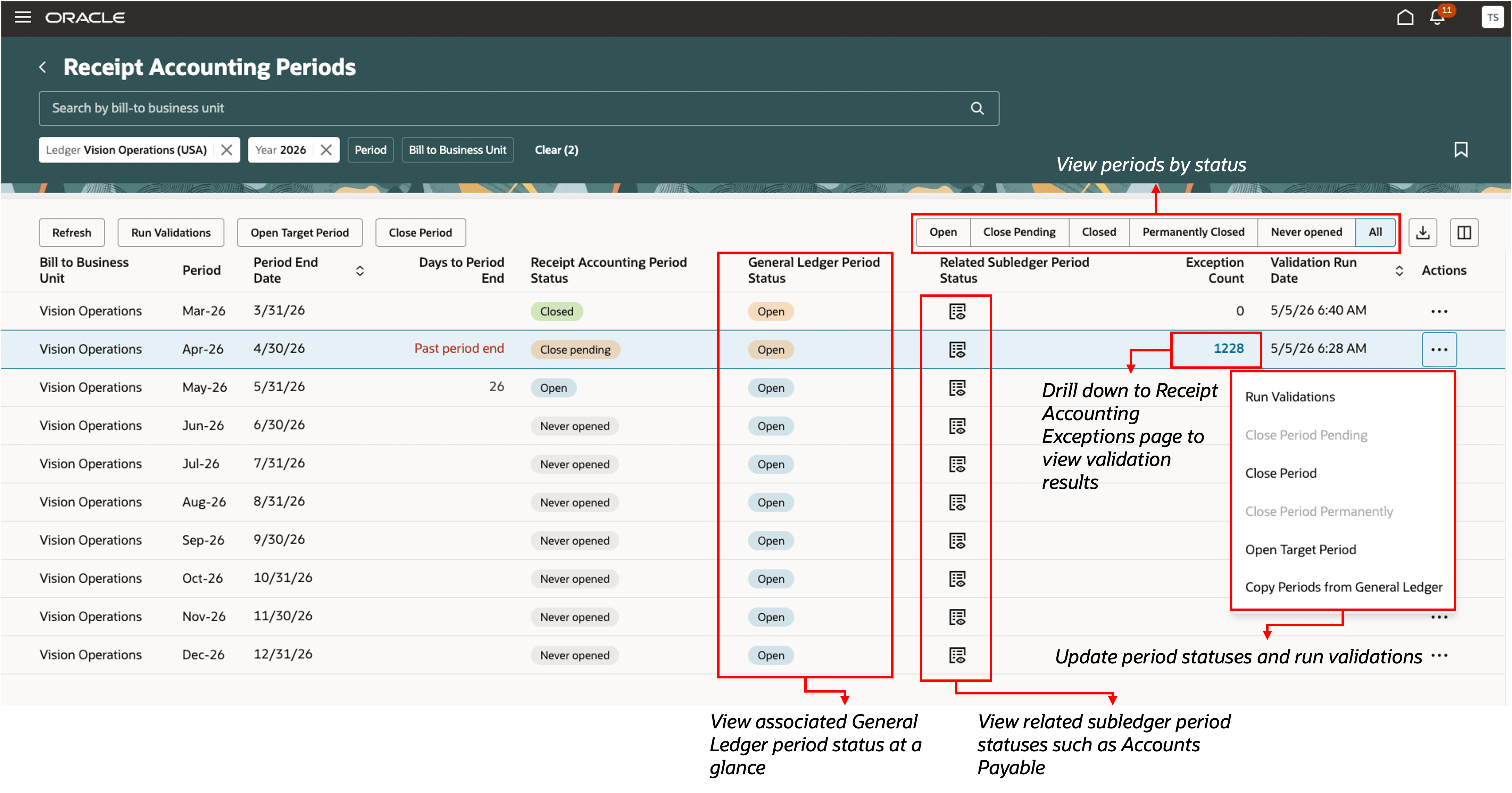

Receipt Accounting Periods
After configuring the receipt accounting parameters, periods are automatically created based on the setup and will be displayed in the Never Opened status on the Receipt Accounting Periods page.
You can now efficiently manage and monitor the receipt accounting periods with the following capabilities:
  • Update period statuses to Open, Close, Pending Close, and Permanently Closed as the accounting period activities progress.
  • Enforce gapless period opening to maintain accounting integrity.
  • Run period end validations for each period.
  • Drill down to the Receipt Accounting Exceptions Summary page to review validation results.
  • View associated general ledger period status and related subledger period statuses at a glance.
  • Copy periods from General Ledger to synchronize accounting calendars across ledgers and subledgers.
These enhancements provide greater visibility and control over period management, helping ensure alignment between the Receipt Accounting and General Ledger processes.
New Receipt Accounting Periods Redwood Page

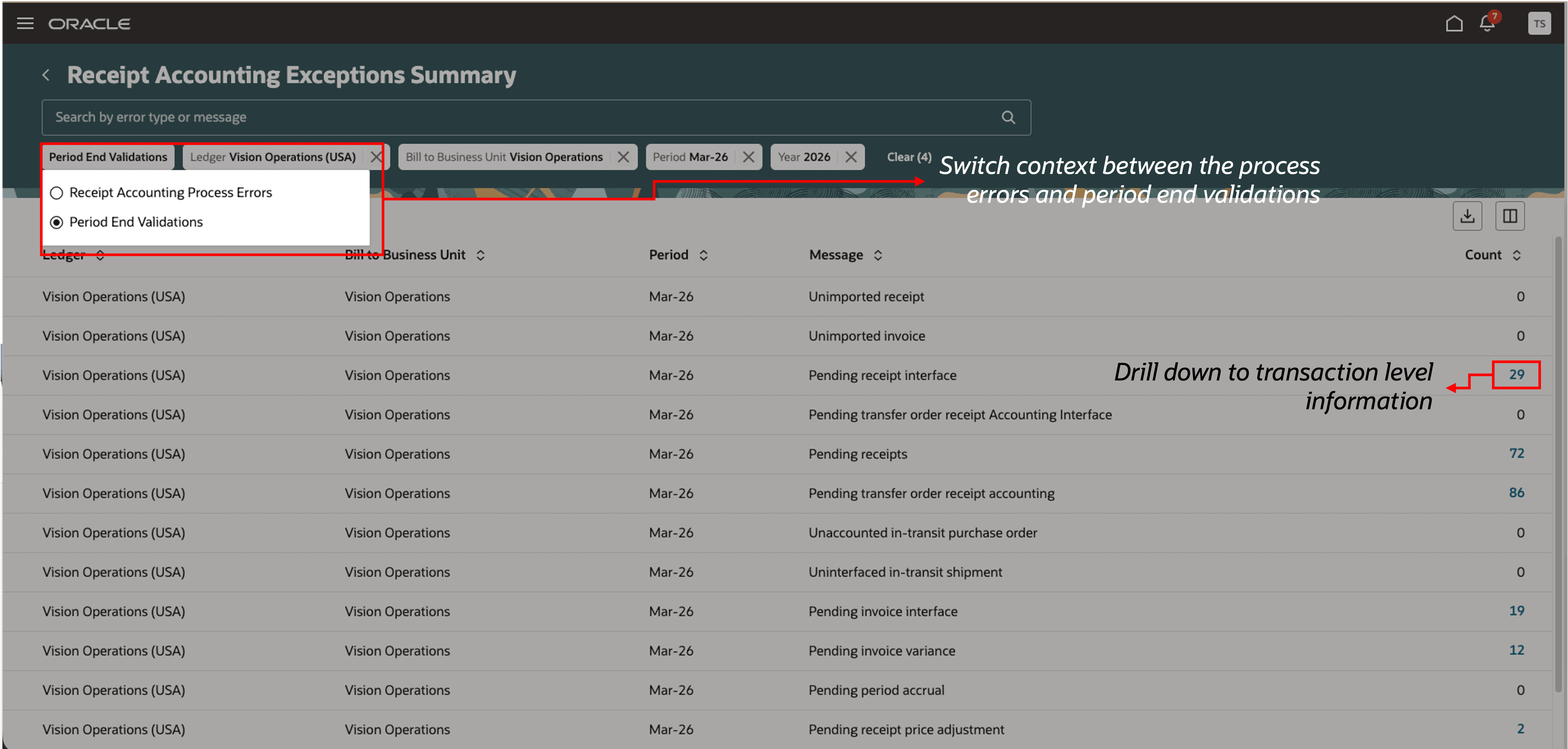

Receipt Accounting Exceptions Summary Redwood Page with Period End Validations
You can now review period-end validation results directly on the Receipt Accounting Exceptions Summary page. You can open this page from the landing page or drill down from the Receipt Accounting Periods page using the exception count. From the summary page, you can drill down further to transaction-level details for each validation exception.
In addition, the Receipt Accounting Process Errors page now includes new messages for errors related to receipt accounting period statuses. These enhancements provide a centralized and intuitive exception review experience, helping you identify and resolve issues more quickly.

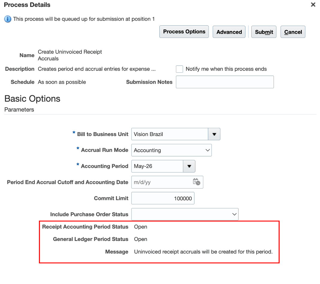

Accrue at Period End
The Create Uninvoiced Receipt Accruals scheduled process now considers receipt accounting period status along with the general ledger period status to create uninvoiced receipt accruals. If either the receipt accounting period or the general ledger period is closed, then the uninvoiced receipt accruals won't be created. If receipt accounting parameters aren't set up for the bill-to business unit, then the uninvoiced receipt accruals will be created based on only the general ledger period status, as done in previous updates.
Create Uninvoiced Receipt Accruals Scheduled Process
