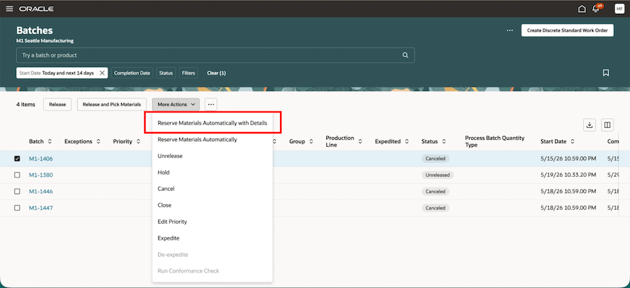

  • Automatically create detailed reservations for materials for a batch or group of batches from the Batches UI: Use the Reserve Materials Automatically with Details action on the Batches page to create detailed reservations for materials for a single batch or a selected group of batches. The Reserve Materials for Batches scheduled process is launched to create detailed reservations. The process uses pick rules to identify the appropriate source inventory and creates reservations at the detailed level.
Detailed reservation from Batches UI
Detailed Reservation from the Batches Page

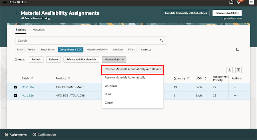

  • Automatically create detailed reservations for materials for a batch or group of batches from Material Availability: Use the Reserve Materials Automatically with Details action from the Material Availability Assignments page to create detailed reservations while reviewing material availability for a batch or group of batches. The Reserve Materials for Batches scheduled process is launched to create detailed reservations. This helps you reserve the required materials earlier in the execution flow and improve readiness for downstream picking and issue transactions.
Detailed reservation from Material Availability Assignments
Detailed Reservation from Material Availability Assignments

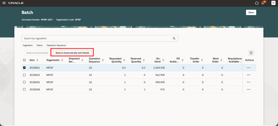

  • Automatically create detailed reservations for ingredients in a batch: You can also create detailed reservations for one or more ingredients of the batch from the Reservations page in Inventory with the batch demand context using the Reserve Automatically with Details action. A scheduled process is launched to create detailed reservations.
Detailed reservation for one of more ingredients of the batch
Detailed Reservation for One or More Ingredients of the Batch

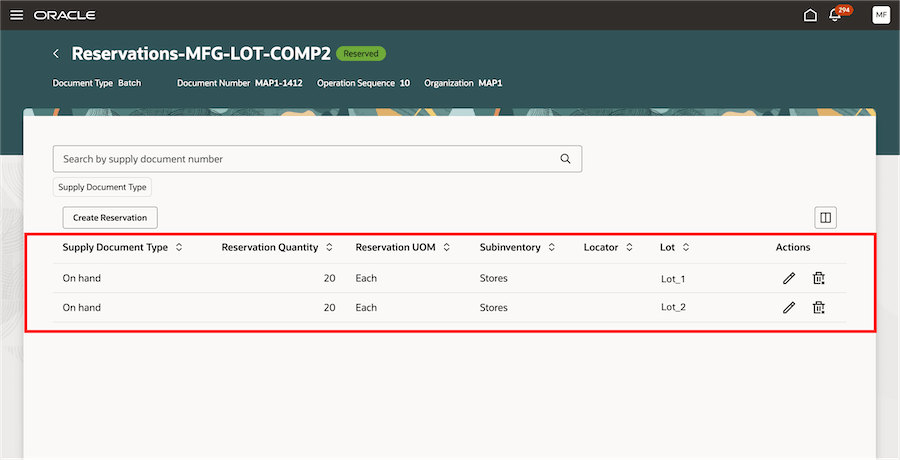

  • Review reservation results: You can review the output file for the Reserve Materials for Batches scheduled process to see reservation results at the batch material level, including materials that were reserved successfully and materials that couldn’t be reserved due to availability or validation issues. You can also review reservation details, such as subinventory, locator, lot, and serial, in the Inventory Reservations UI.
Review results from Inventory Reservations UI
Review Results from the Inventory Reservations UI

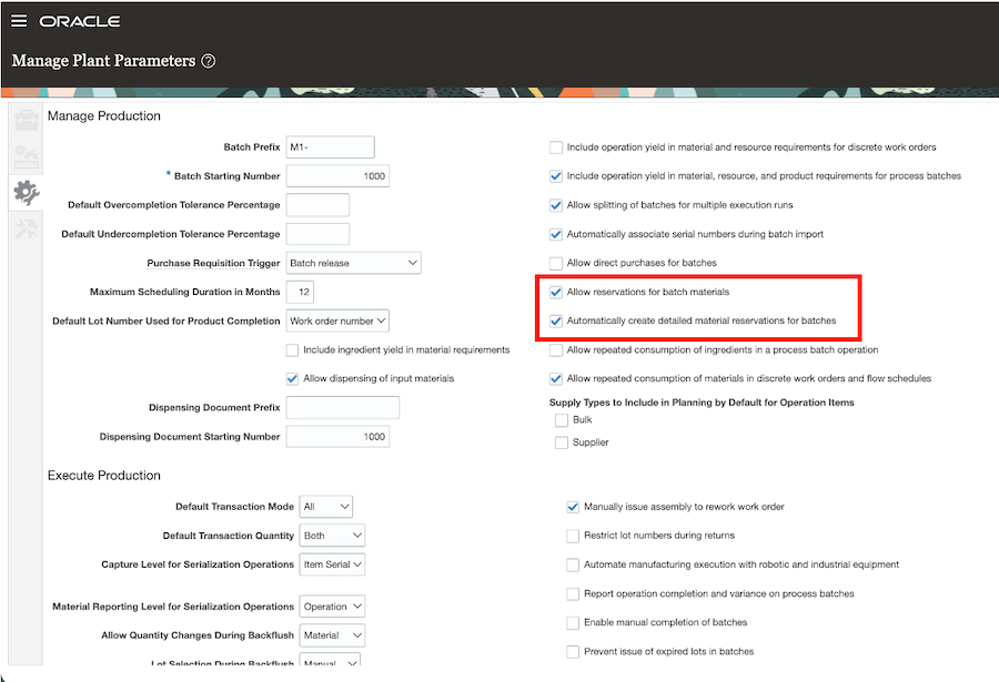

Set up the plant parameters to enable this feature:
  1. In the Setup and Maintenance work area, search for and open the Manage Plant Parameters task.
  2. Select the required inventory organization.
  3. In the Work Execution tab, ensure that the flag Allow reservations for batch materials (when process terminology is enabled) or Allow reservations for work order materials (when process terminology is not enabled) is enabled.
  4. Select the Automatically create detailed material reservations for batches (when process terminology is enabled) or the Automatically create detailed material reservations for work orders (when process terminology is not enabled) checkbox to enable this feature.
Plant parameters to enable automatic detailed reservation
Plant Parameters to Enable Automatic Detailed Reservation
