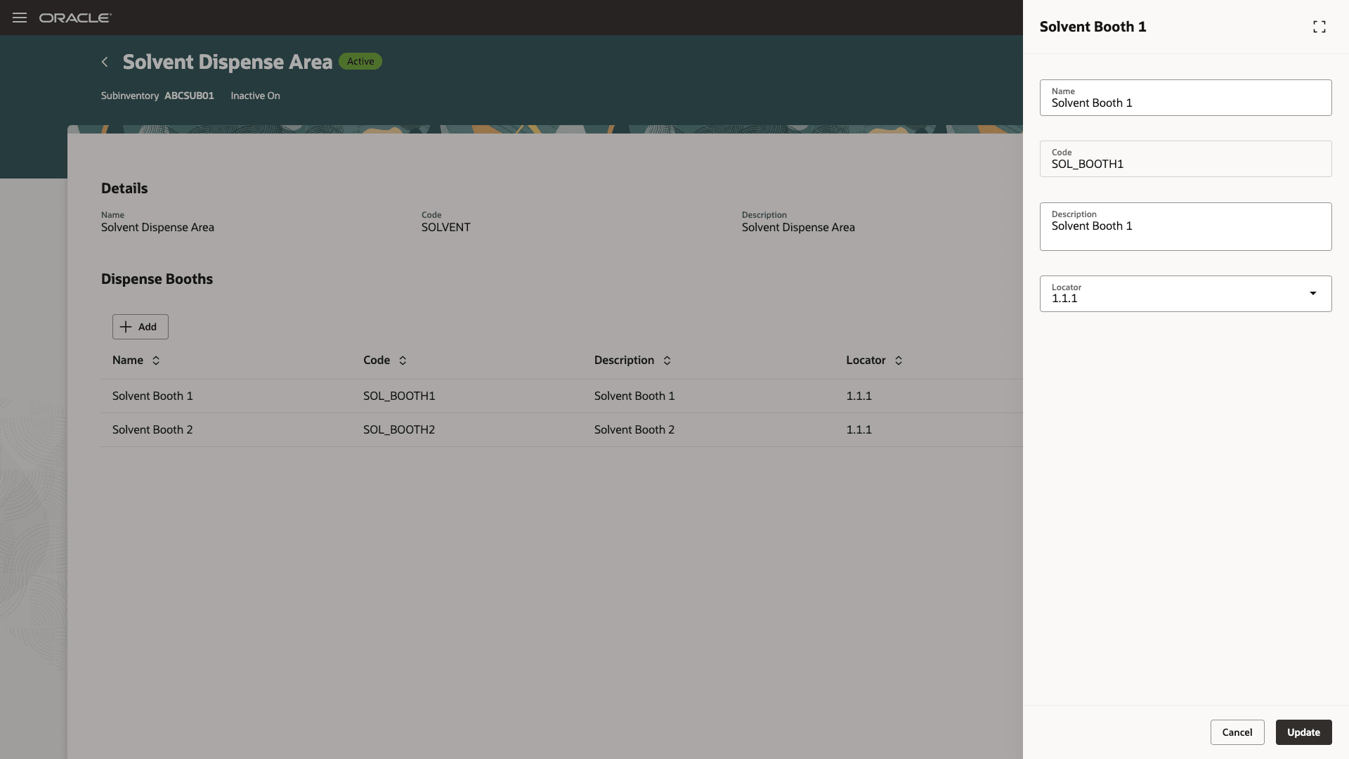

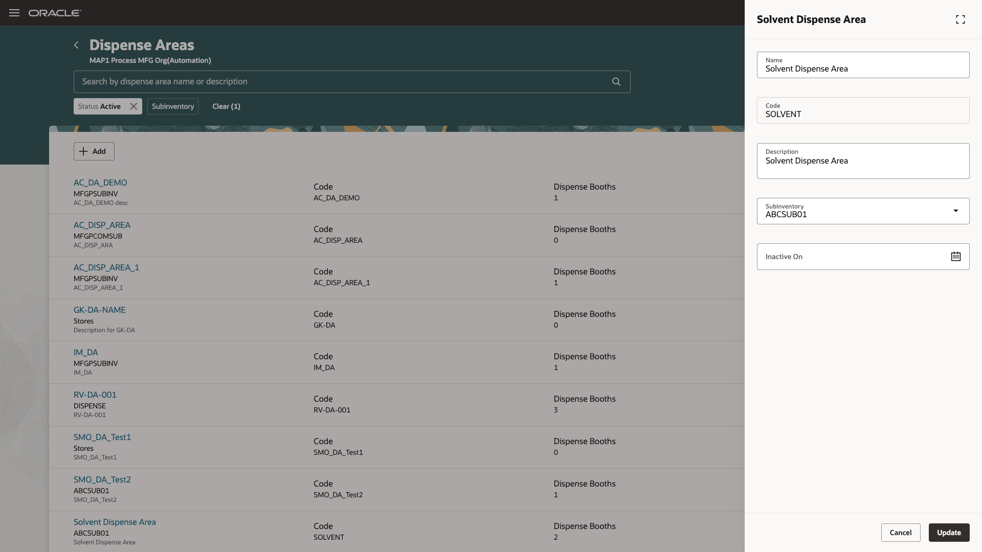

Designate a location in your plant to dispense materials by defining a dispense area. A dispense area needs to be mapped to a subinventory and is used to perform all dispensing activities in your plant.
Dispense area
Dispense Area
You can attach dispense booths to the newly created dispense areas if you use separate workstations for different operators or different materials. You need to associate the dispense booths to locators when you create them. Note that the dispense booths are necessary if the subinventory that you have associated with the dispense area is locator controlled.
Dispense booths are associated with dispense areas
Dispense Booths are Associated with Dispense Areas

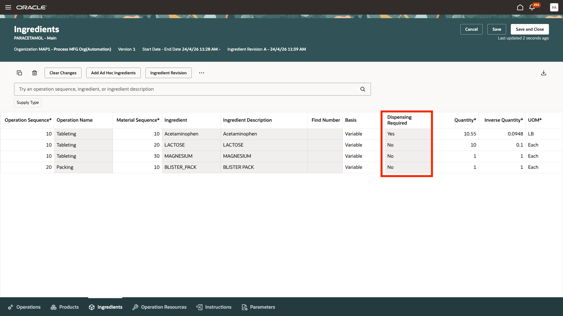

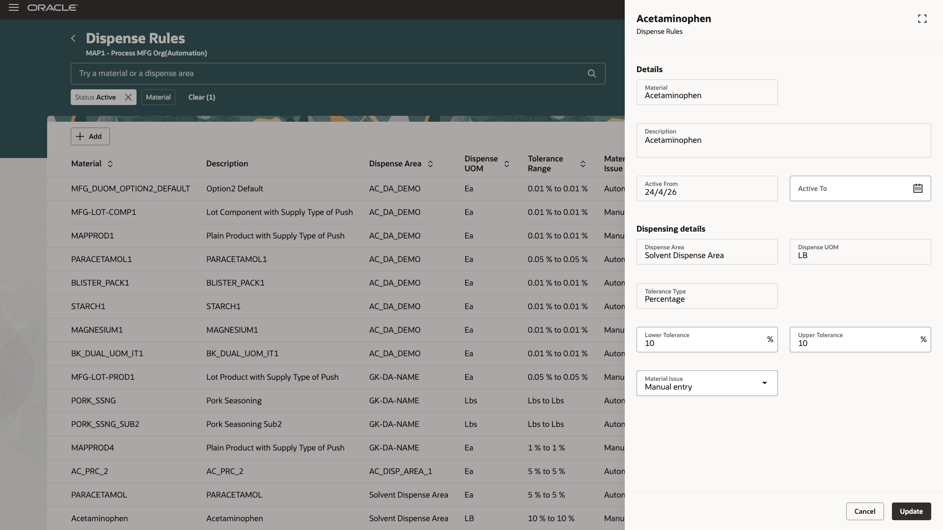

A dispense rule is defined to identify the items that require dispensing in a manufacturing plant. You would need to associate a dispense area where you perform the dispensing and the Unit of Measure (UOM) for the material. The UOM is typically the primary unit of measure for the item or a unit of measure that is convertible to the primary UOM.
Dispense rules
Dispense Rules
Once you create a dispense rule, the new Dispensing Required column in the Recipe/Work Definition page is set to Yes.
New indicator in the recipe (work definition) page
New Indicator in the Recipe (Work Definition) Page

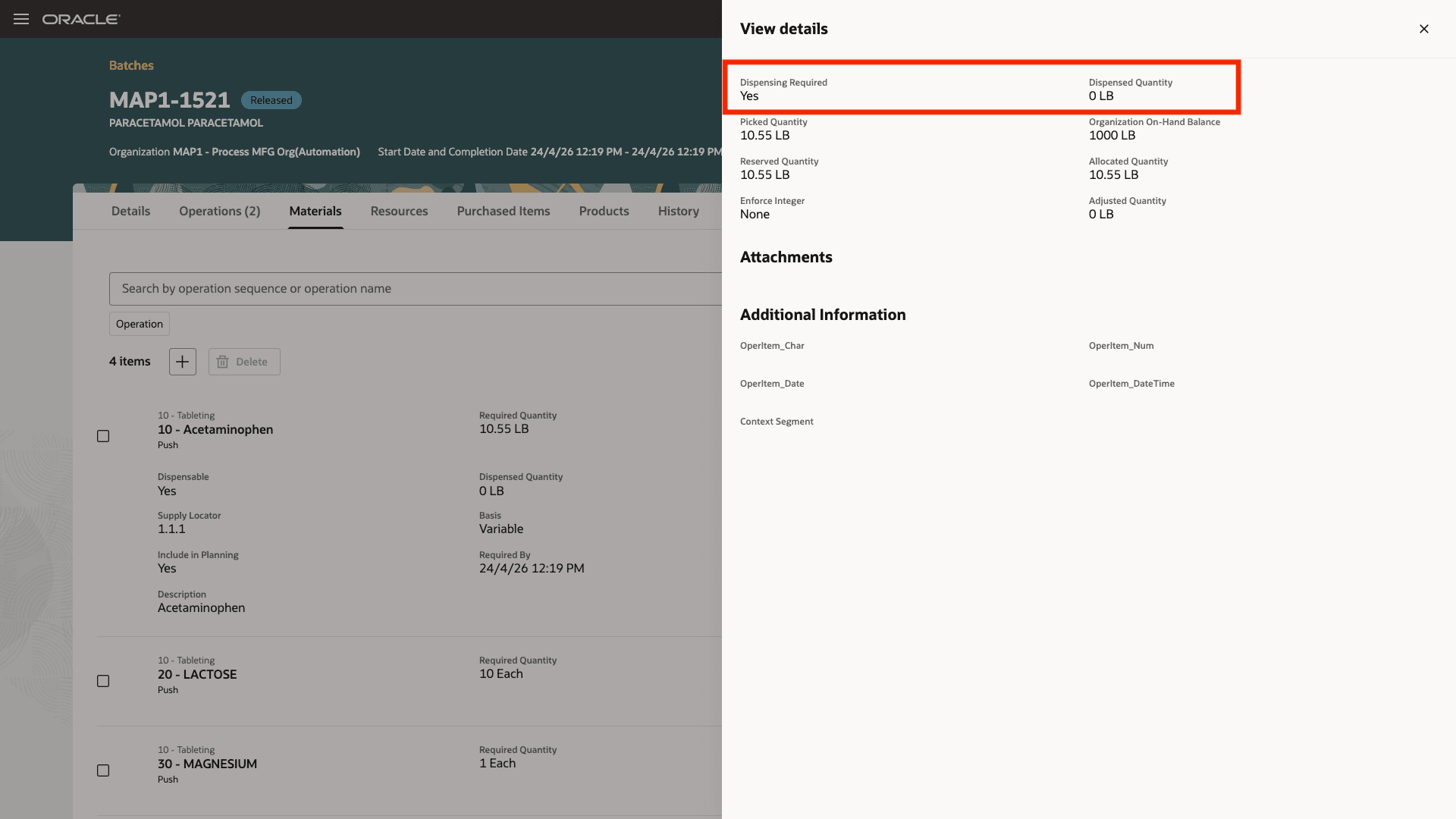

When you create a batch using this recipe, the subinventory associated with the dispense area is used as the supply subinventory.
New indicator for items that require dispensing
New Indicator for Items that Require Dispensing

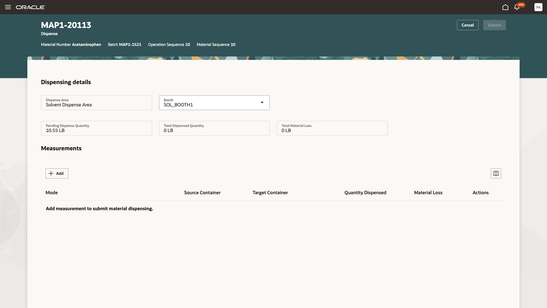

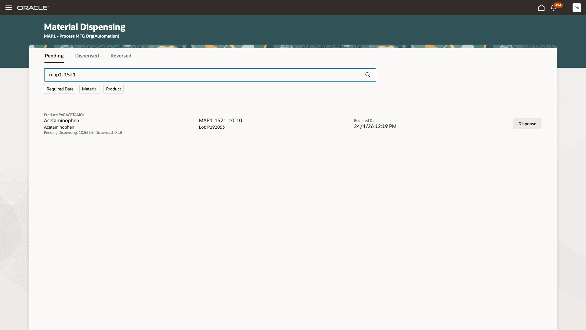

Once you have performed the detailed reservations for such work order lines, they show up in the Pending tab of the Material Dispensing page. You can search for materials that need to be dispensed using the material, product, batch, or the due dates. Click Dispense to start the dispensing process.
Materials that are pending dispensing
Materials Pending Dispensing
A dispense transaction number is generated based on the plant parameter setting. If the subinventory is locator enabled, then you can choose the booth for dispensing.
Dispense transaction
Dispense Transaction

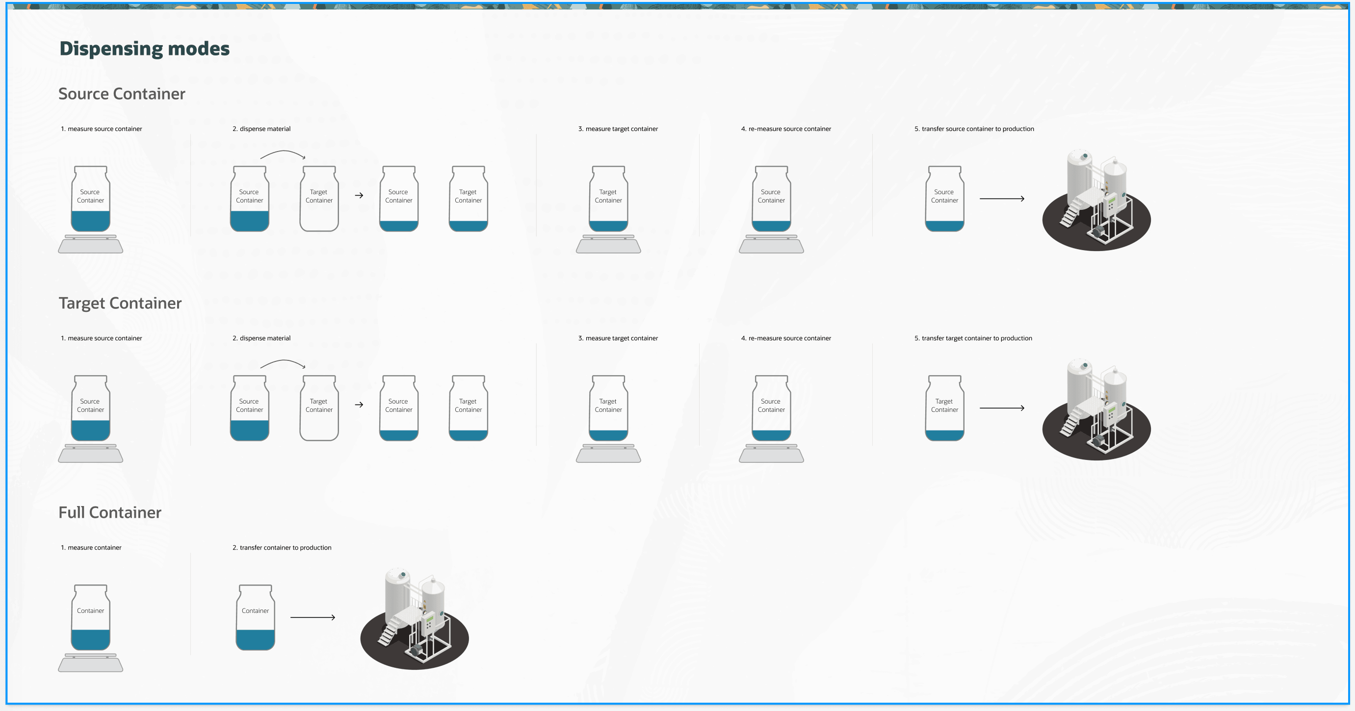

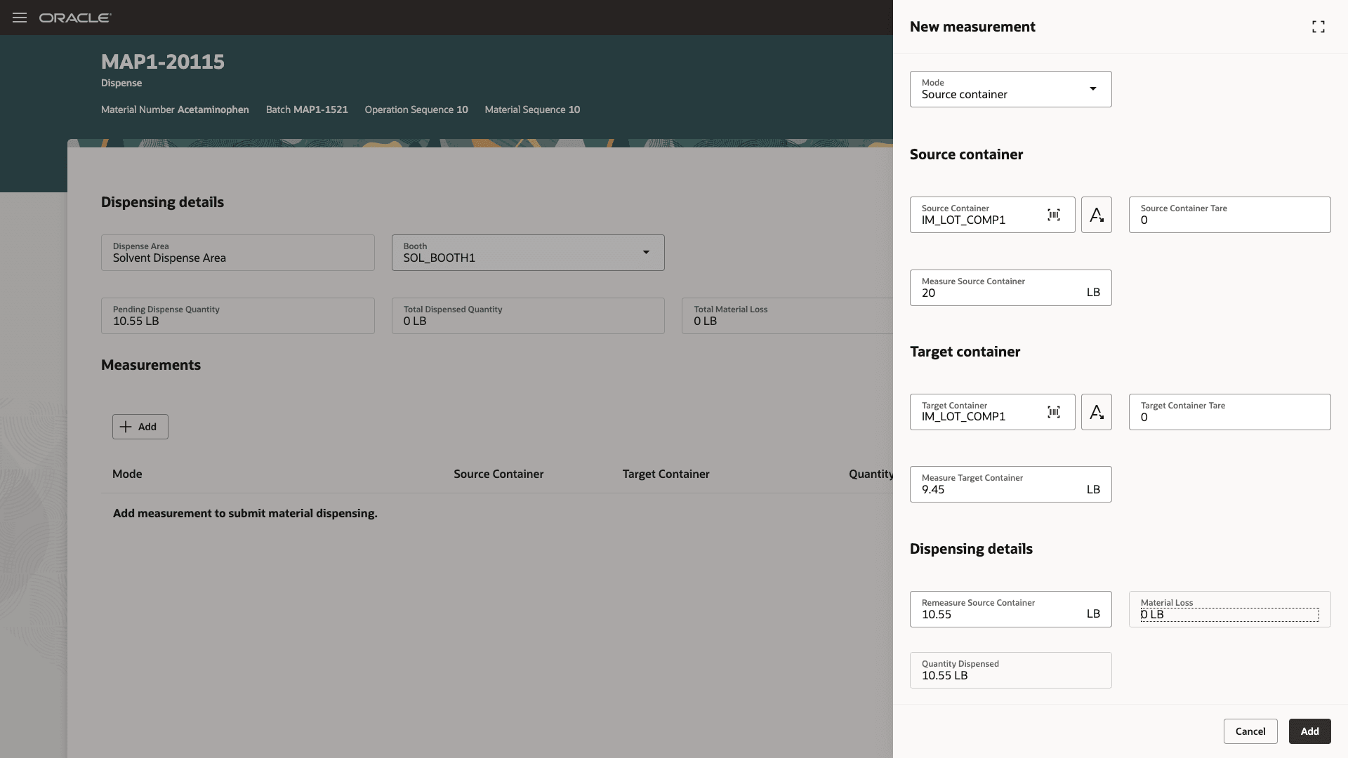

You can use one of the following modes to dispense the material:
  • Source Container
  • Target Container
  • Full Container
Dispensing modes
Dispensing Modes
After you choose the mode, you can enter the measurements of the source and target containers in the dispense UOM. If you have multiple containers to be measured to ensure that the whole quantity is dispensed, you can add multiple measurements so that the entire quantity is dispensed.
Measurements
Measurements

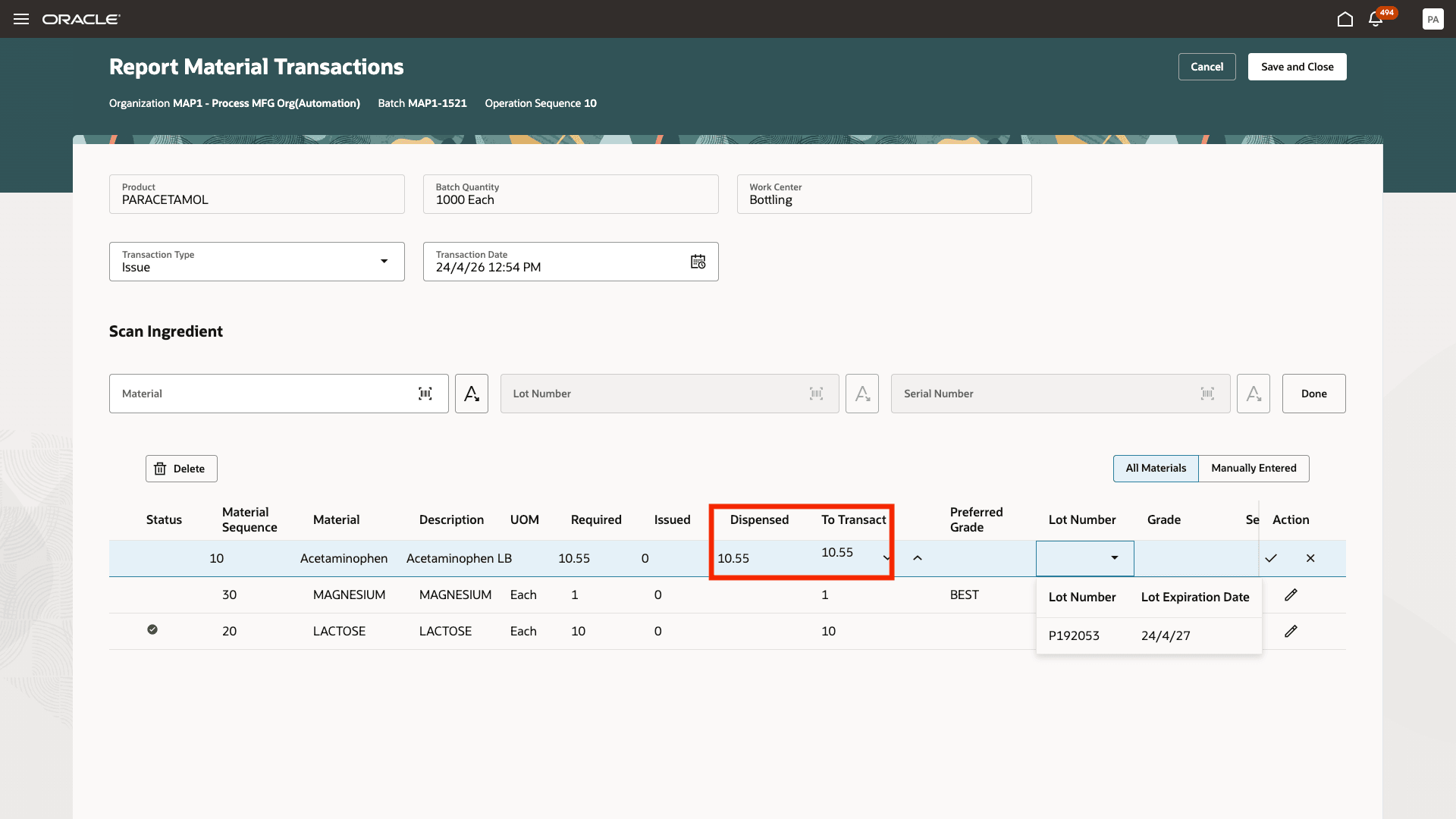

When you have dispensed the materials, you can either automatically issue the materials or can manually report it based on the dispense rule setting. If you are reporting it manually, you can issue the material to the extent that's dispensed. The "To Transact" quantity is updated based on the dispensed quantity and the quantity that you have already issued.
Report material transaction shows dispensed quantity and lot number information.
Report Material Transaction Shows Dispensed Quantity and Lot Number Information

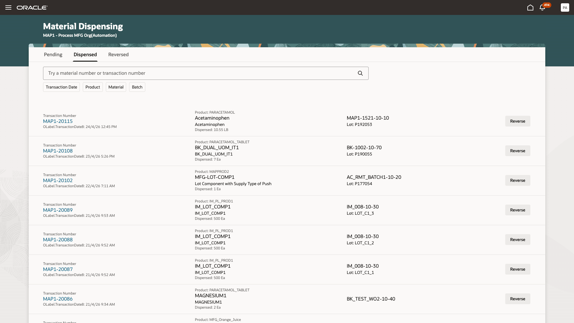

If the original batch is canceled and you don't require the material anymore, you can perform a material return and then reverse the dispensed quantity using the Reverse option.
Dispensed transaction history
Dispensed Transaction History

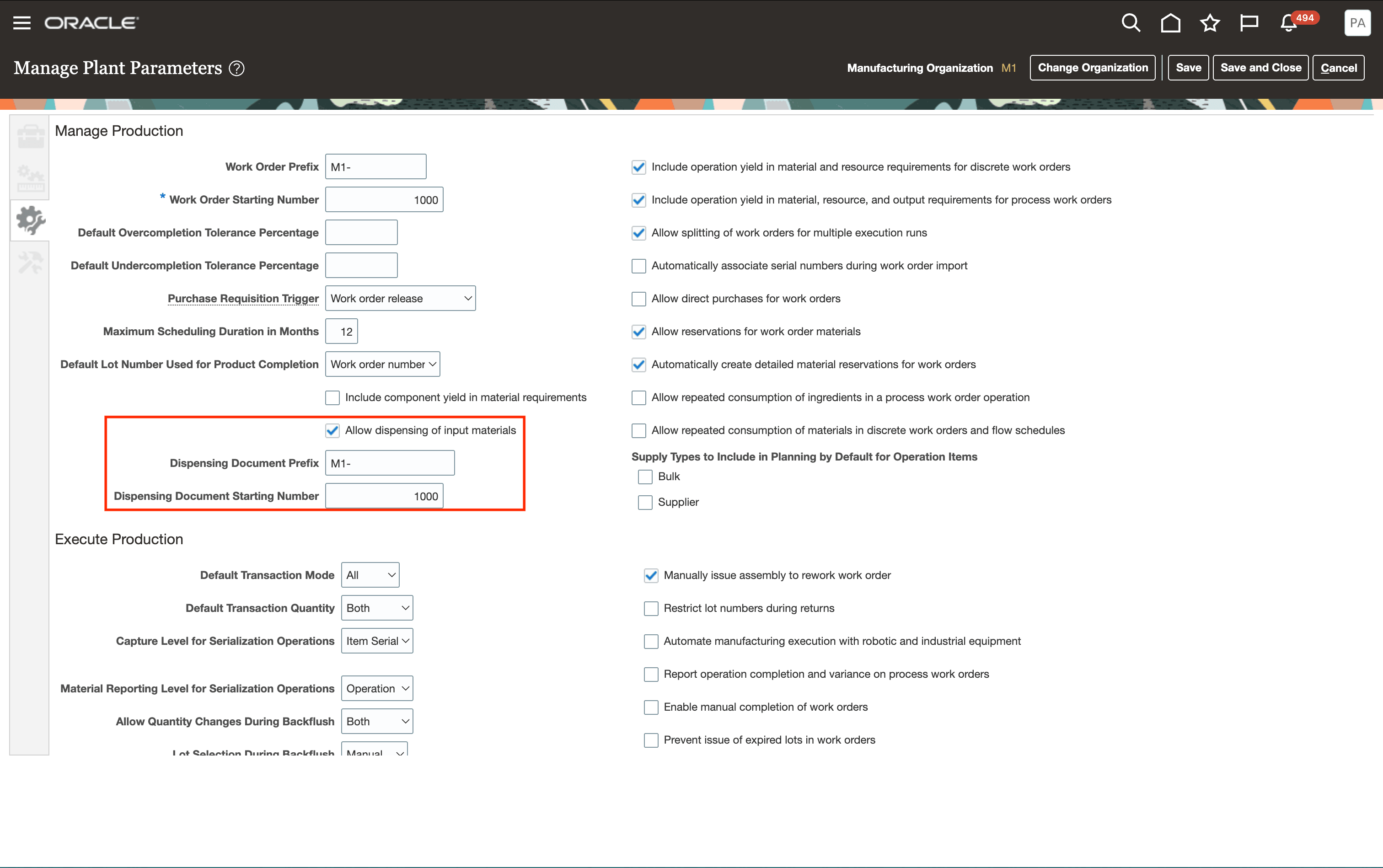

Steps to enable and configure
Set up the plant parameters to enable this feature:
  1. In the Setup and Maintenance work area, search for, and select the Manage Plant Parameters task.
  2. On the Manage Plant Parameters page, select the required inventory organization.
  3. In the Work Execution tab, under Manage Production, enable the Allow dispensing of input materials checkbox.
  4. Once you enable the dispensing option, you can also specify the Prefix and Starting Number for the Dispensing transaction.
Enable dispensing feature from plant parameters page
Enable the Dispensing Feature from the Plant Parameters Page
