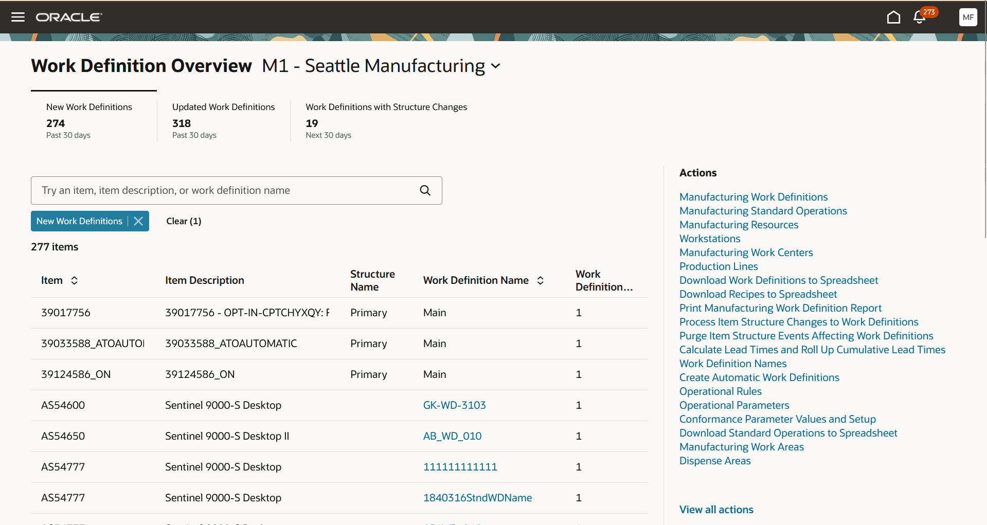

New Work Definitions KPI
KPI: New Work Definitions Created in the Past 30 Days

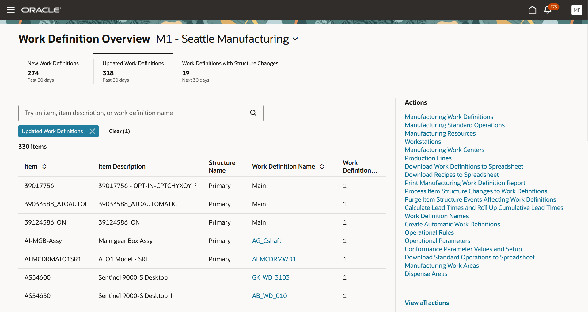

Updated Work Definitions in Past 30 Days KPI
KPI: Work Definitions Updated in the Past 30 Days

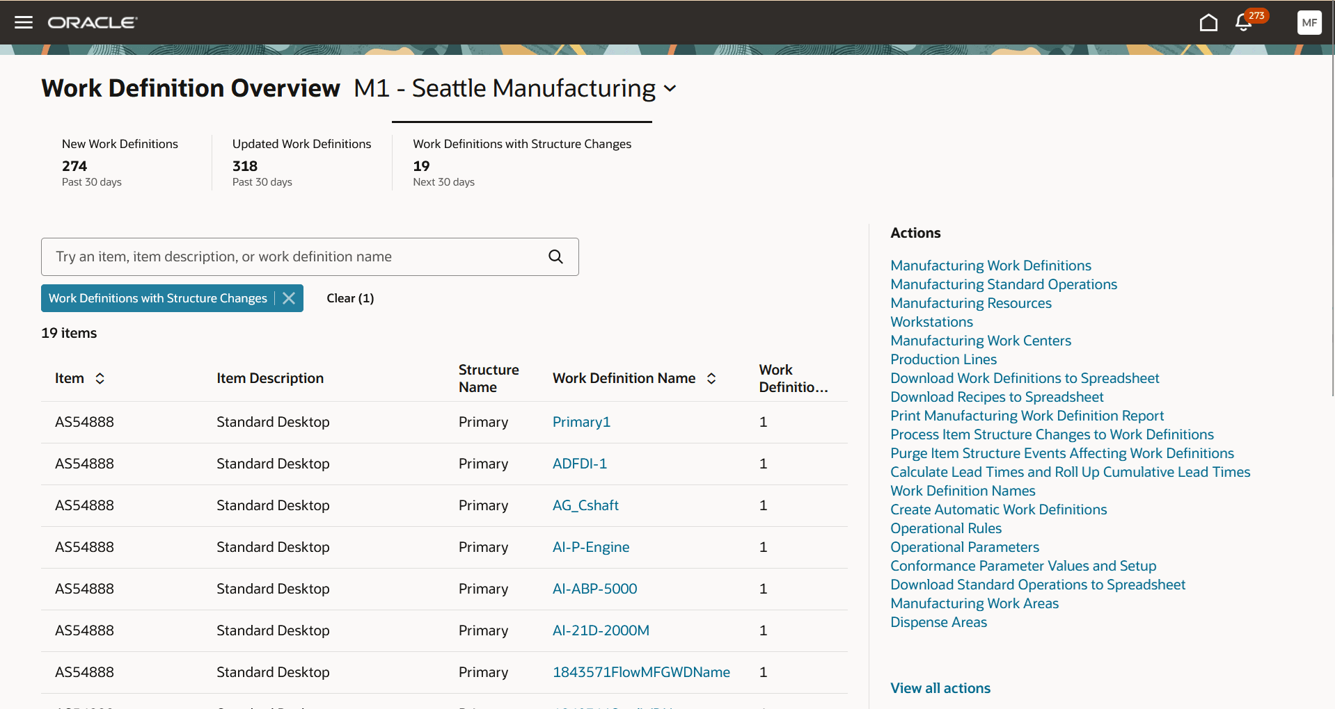

Work Definitions with Structure Changes in Next 30 Days KPI
KPI: Work Definitions with Structure Changes in the Next 30 Days

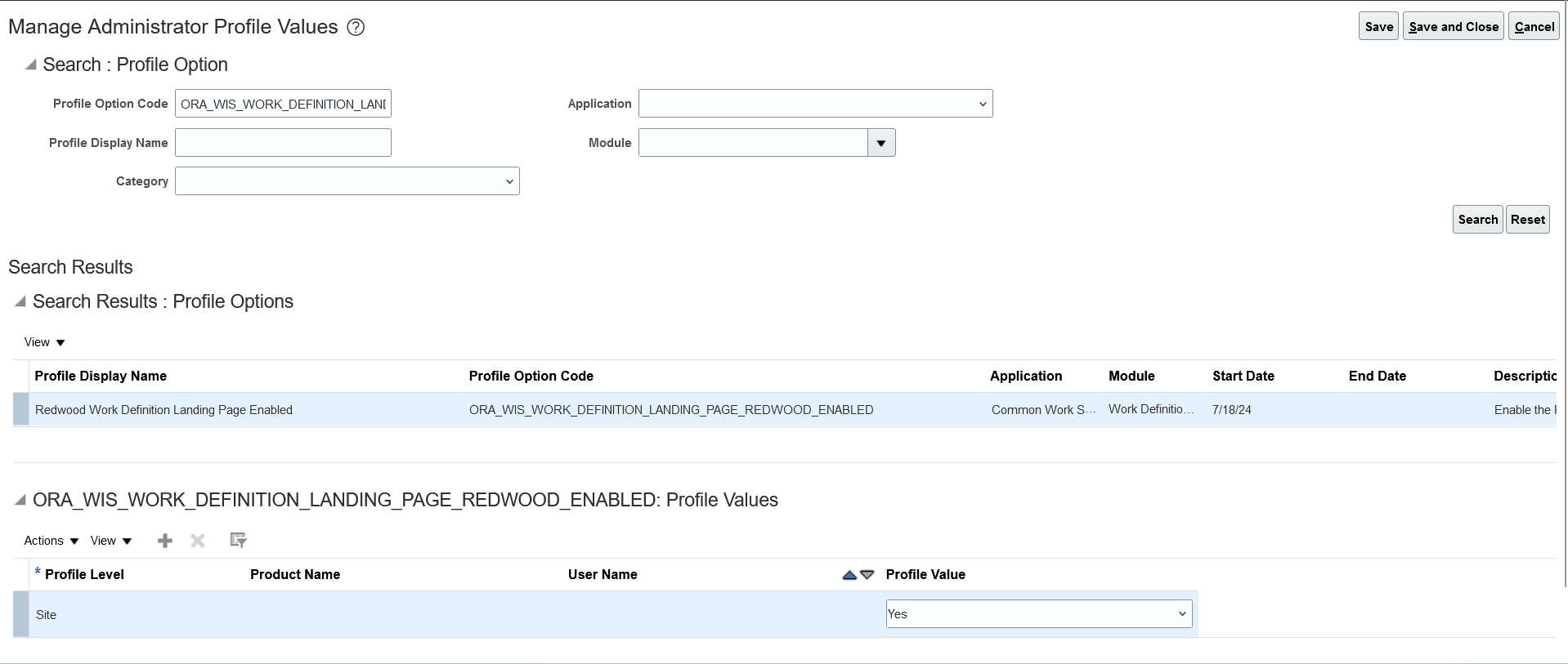

Steps to enable and configure
Use the following steps to enable or disable this feature:
  1. In the Setup and Maintenance work area, search for and select the Manage Administrator Profile Values task.
  1. On the Manage Administrator Profile Values page, search for and select the ORA_WIS_WORK_DEFINITION_LANDING_PAGE_REDWOOD_ENABLED profile option code.
  1. In the Profile Values section, set the Site level to or N. The default value of the profile option is N.
  • Y = enables the feature
  • N = disables the feature
  1. Click Save and Close. Changes in the profile value will affect users the next time they sign in.
Profile Option to Enable the Work Definition Landing Page in Redwood User Experience
Profile Option to Enable the Work Definition Landing Page with the Redwood User Experience
