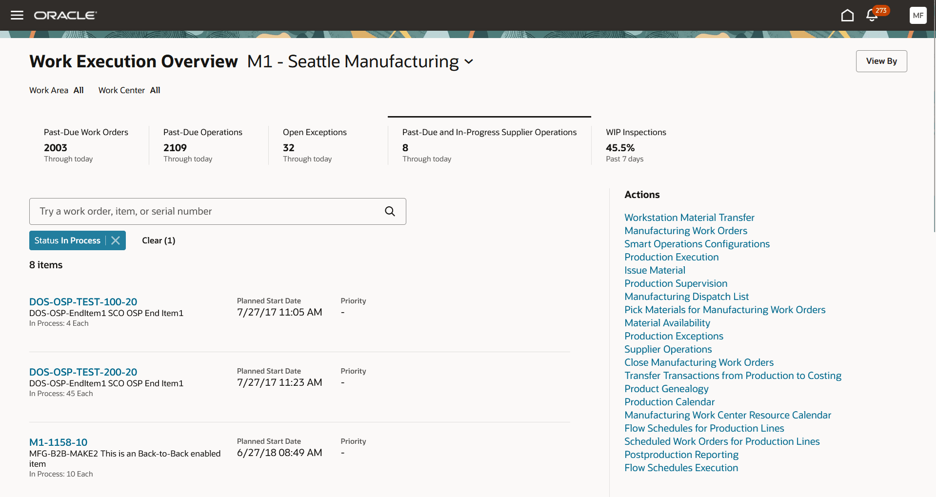

Currently, the list of work execution objects on the Work Execution Overview page is static. It displays past due work orders that are expedited. With this update, the list of work execution objects displayed is determined by the selected KPI. The following KPIs are available on the Work Execution Overview page:
  • Past-Due Work Orders - Through today.
  • Past-Due Operations - Through today.
  • Open Exceptions - Through today.
  • Past-Due and In-Progress Supplier Operations - Through today.
  • WIP Inspections - Past 7 days.

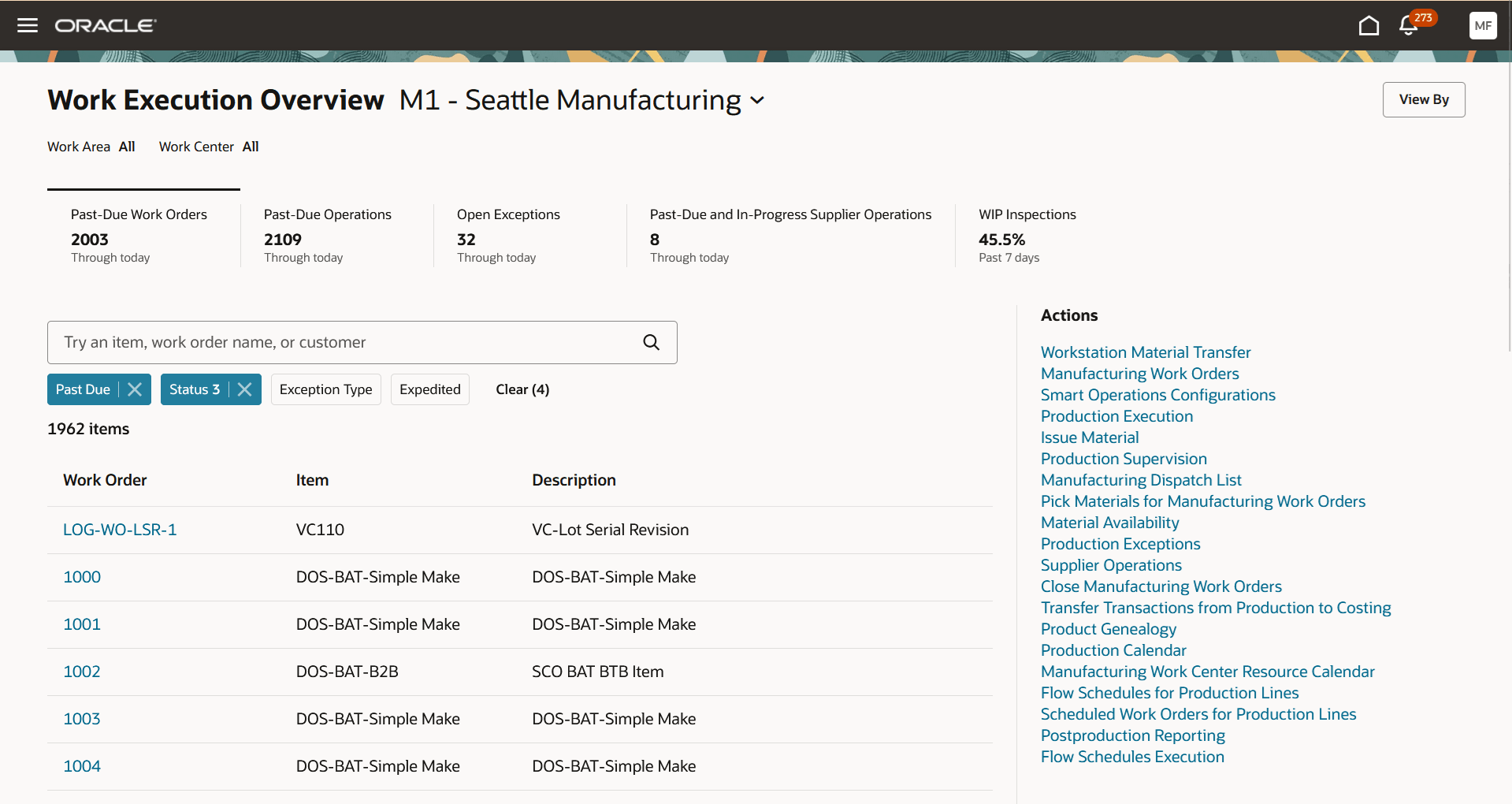

Past-Due Work Orders Through Today KPI

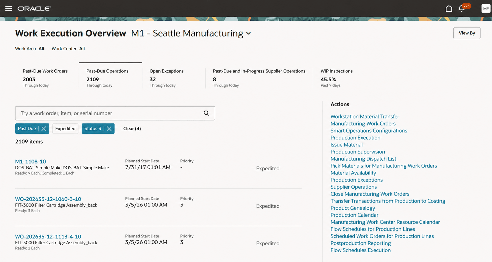

Past-Due Operations Through Today

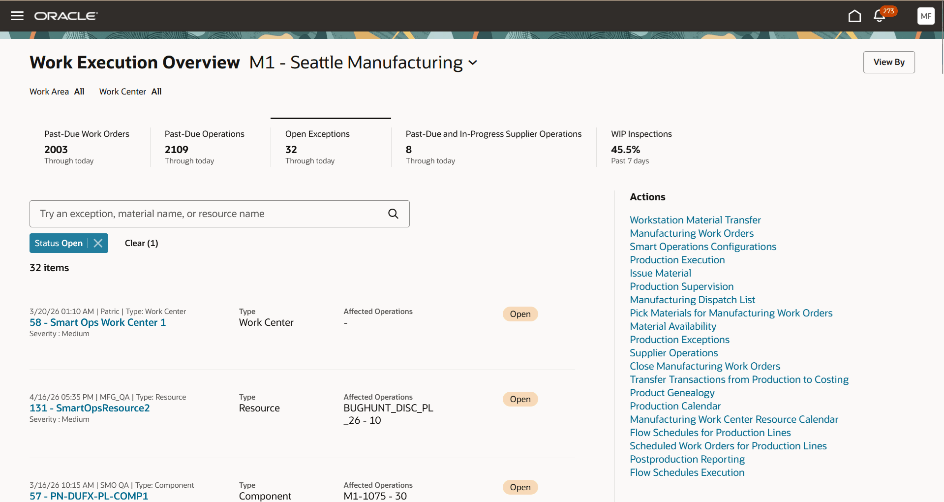

Open Exceptions Through Today
Past-Due and In-Progress Supplier Operations Through Today KPI

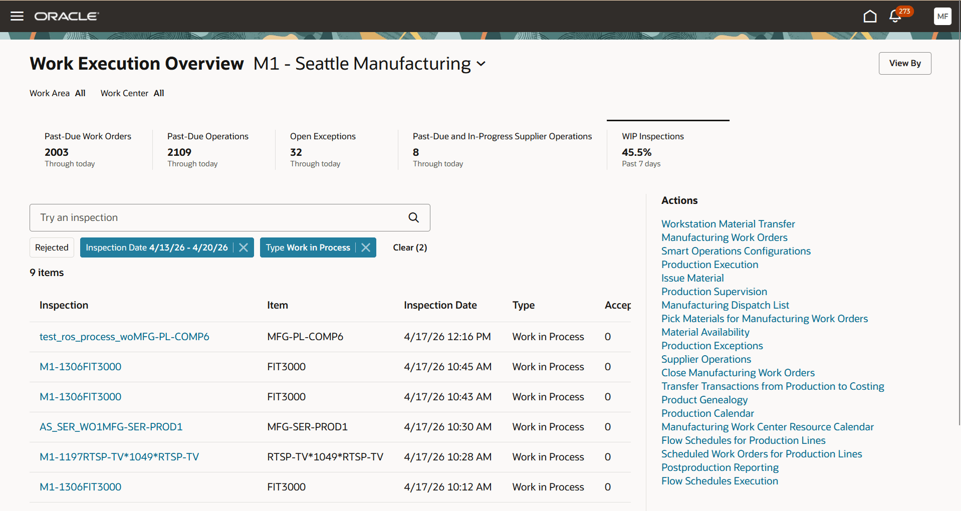

WIP Inspections Through Today KPI

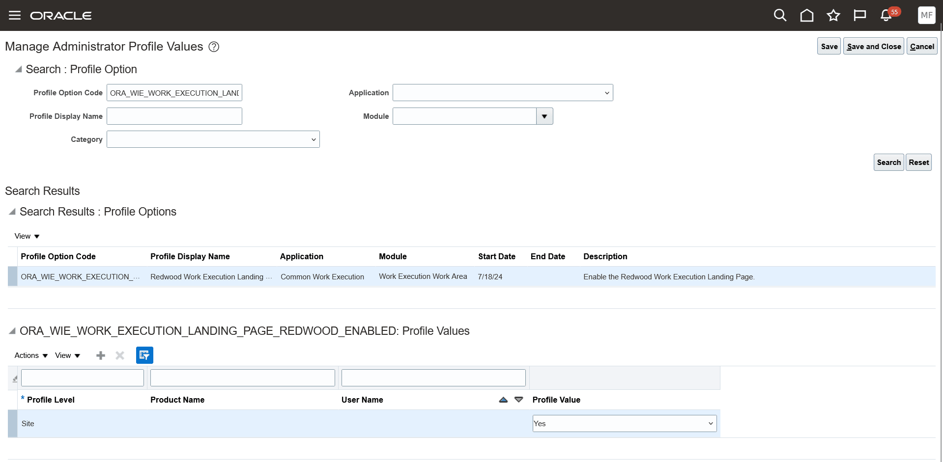

Steps to enable and configure
Follow these steps to enable or disable this feature:
  1. In the Setup and Maintenance work area, search for and select the Manage Administrator Profile Values task.
  1. On the Manage Administrator Profile Values page, search for and select the ORA_WIS_WORK_EXECUTION_LANDING_PAGE_REDWOOD_ENABLED profile option code.
  1. In the Profile Values section, set the Site level to Y or N. The default value of the profile option is N.
  • Y = enables the feature
  • N = disables the feature
  1. Click Save and Close. Changes in the profile value will affect users the next time they sign in.
Profile Option to Enable the Work Definition Landing Page in Redwood User Experience
Profile Option to Enable the Work Execution Landing Page in Redwood User Experience

  • The count in the Past-Due Work Orders KPI may be different from the count in the search results table. To reflect the latest work order data in the search results table, you need to run the following scheduled process:
    • Program name: ESS job to create index definition and perform initial ingest to OSCS
    • Index Name to Reingest: fa-scm-mfg-work-order
