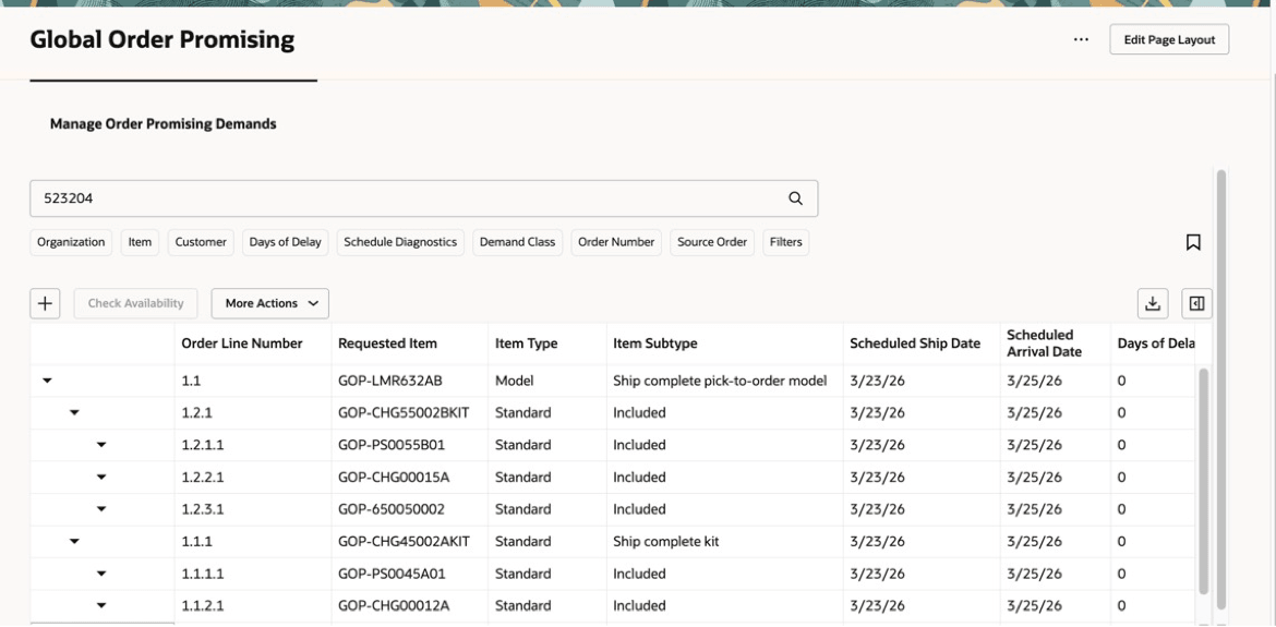

The Redwood Check Availability page and the Manage Order Promising Demands (MOPD) page have also been enhanced to display the hierarchical structure of such orders.
Manage Order Promising Demands Page With PTO Kit Within a PTO Model
