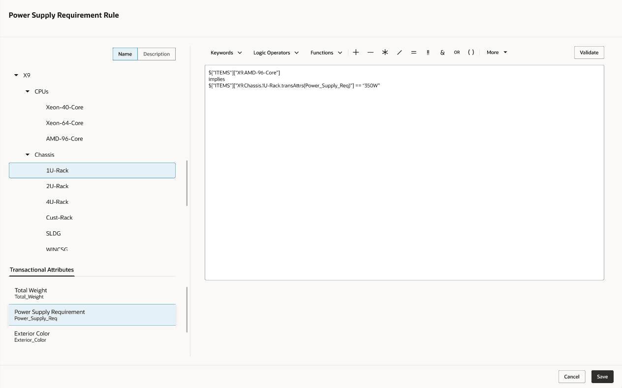

  4. Reference a Transactional Attribute in the Configurator Rule
    In the rule condition, select the transactional attribute as the operand by dragging and dropping it into the rule text area. The attribute will be resolved at runtime using the current transactional context. Specify the selection, exclusion, or constraint that the rule should enforce when the condition is met.

The following screenshot shows a configurator rule referencing a transactional item attribute in the rule condition.
Transactional Attribute Referenced in a Configurator Formula Rule
