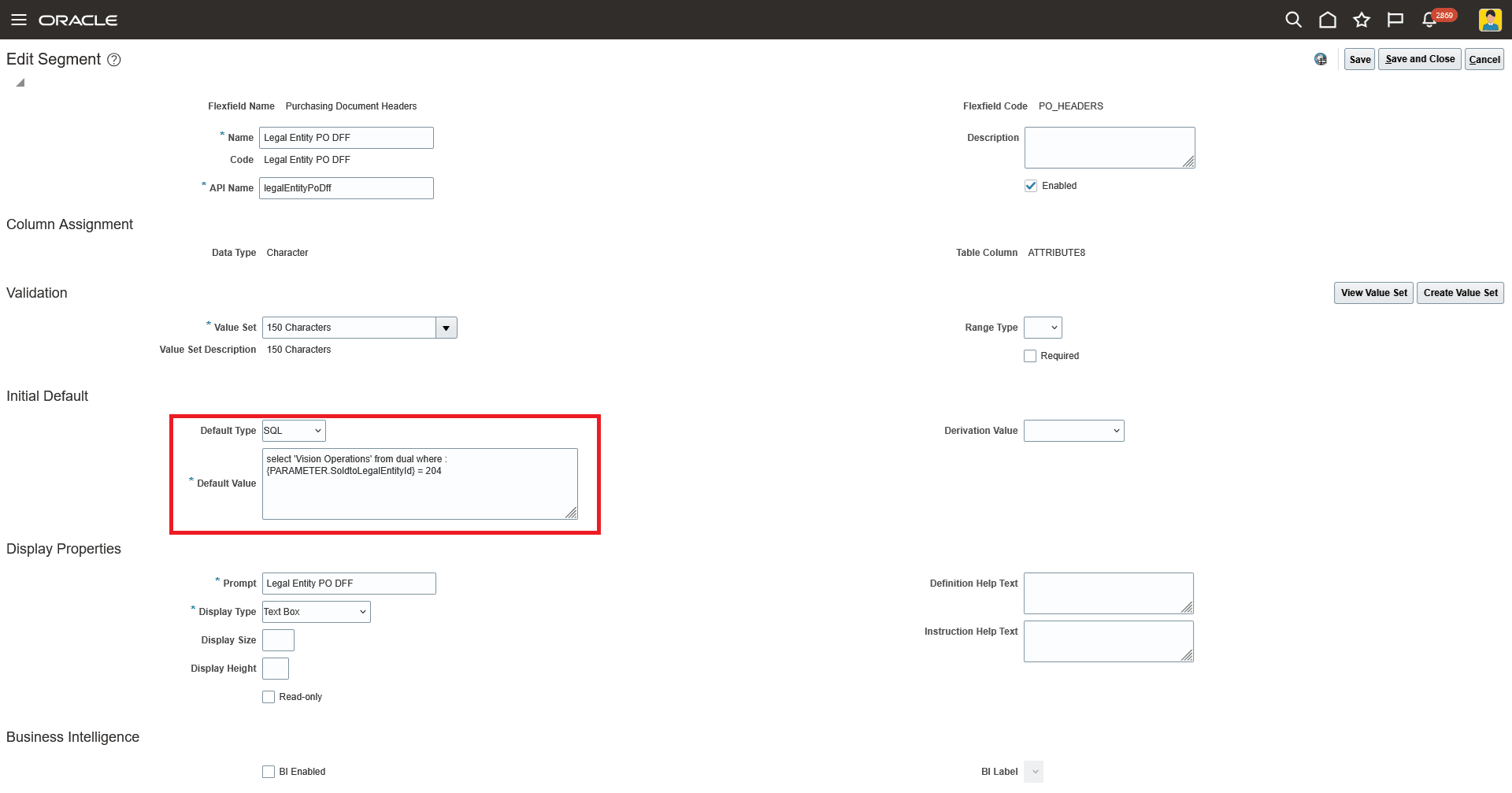

Purchase Order Header Descriptive Flexfield Setup Using SoldtoLegalEntityId as the Reference Parameter

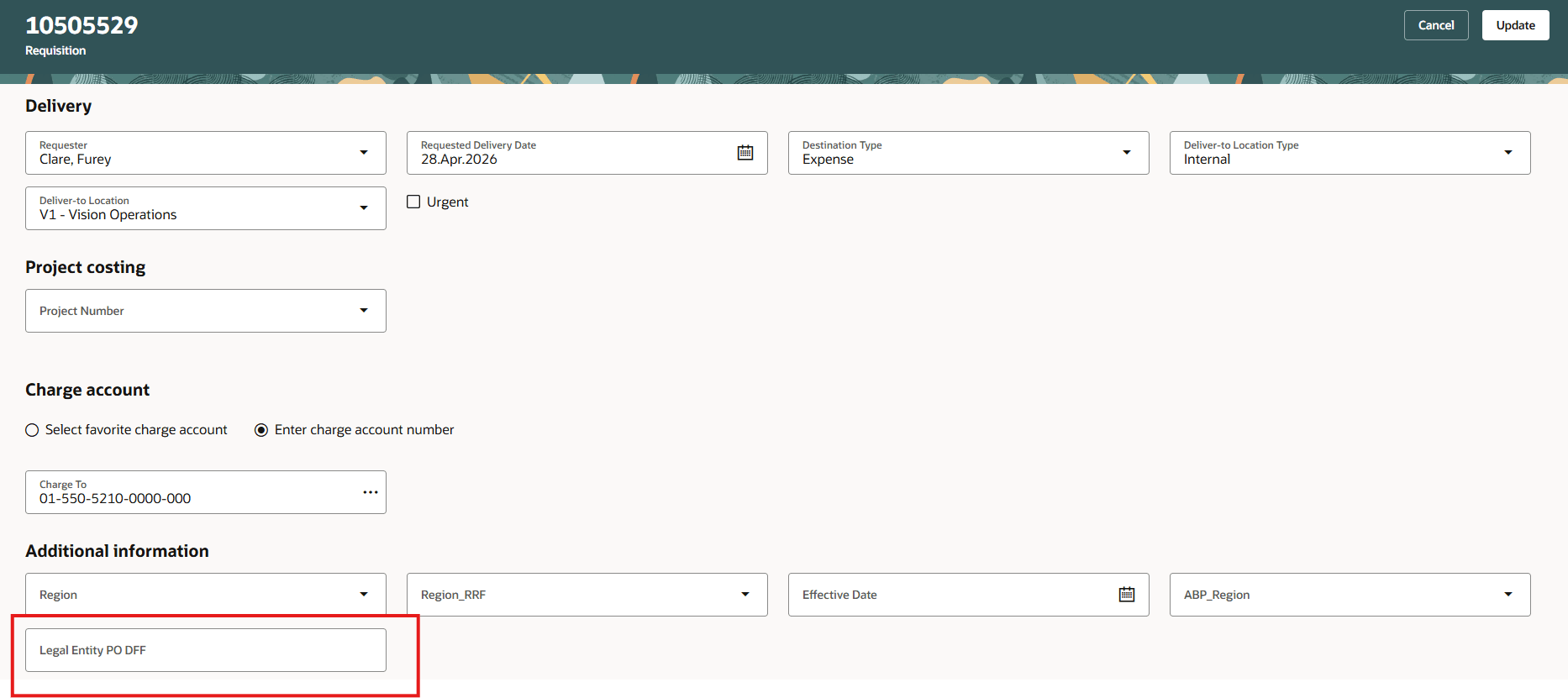

Requisition with No Header Descriptive Flexfield Value.
Requisition with Empty Header Descriptive Flexfield

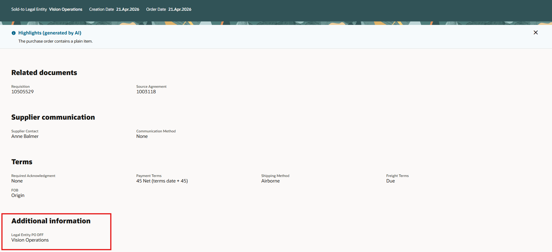

Purchase Order Header Descriptive Flexfield Showing a Default Value Based on SoldtoLegalEntityId
Purchase Order Header Descriptive Flexfield  Is Defaulted Based on SoldtoLegalEntityId

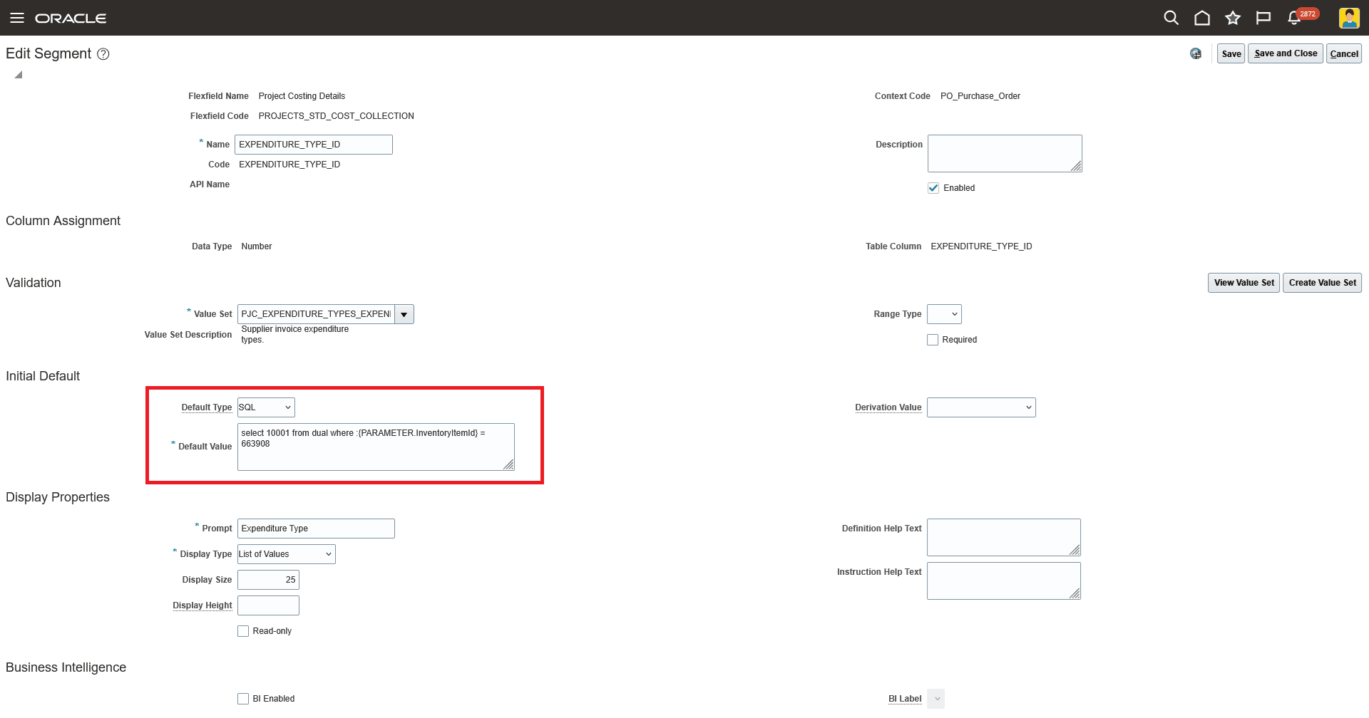

Project Descriptive flexfield Setup Using InventoryItemId as the Reference Parameter
Project Descriptive Flexfield Setup Using InventoryItemId as the Reference Parameter

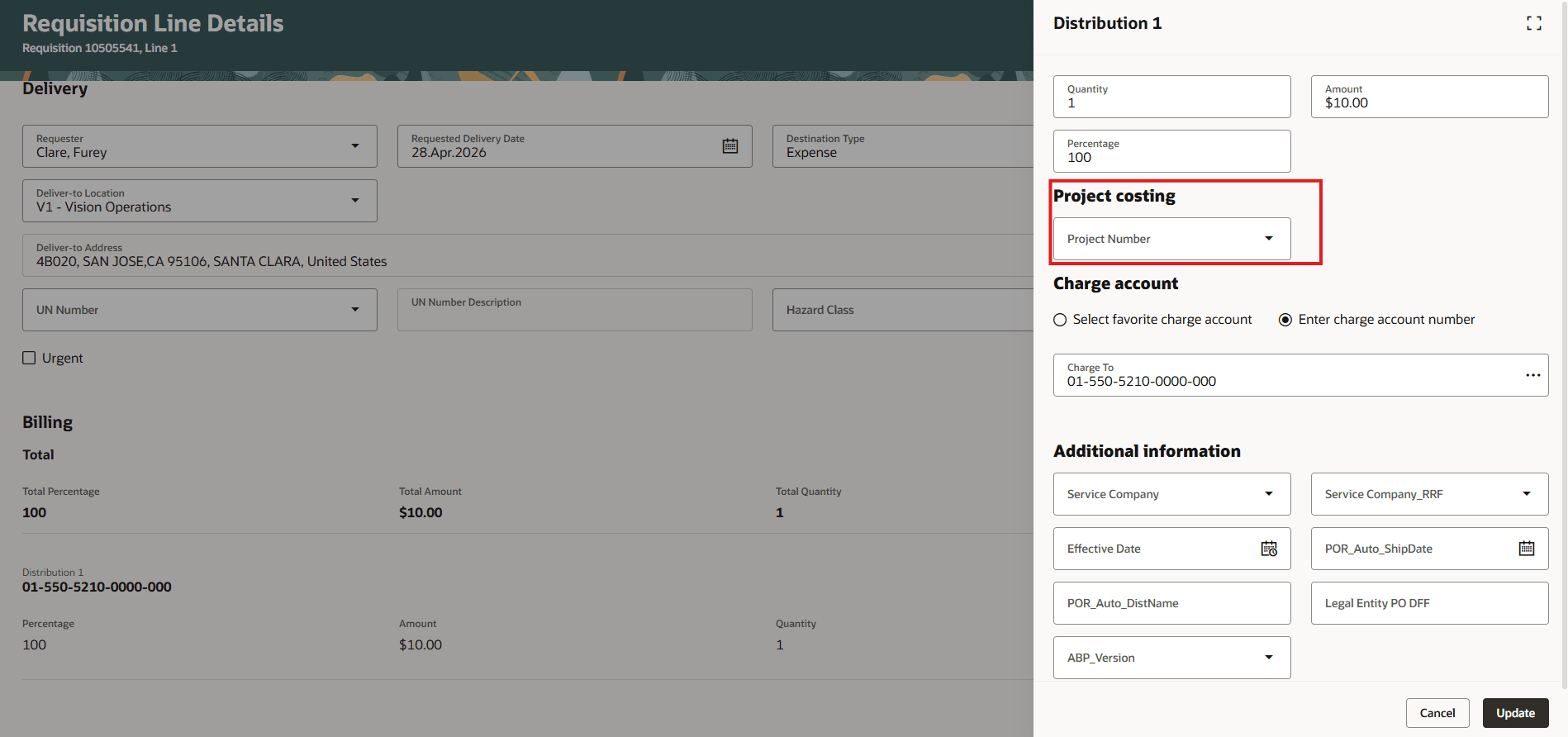

Requisition with No Project Descriptive Flexfield Value

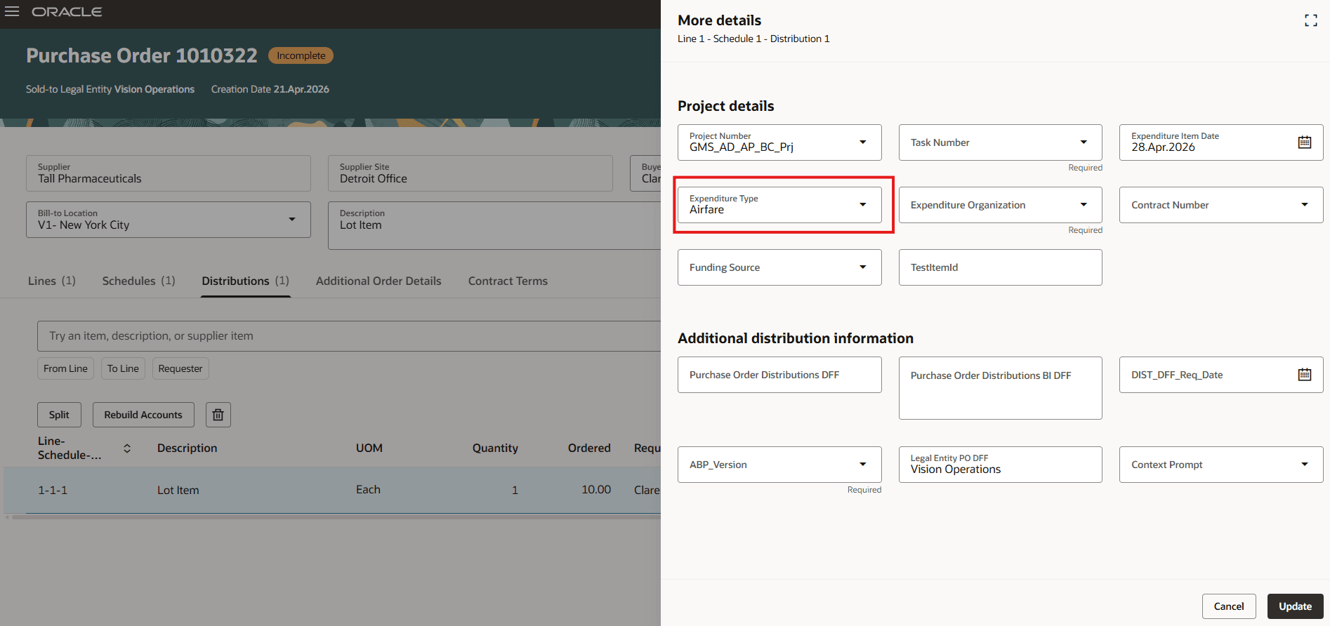

Purchase Order Project Descriptive Flexfield Showing a Default Value Based on InventoryItemId
